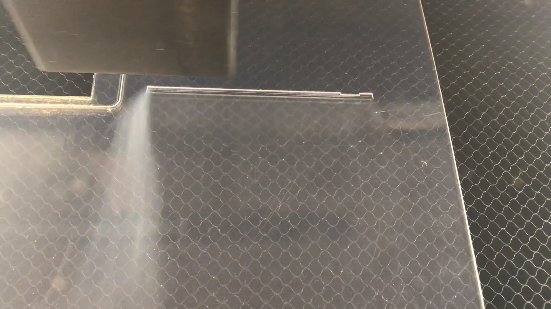

Now the primary problem is man does this stuff smoke (this stuff does have a backing sheet but no top masking). see this video.
Any squirrels in my back yard not wearing a SCBA are all now dead… The plume of nasty smelly smoke was impressive. And they aren’t kidding to immediately take it and wash it after cutting with soap and water. The oily gunk was nasty.
