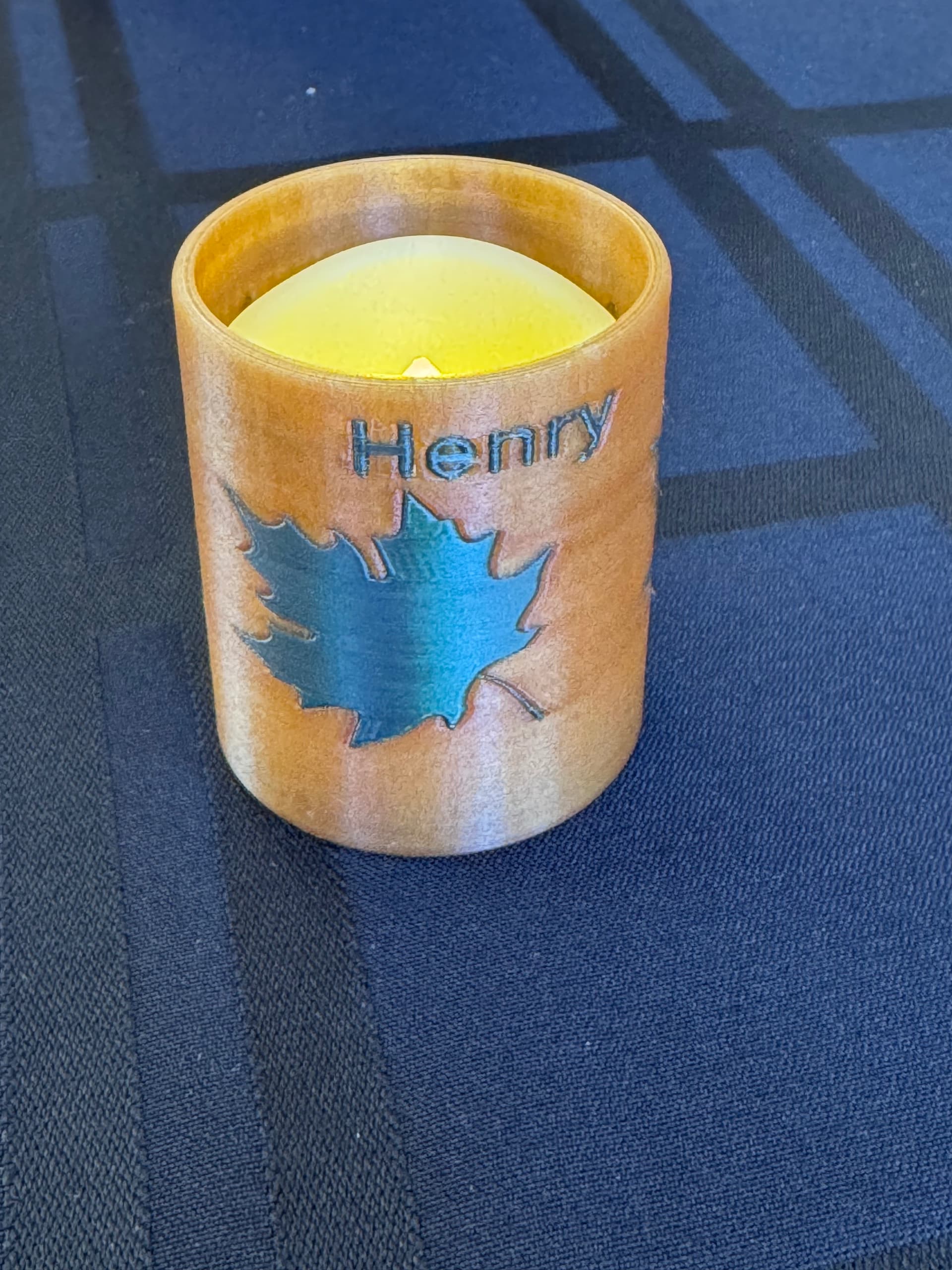

Like every year for the last decade it was time for the annual thanksgiving dinner place card project. I had wanted to learn “configurations” in CAD anyway and learn Fusion’s project sketch to surface. I decided on personalized votive holders with LED candles. There are 30 of these I made on the prusa XL. To keep the theme the materials are corn colored and the green is some natural plant dye all from Prusa’s Eco line.
So it’s one design and 32 configurations after importing a text file of names into the configuration (you can get super fancy with python to pull from a database or something) the project to surface lets those maple leaves go through the cylinder normal to both surfaces. I’ve now used it for other projects and it’s super useful. Both OnShape and Fusion have the configuration while only fusion has the project to surface.

Interesting tool. What’s the print time on one?
I crossed out the bizarrely wild number of 27 m^3 of filament (way more than is in my house), Especially in light of the 34 g of filament used (not even aerogel is that low density). But 222 flawless tool changes (unlike a Bambu it doesn’t use the same nozzle so no purging, it switches entire extruders) which lets the printer do funky things such as different nozzle diameter and wildly different temperatures, like when I print PLA and TPE together). I have ultra hardened nozzles on the first 3 extruders and normal brass on the last 2 (depending on what I am printing)
