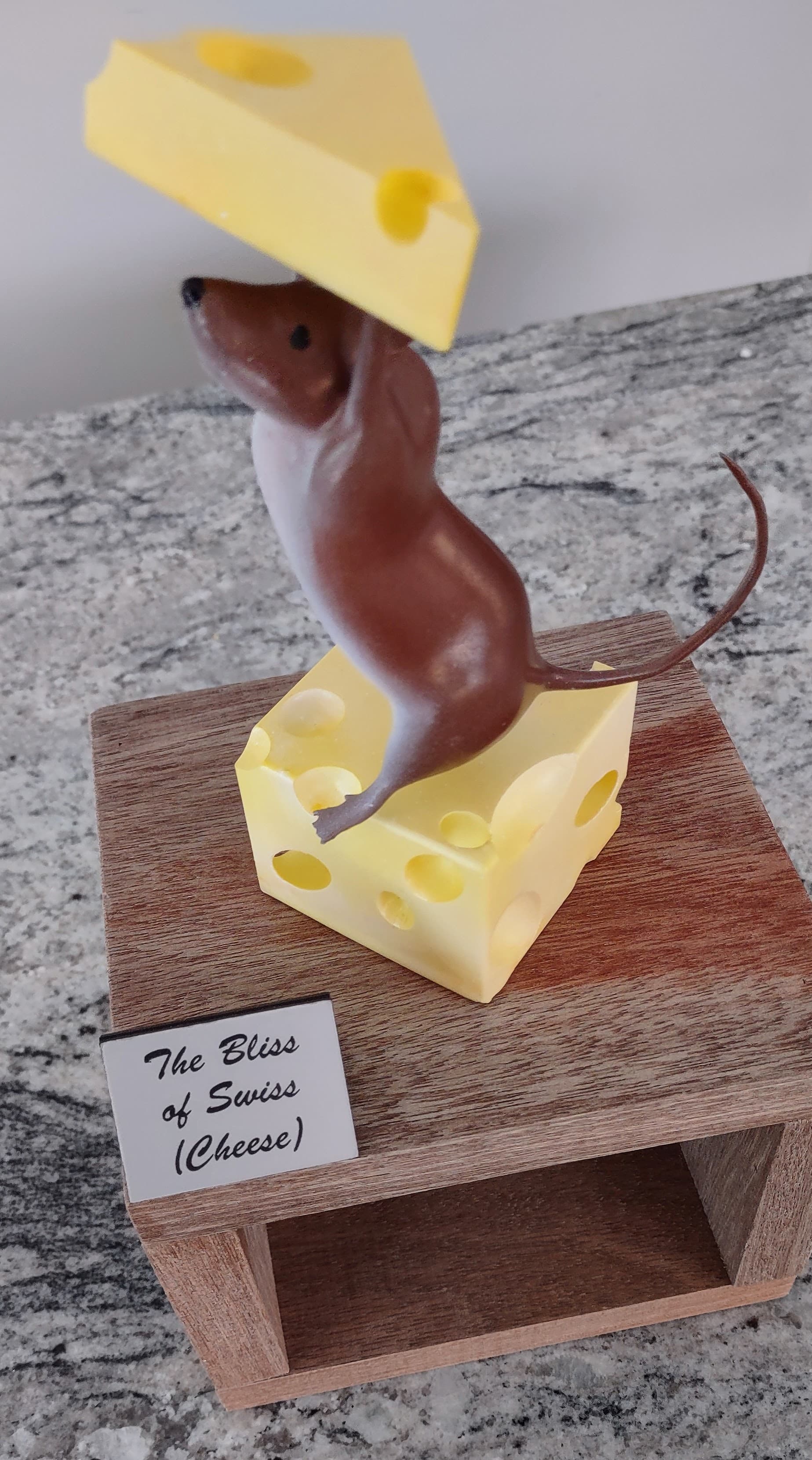

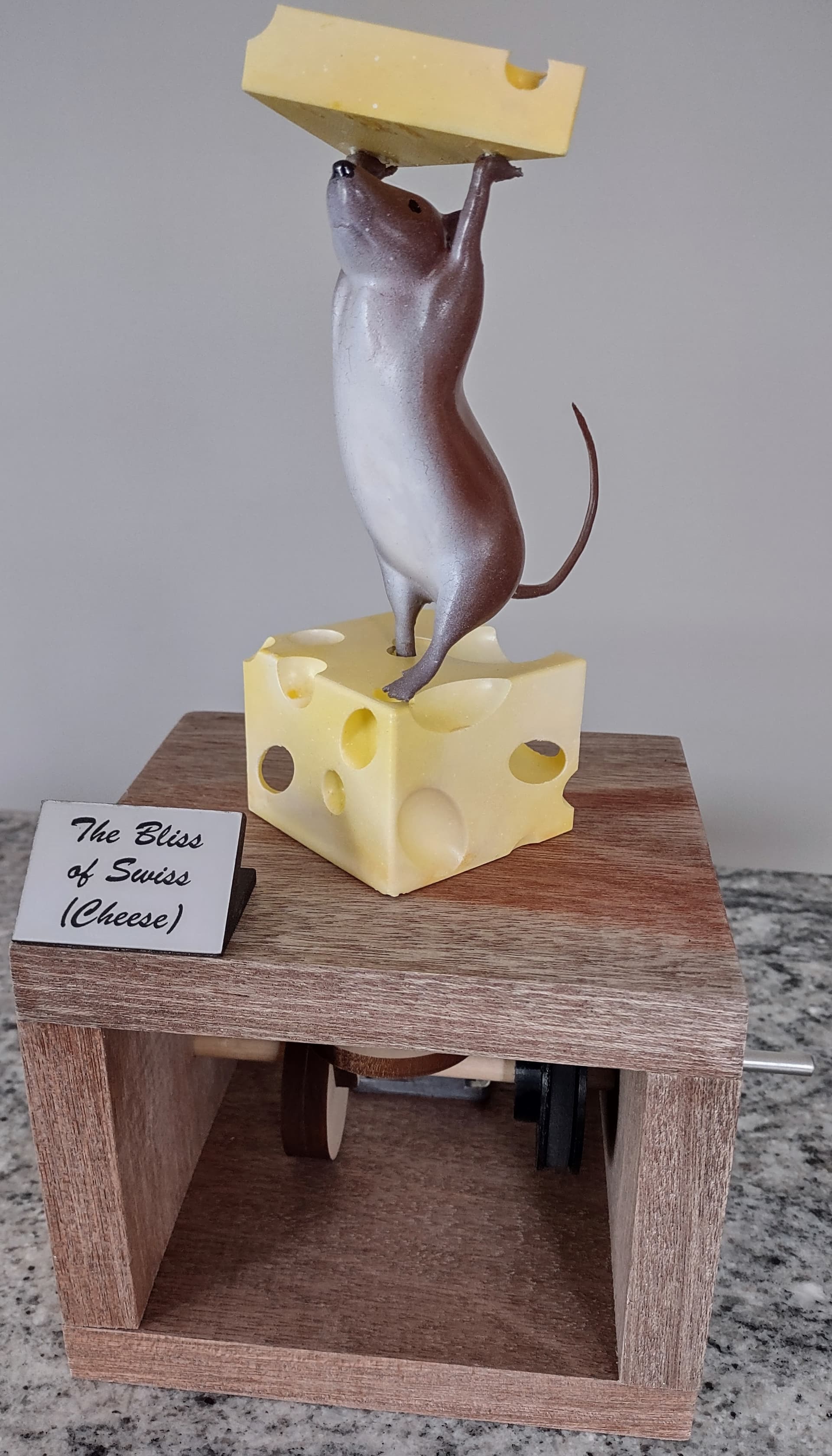

As in many of my projects, the Glowforge is an important tool but not an exclusive one. I created a mouse that is celebrating one of my favorite foods - Swiss cheese.

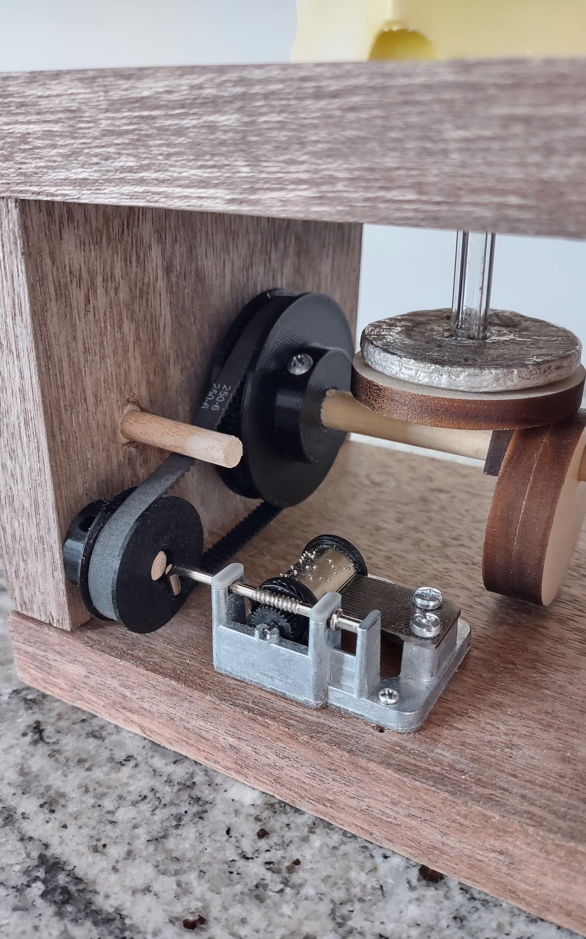

The cams and all-important templates that define the position of the axles, belt tensioner and other elements were done with the laser.
The mouse and cheese are 3D printed and then carefully smoothed with an epoxy topcoat and painted with an airbrush.

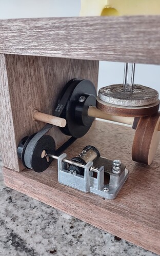

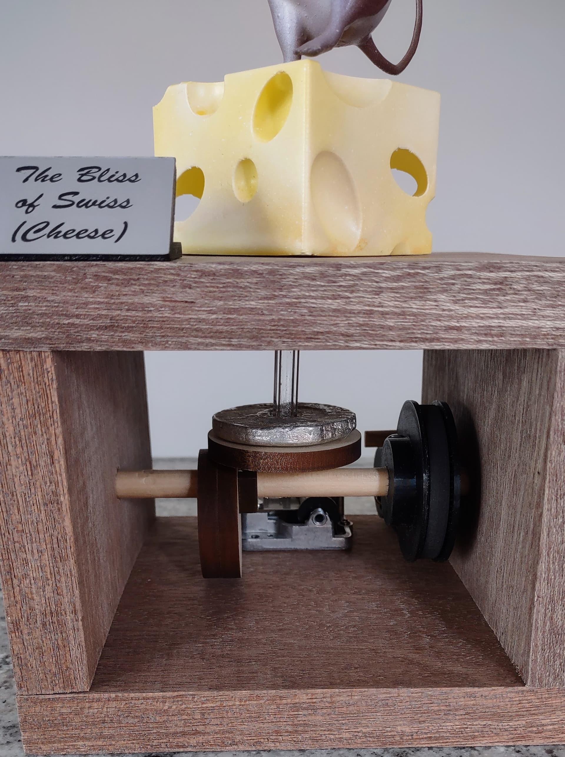

Used my CNC to carve a shallow mold that I cast a pewter weight from. This helps the riser supporting the mouse to maintain contact with the cam.
I originally had a series of gears driving the motion, but I found the noise distracting and switched to pulleys and timing belts. They drive both the motion of the mouse and rotate the handle on the music box mounted at the rear.
The box is mahogany with a light polyurethane finish. Dimensions are 6" wide x 6" deep x 12" tall.

The switch to belt drive was spot on. Nylon or Delrin gearing cut on the GF might have provided similar sound levels but the belts give it a little retro vibe that feels perfect for it.

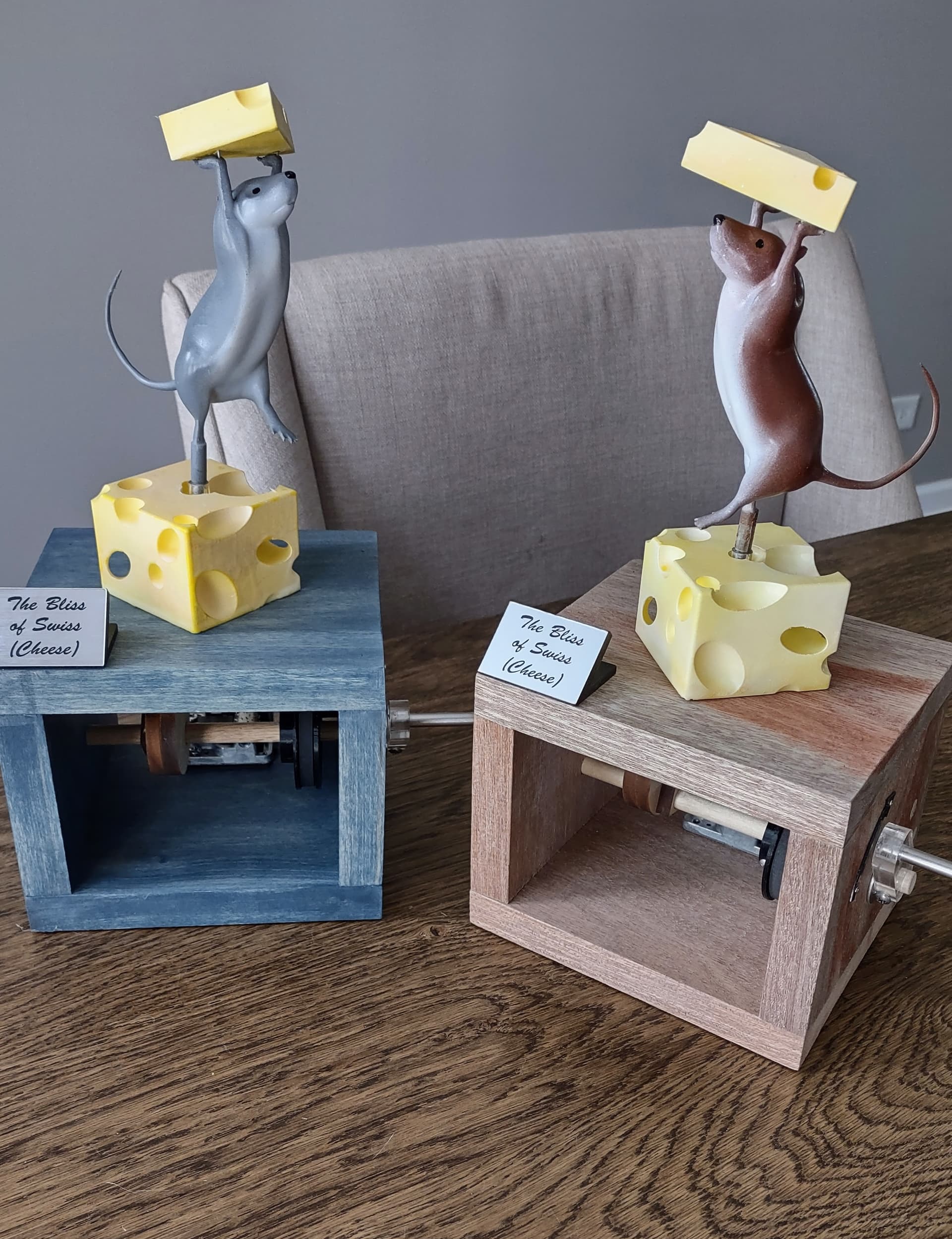

Just finished a second one that will be a gift to my niece. This time the mouse is gray and the music is Fur Elise.
