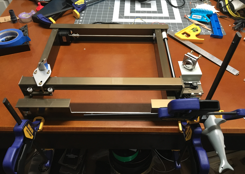

After realizing I had to take apart the bed to get it level, I just removed it and the rest of the rails and mirrors from the casing, disconnected the power and ribbon cables, and put the casing on the floor.

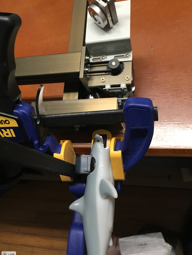

I then clamped the rails down on my workbench to see if I could get things back in line. I had to slip the belt off one side as @jamesdhatch recommended to get the sides of the gantry even. Easy enough.
This also gave me a chance to make sure that the mirrors were aligned properly in every corner by using my shark with a frickin laser beam attached to his head. I didnt have to keep switching out tape or worry about getting burned. This made things a lot easier
After that, its was just a matter of installing the carriage assembly back into the box, making sure it was square with the walls, reconnecting the cables, and doing final alignment with the mirrors.

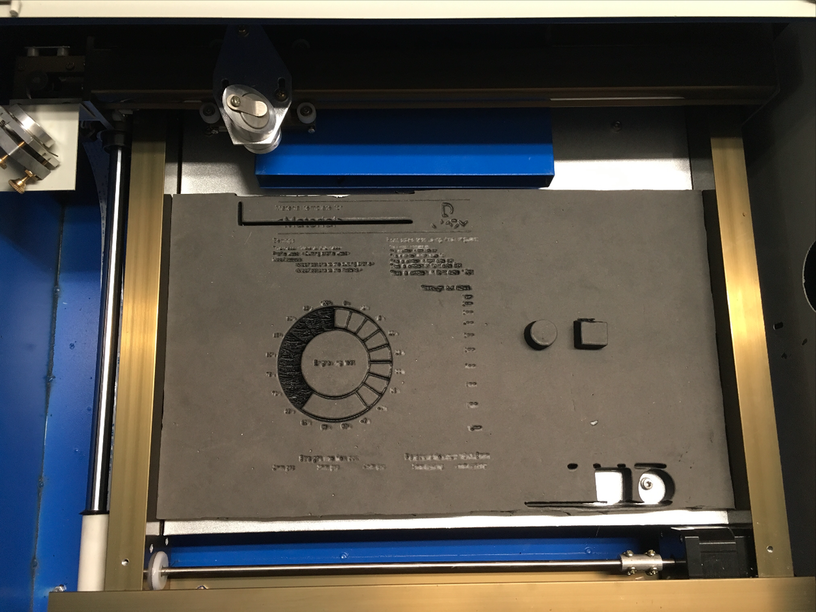

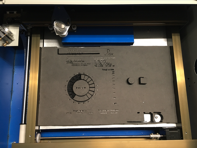

Finally success! its pretty damn close to spot on in every corner so im not gonna argue with it. Time for a test cut! I made a very small engraving first by accident, so I decided to see how one of the calibration images would do, so I grabbed a small piece of EVA to start with
Everything seems to be working so far to a degree. Its not really hitting the greyscale yet… as you can see by the wheel which is supposed to slowly ramp up the engraving depth. It just kinda went 0 to 100 in one step.
So thats it for tonight. Made some good progress. Everything seems to be in working order. Now I can start diving in to the more complicated things like power levels, calibration cuts, and different materials etc. Til next time

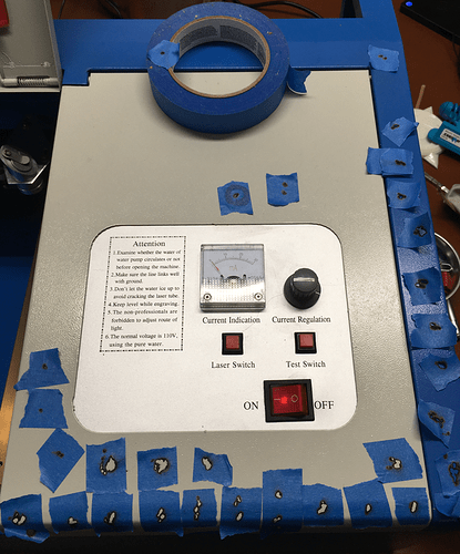

Another thing I will probably do early on is redo that control panel. I’d like to upgrade the switches, and put a Min/Max scale on the knob. One of the very first things I did was pull out my labeler.
