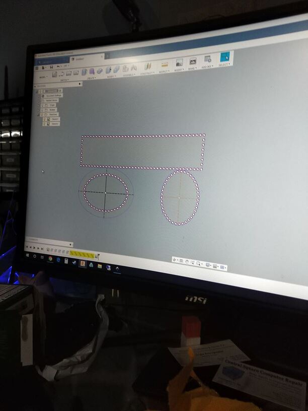

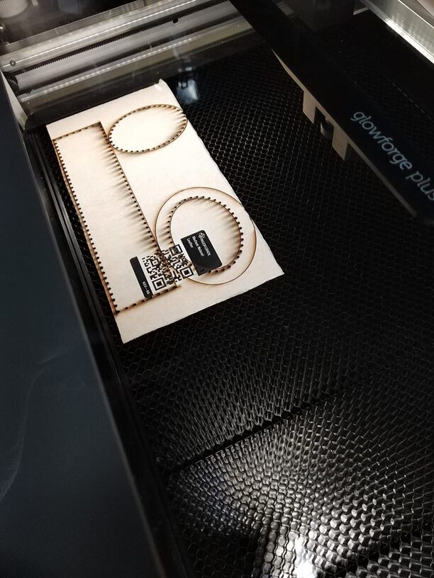

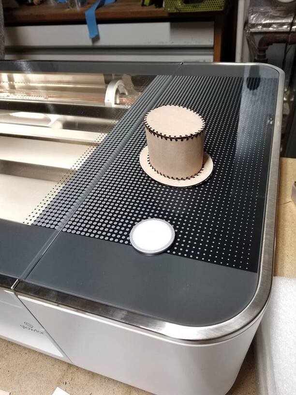

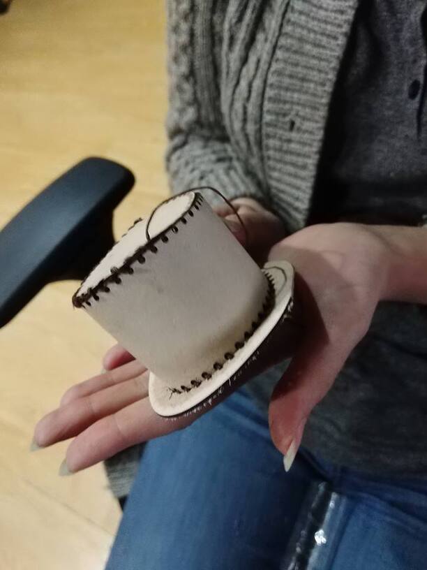

My girlfriend made this little hat on the glowforge, first attempt with starter supplies… she did it rather fast so the cuts could have been better but we have had it less than a day! Having a blast…
I ended up making a few finger joint boxes designed to snap together without glue, took me a few tries but I settled on 0.45mm offset [0.225 each side of the negative snap space] and it was perfect!!
First day a success!
