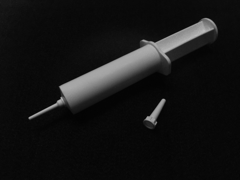

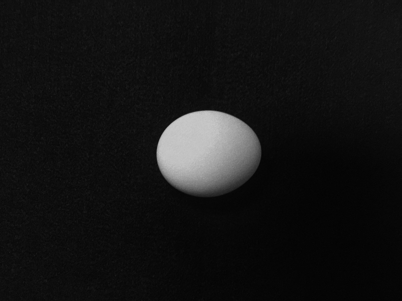

Neighbor came by with another get-rich-quick idea, and I got nothing done today…so I decided to fiddle a little with trying to get a gradient on a photo because this was so interesting…
Is this the kind of thing we’re shooting for in depth mapping? The first is a photo of an egg sitting on a black piece of felt. (It was the only thing I had on hand that was matte white without pulling out the paint.)
If it is workable, I’ll tell you how I shot it…if not, well I hate to look like an idiot, so I’ll just go quietly back to doing what I was doing…chuckle!
Second is a white glue syringe - had to clean up a couple of highlights on that one, and should have shot it from above, but the cap looks like it might work…just wanting to see if this is in the ballpark.
Very nice gradient in both shots…
Squeeeeeee! :grinning: I’m gonna share how I shot it then because it might have worked after all.
You know those old cardboard 3D viewer glasses that they used to pass out at movie theaters before the advent of the $100 jobbies? I took one of those and held the blue cellophane side over the lens of the iPhone while I shot the picture. It knocked down the pure white and emphasized the shadows.
Opened those in Photoshop and clicked Image > Adjustments > Gradient Map, and chose the Black to White Gradient.
That was it. (Oh, i did have to remove the visible highlight streak in the syringe, but it’s shiny plastic, not matte.)
I did experiment with shooting the egg without the blue filter as well…didn’t get much of a gradient on it at all, so the blue really helped.
Never would have thought to try that though without the blue liquid discussion above. That was pure genius!
