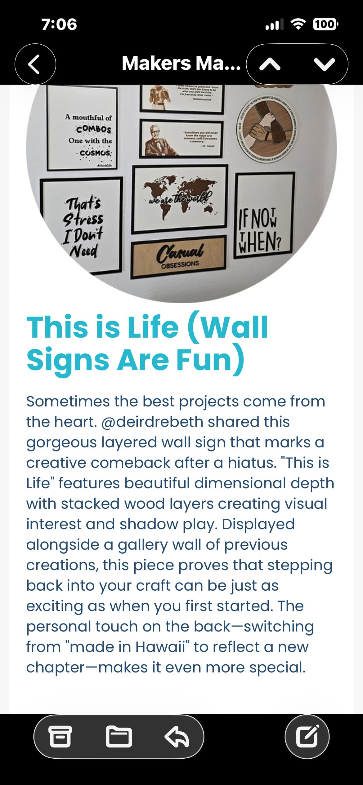

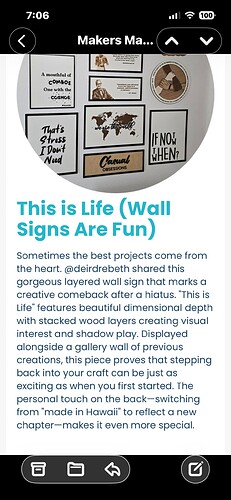

@raymondking32 you made the newsletter, kinda. :slight_smile:
@deirdrebeth did too!
I’m seeing a creative come back!
That’s hilarious because that’s not my wall…I wonder if I reposted somebody else’s in a different conversation…
Nope, I can’t find anything of mine that links to any of those words. Sorry @raymondking32 for seemingly getting credit for your beautiful layered signs!
Wait, if I just searched for “layered” I found this one :slight_smile:
