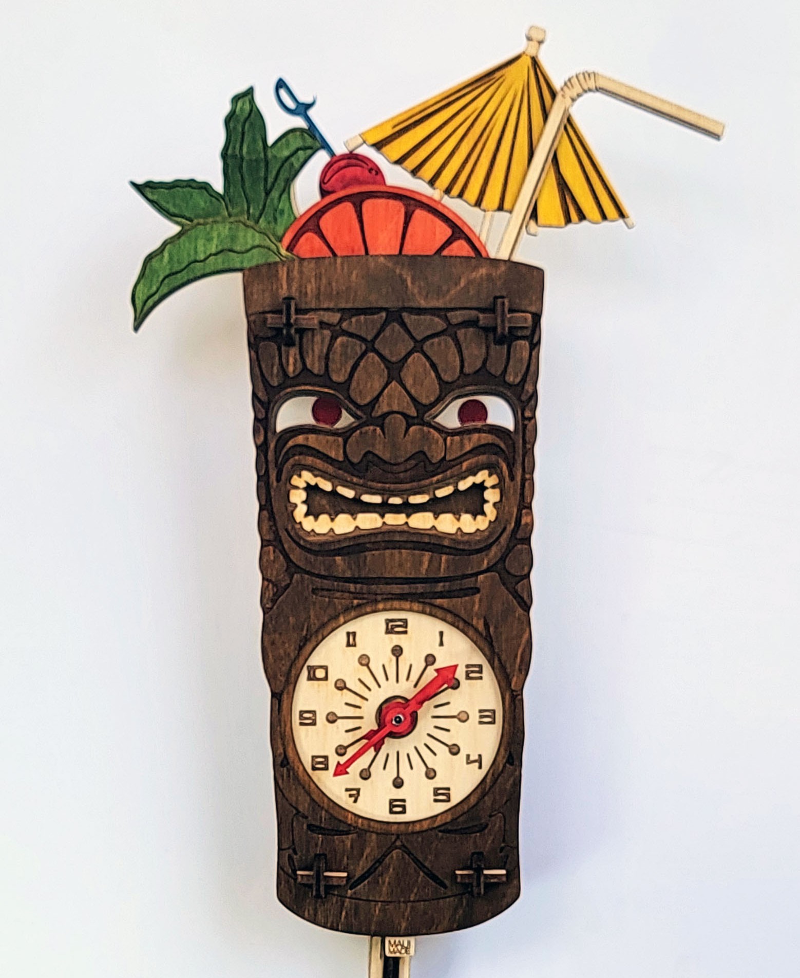

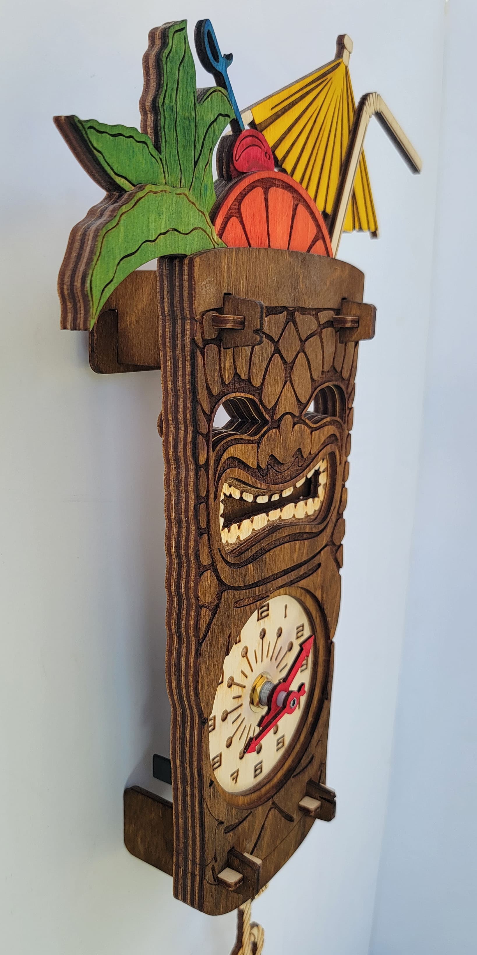

Tiki Mug Clock
My daughter and I did another collaboration.
@TheLuckyHolland
@HaleKoo

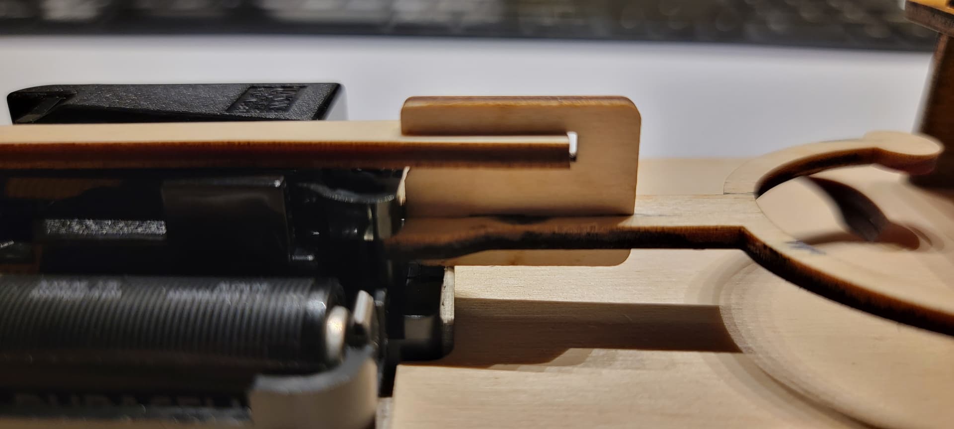

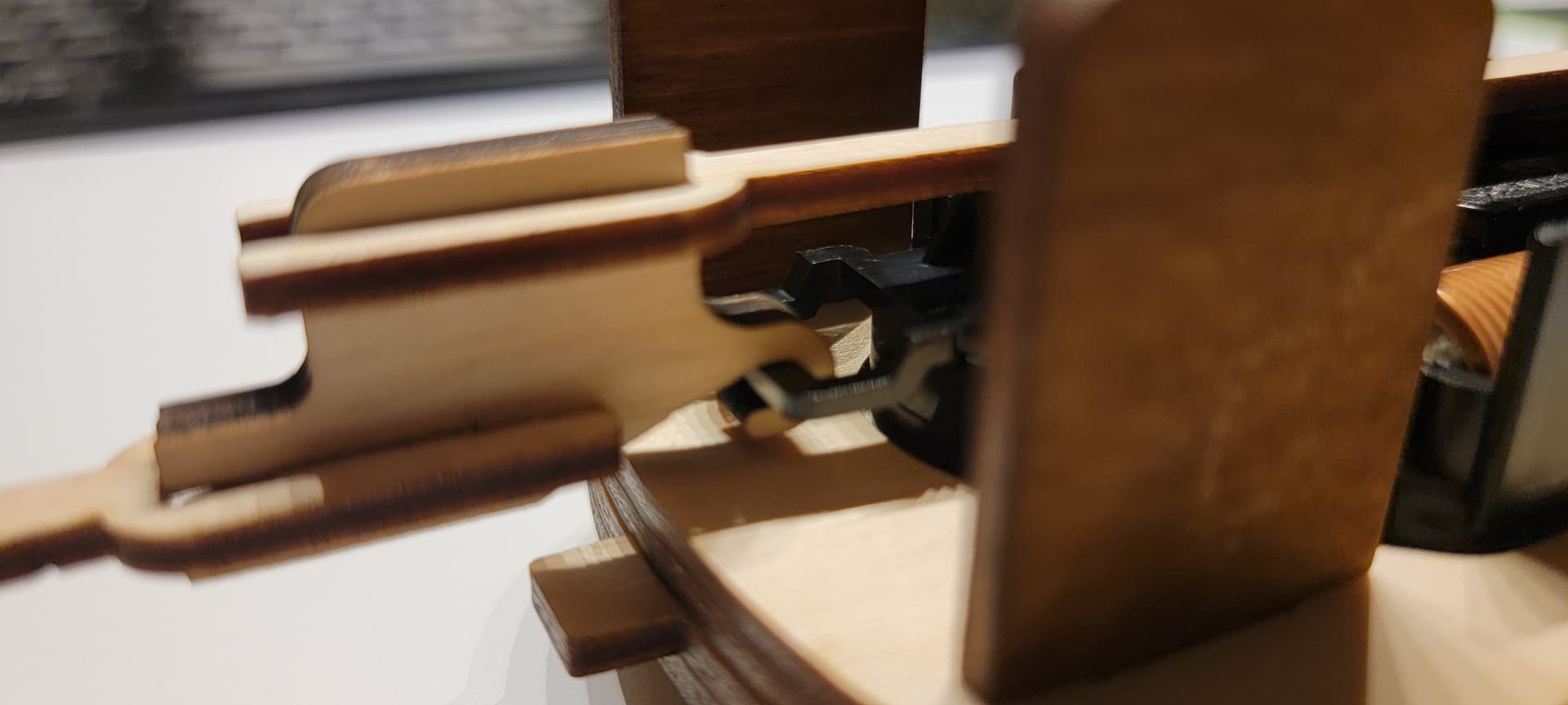

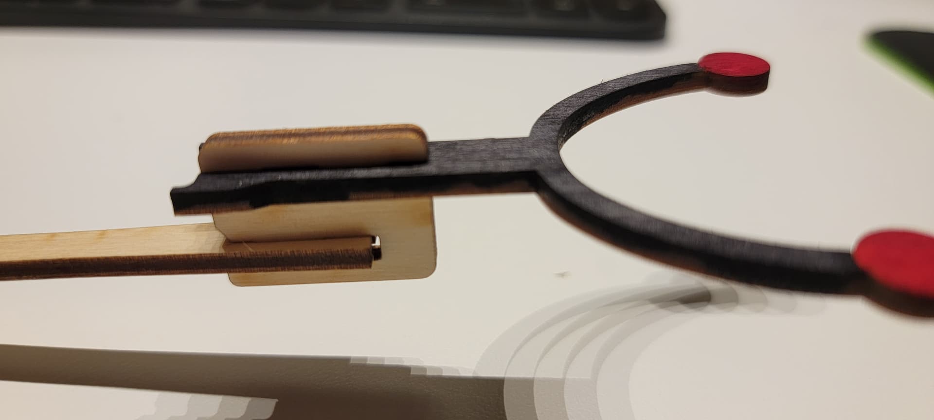

I spent all day Thursday designing the little doohickey to make the eyeballs move.

Nice work! Did you buy a particular clock mechanism? Can you say where you got it!

Thank you. It is a quartz pendulum movement from bearwood.com

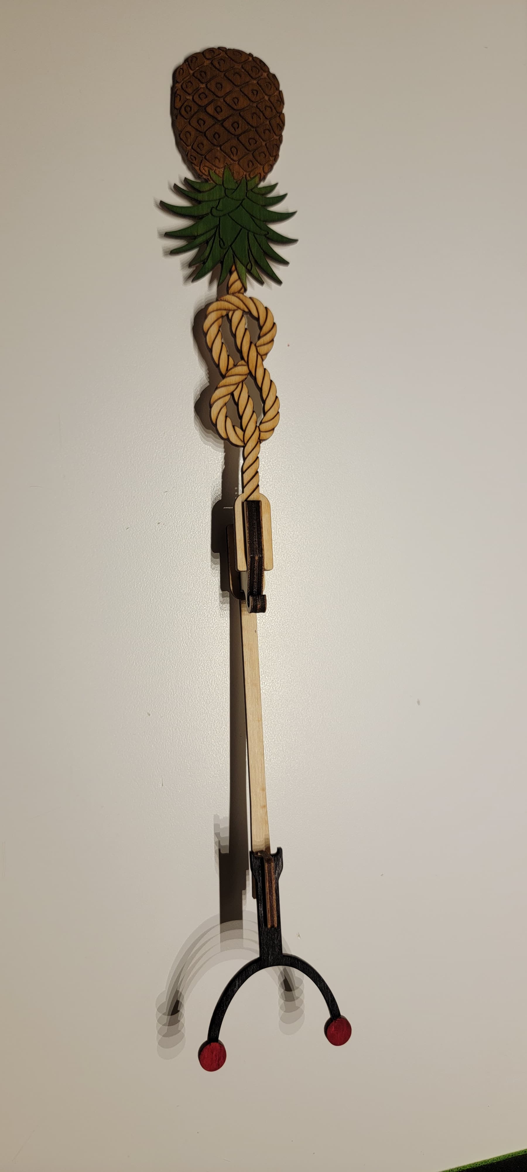

A better question for @brantholland would be: Besides the clock mechanism you used, could you share with us the sync mechanism behind the clock that moves the eyes with the pendulum?
Here is how the pendulum is built.

Thank you for sharing your pendulum design. It is great to see how other like minds work.
