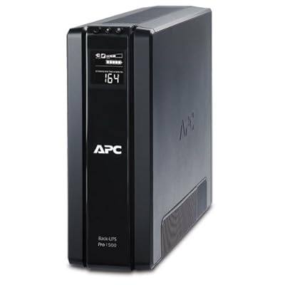

Does anyone use an uninterruptible power supply (UPS) for their glowforge?
If so what is the specifications that I would need for my glowforge?
Some do.
The max power rating is 800 Watts for the Glowforge.
If you are in areas prone to brown/black outs, it would be a good idea.
Make sure to put a battery back up on the wireless router and your ISP’s equipment.
Ok, I see a Cyber Power UPS 1350 VA, 810 Watts
half load - 9 min
full load - 2 min
surge rating - 1500 Joules
would this work for the Glowforge?
if you have experience let me know what you think.
That would be fine, but you’ll only have 2 minutes of runtime.
It would work for taking the brunt of a temporary brownout or protecting from a lightning strike, but you shouldn’t expect it to allow the completion of the majority of print jobs that are in progress.
Yes, I have a 1500VA APC on mine (and a similar one on my 3D printer)
Go with an APC 1500G.
Not only is it a little longer runtime at full load, but the APC 1500G has the ability to add an additional “side car” that will triple the power rating (for those areas where power is really inconsistent or stable).
