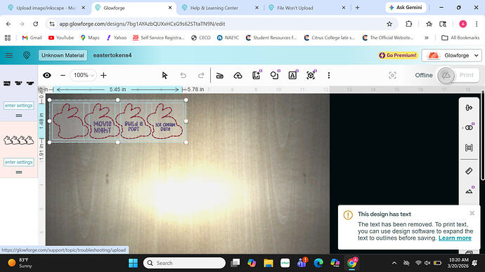

Hello My yearly subscription ended I really don’t want to renew I hardly used. When it first ended I was able to edit files still. Now it wont let me add font or images. I tried inkscape because its free I don’t really know how to use it. I edited a file I bought off Etsy SVG saved it and uploaded it to glowforge it did not upload the changes. The changes show on the document when I open it. I asked Chatgpt it said to make sure I save as a plain SVG and no layers or locks. I didn’t know where to check for locks but if the changes are showing after saving and I open the file in my documents folder shouldn’t it save what am I doing wrong???
I tried to upload and save a smaller file because I did see it only allows a 100 km or smaller or else you need the pro. It still did not save the edit text I did on inscape. But it did show this message below but when I clicked learn more it said error. Figures I might just buy the renewal :tired_face:. The bunny with out text is the one I tried to edit all others are original from etsy file.
Within Inkscape, you will need to select each ‘text’ item and then select Path –> Object to Path. After that, save the file and reimport and that message should disappear.

Thank you for replying let me try that :grinning_face:
It worked!!! Thank you so much! I’m surprised glowforge let me move the font over with all my restrictions. I’m not familiar with inkscape I will need to youtube basics. I really only need to learn editing text from files I purchase. If you have a suggestions on youtube videos that would be great. I had a hard time adding that text.
