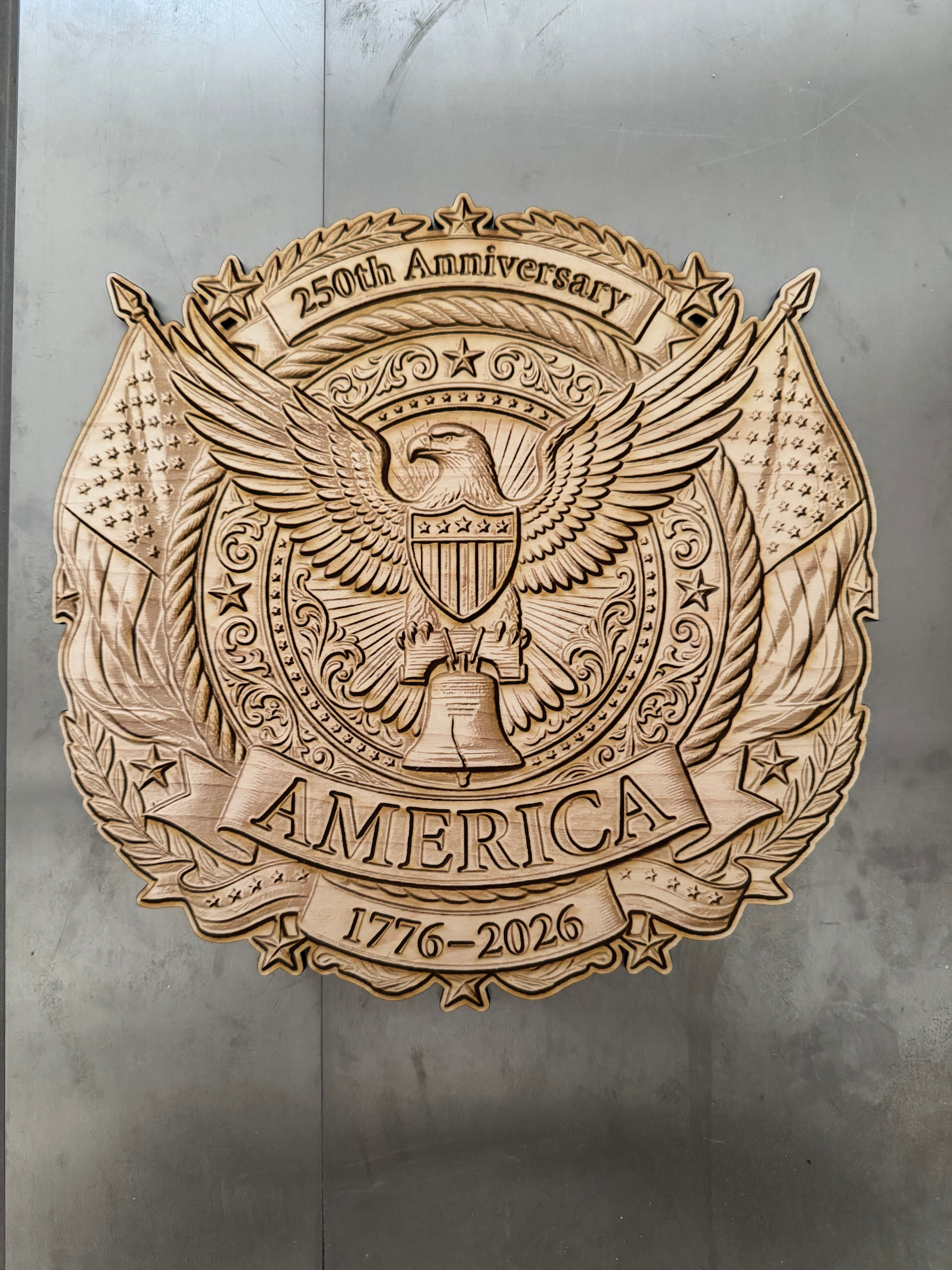

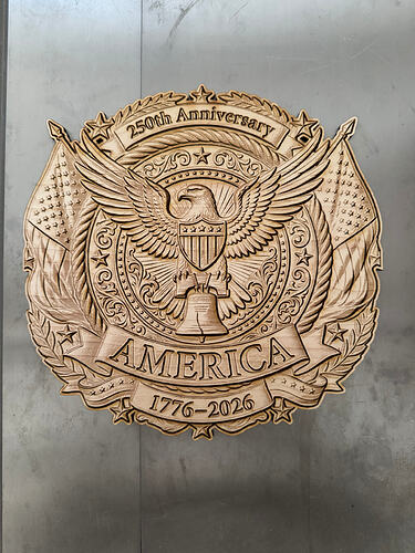

USA 250th plaque
engraved on maple

I can’t believe how clean the engraving looks, almost too clean.

Thanks. I get better engraves like this on the GF than I do with the big Thunder 100w
what’s your process for cleaning the char off? that’s super clean.

It’s it actually 3D or 2D made to look 3D?
Both are cool, but very different techniques!
Very light sand with 120 grit
This is 3D illusion, so it’s almost flat to the touch.

Did you create this or did you buy the file, because the 3D illusion is fantastic?
Looks great
Thank you. This is originally an STL file for my CNC, I did the conversion to bitmap for the laser.
