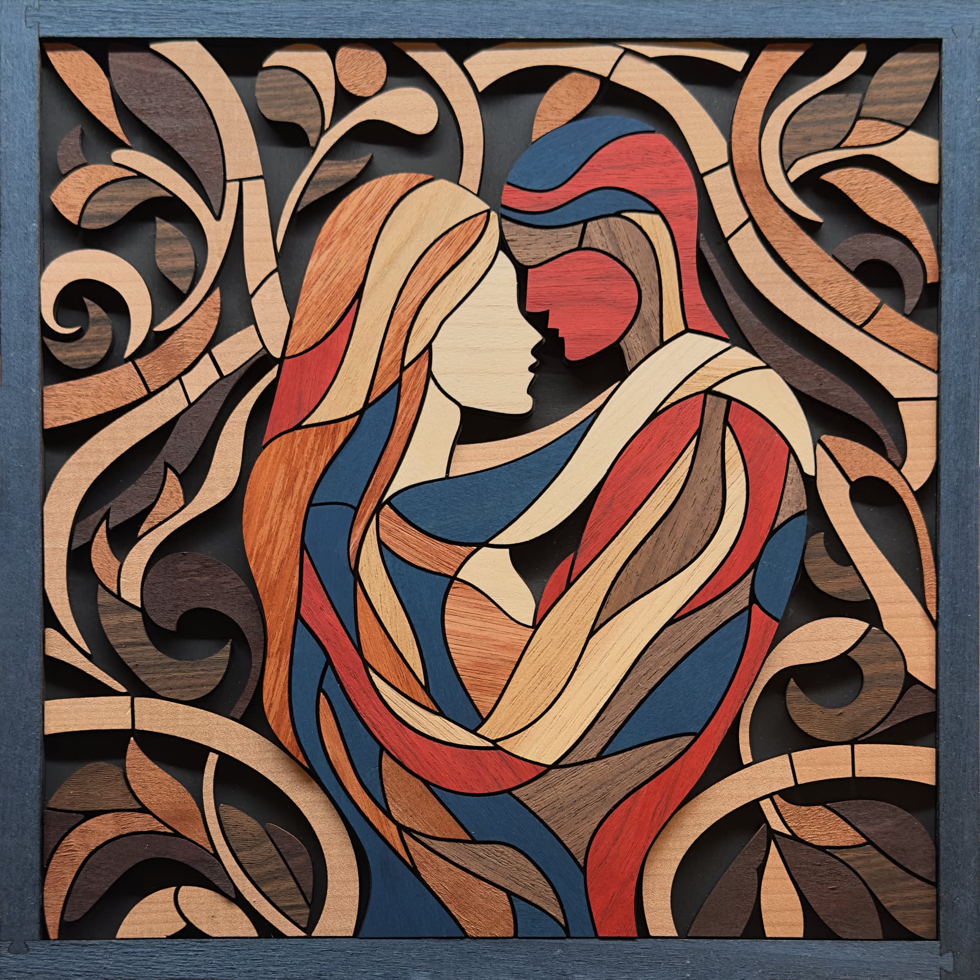

Another learning experiment in making mosaics “less flat”. Plus trying to catch up on my holiday pieces!

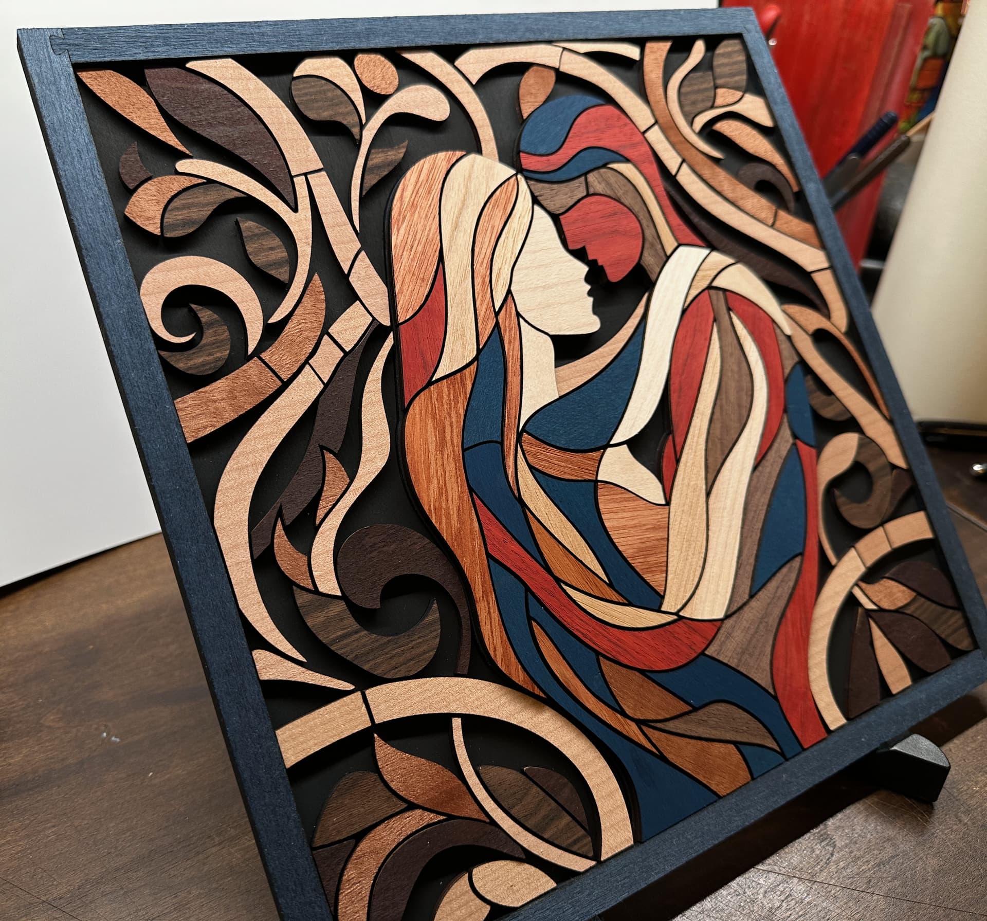

All these tricks would be obvious to a 1st year art student, I’m sure (but not obvious to me):
  • A black backdrop deepens the shadows.
  • Precise 1mm gaps between pieces emphasize their edges and break the flat surface.
  • The foreground subject is slightly raised, and also distinguished using brighter colors and stronger wood grain patterns of different orientations.

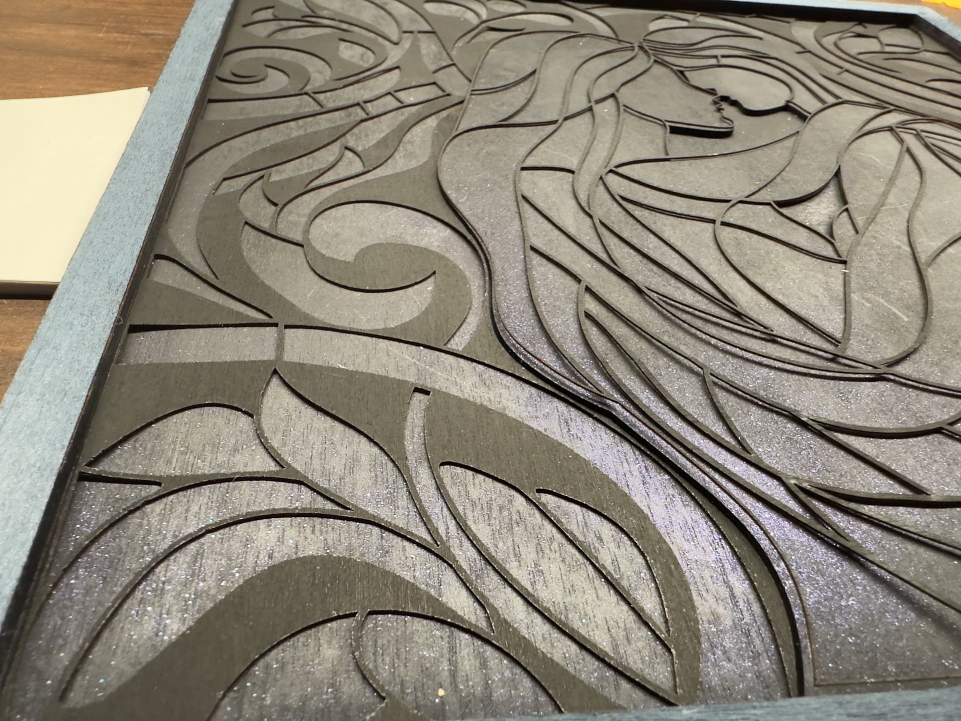

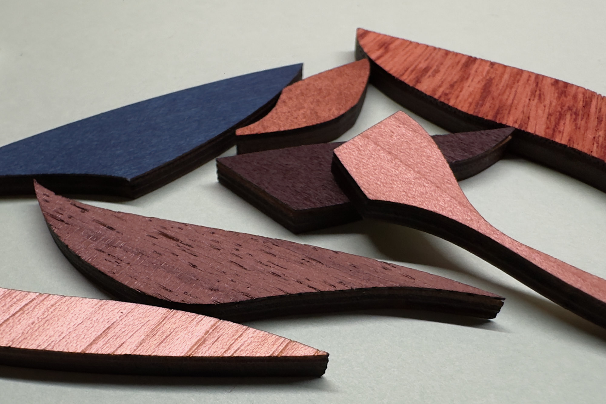

The pieces are made of 10 types of veneer mounted on 1/8" plywood. Most of them have their natural wood color; three of them were dyed (red, blue, coffee).
The black backdrop is a thin veneer lattice that helps position the pieces with 1mm separation, and is glued in place.
The pieces will be left unglued for now, so it can be enjoyed as a puzzle.

This is lovely. The variety of veneers gives it such depth.
Oh, gorgeous. I like that you raised the foreground image. If this was a gift, I’ll bet it was much appreciated!
I like the idea of emphasizing the gap and making it consistent. It really adds to the piece. Well done!
That is gorgeous! I love the piece grid in the back for placing the pieces and deepening the shadows. And that it allows it to keep it’s shape at an angle is icing on the cake!

One problem with making a batch of these is that a veneer variety pack only has small samples of each type, so for each copy it’s extra work to select the veneers and mount them.
