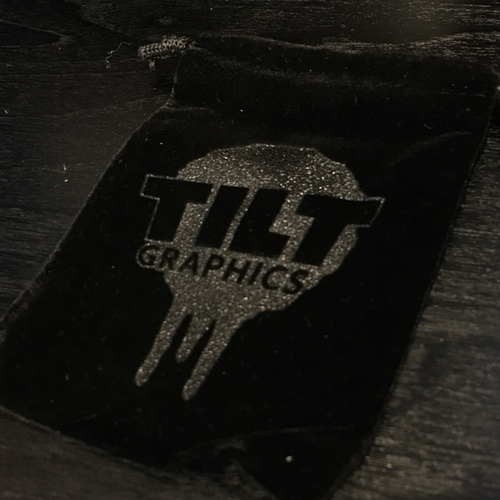

So I have had this awesome machine now for just a month today and am slowly getting to know it.

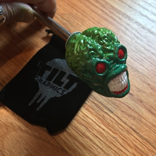

I have a company that makes mods for pinball and one of the mods we do is custom shooter rods (see image), and to package them we ship them in velvet pouches that we use the GF and etch our logo in with (see second image)

So cool, what settings did you use to engrave this velvet?
I set it at 225 dpi and power to 45. Problem was getting it to stay put. So what i did is, I cut cardboard and sprayed with spray adhesive. Stuck the bags on and then etched them. With the cardboard and bags in place I set the focus to 0.325 and thats all.
