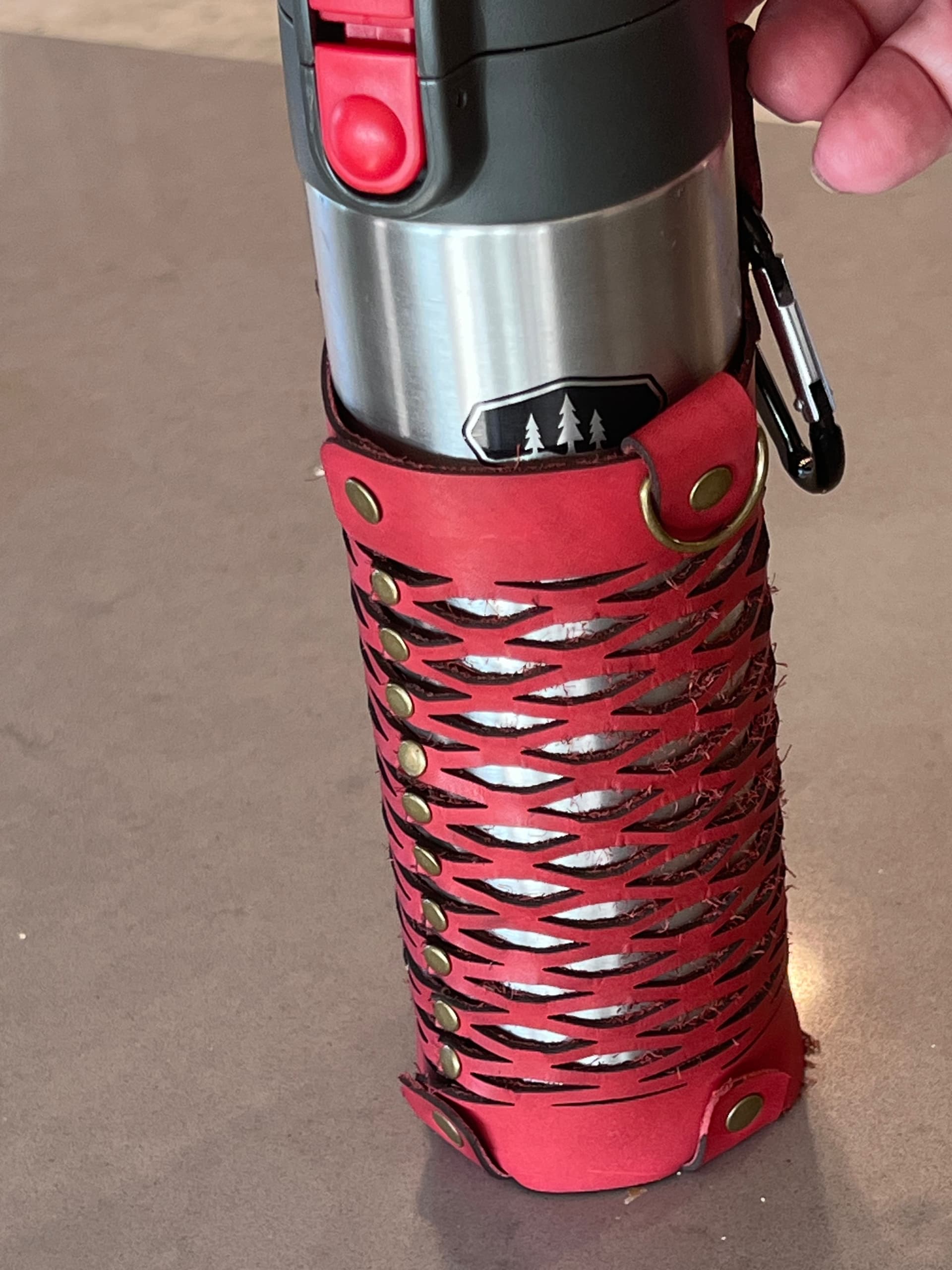

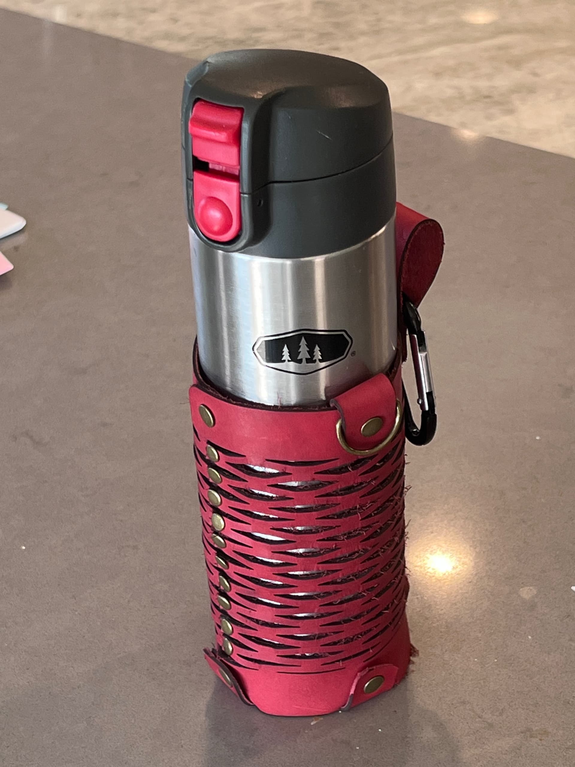

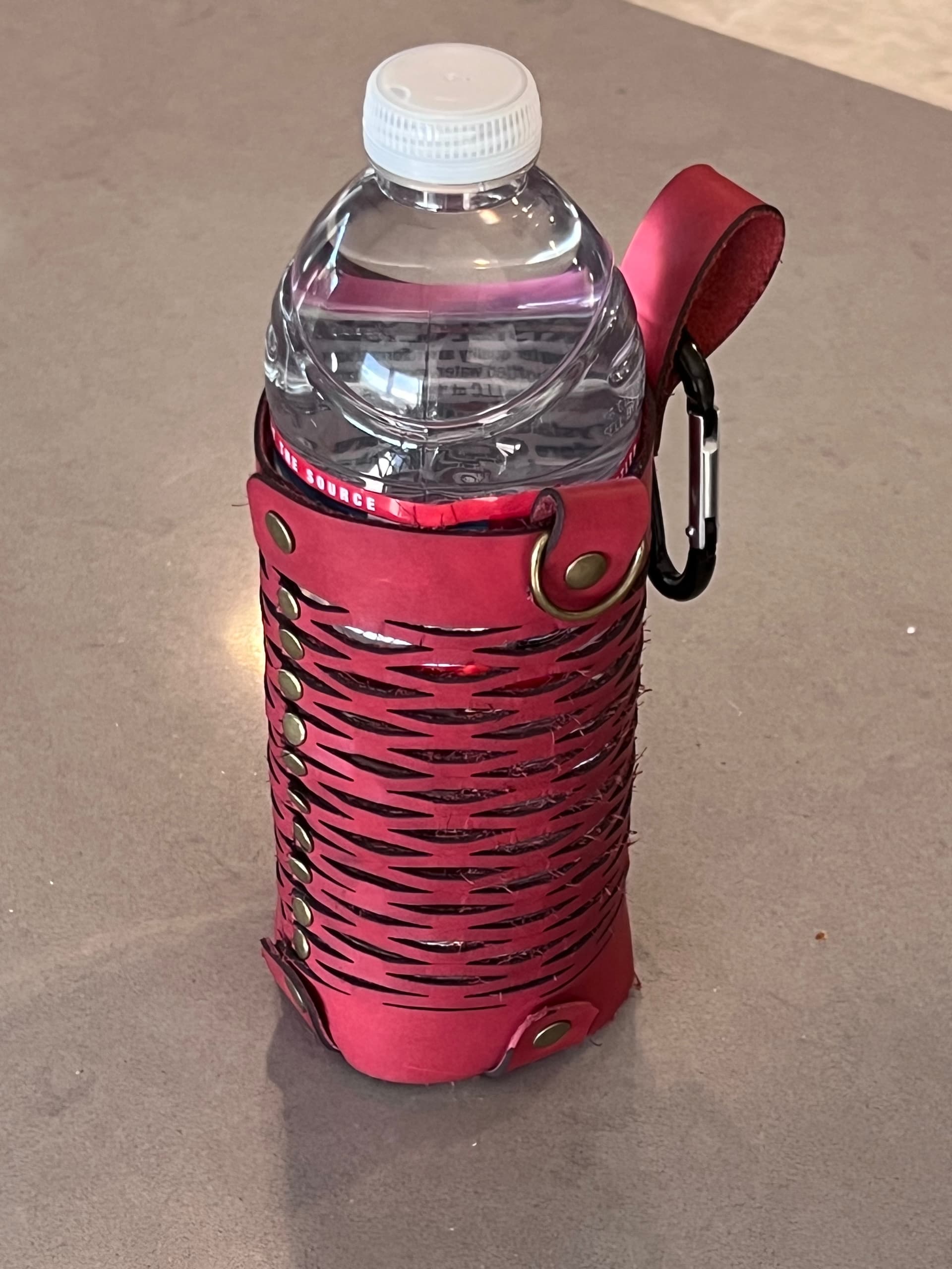

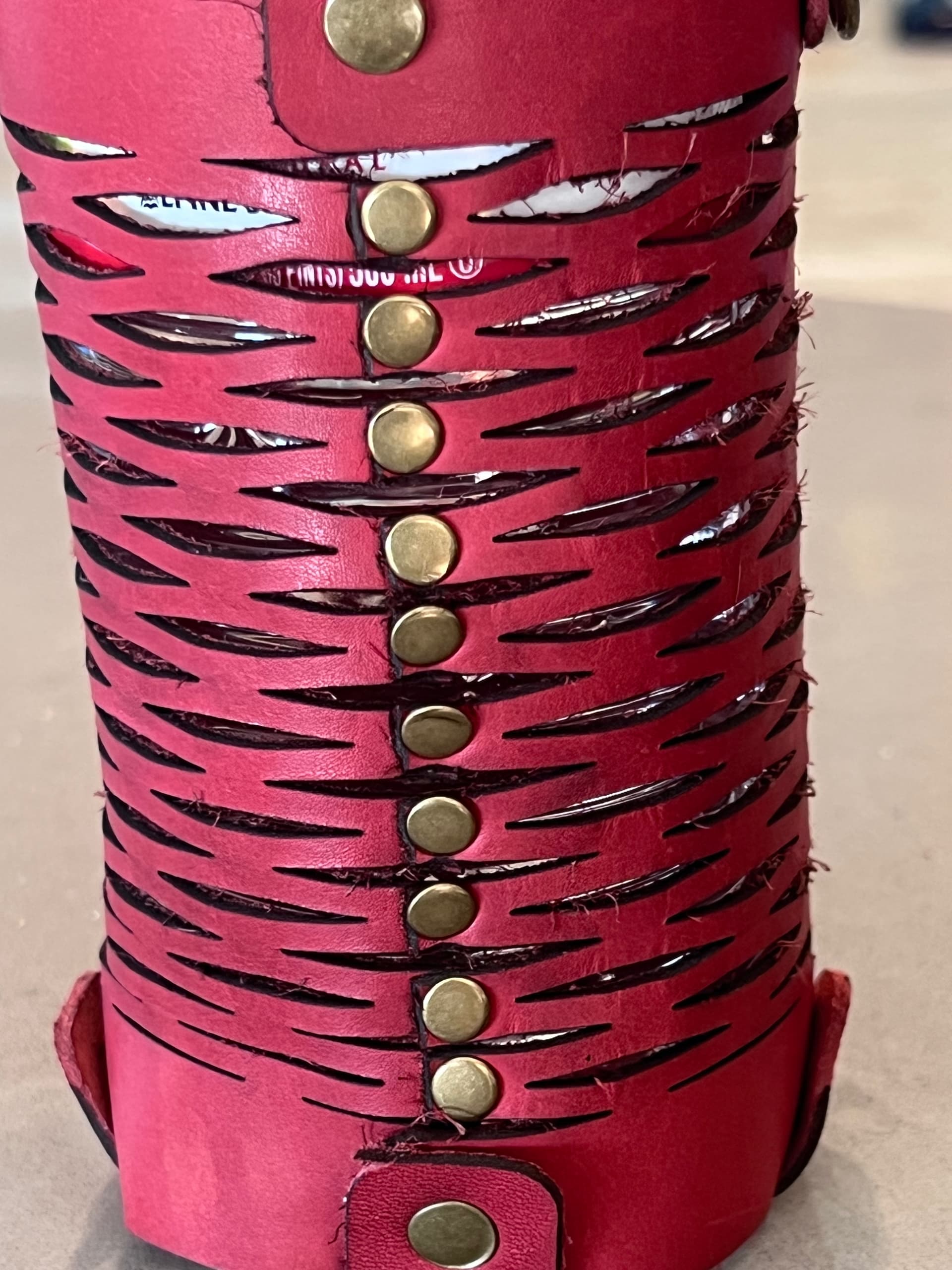

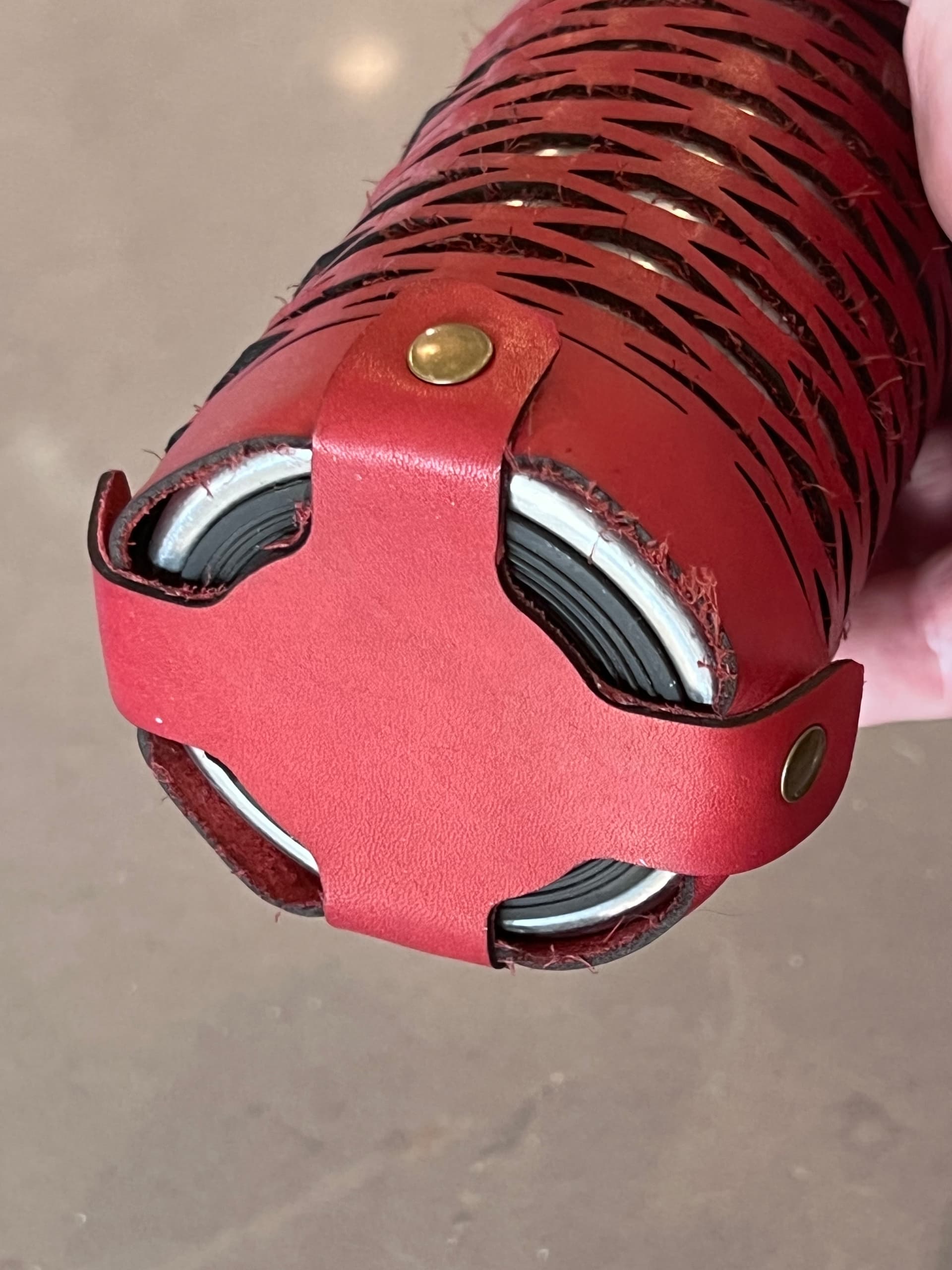

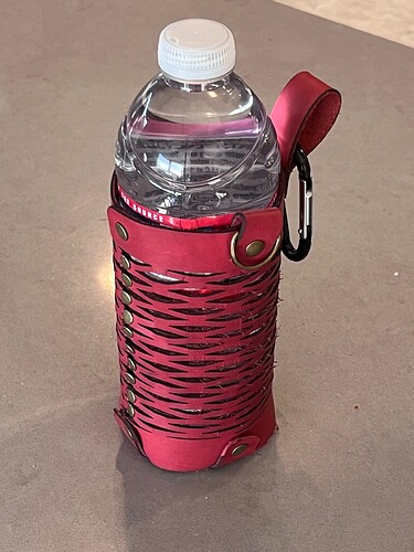

This little leather project holds either my vacuum flask or a standard Crystal Geyser plastic bottle. Using alternating slits, it expands upward when hung. This also grips the bottle like a Chinese finger trap. Rivets hold it all together. Remember not to cut leather dyed or tanned with chromium materials as they emit toxic fumes and particles. Dye or stain it after cutting.

Very nice design! How hard is it to put the rivets all the way up the side? Seems it would get a little tight to reach into the further up you go. But I love it!
That’s beautiful! Made to be practical, but every day art is one of my favourites :grin:
Easy. The lower rivet anvil is just a small disk about 1.5” in diameter and 1/4” thick. Just slid it inside the leather sleeve and set the rivet above it.

basically a living hinge applied to leather. well done!!!
