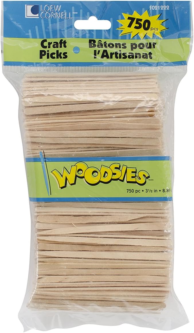

Those are great. And on the subject of cheap bulk things, these are what I typically use for applying glue:
