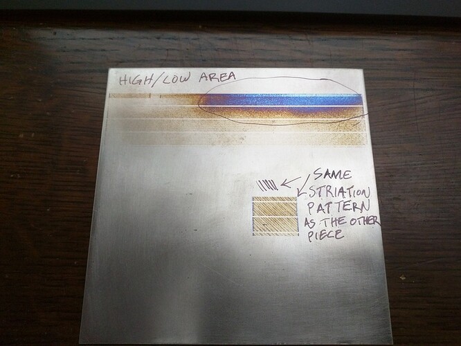

Welp, I gave it a shot, but it seems that titanium is very sensitive to focal distance. At least, this is my working theory based on the result of my latest marking “test”.
Unfortunately, the first piece of titanium I tried was not flat. It seems to have a uniform thickness (~0.53mm) but it’s a little bent/warped. I may have bent it while sanding/cleaning it; I won’t bother cleaning the next one.
I can’t think of a way that I can flatten it with the tools/knowledge that I have. I’ll check out the other pieces and see if they look better. If not, I’ll just do another test on the piece that I have been using.
another edit…
I’ve messed around with it for several hours now. Foil may be a no-go. At least pieces this small/thin with this much coverage attempted.

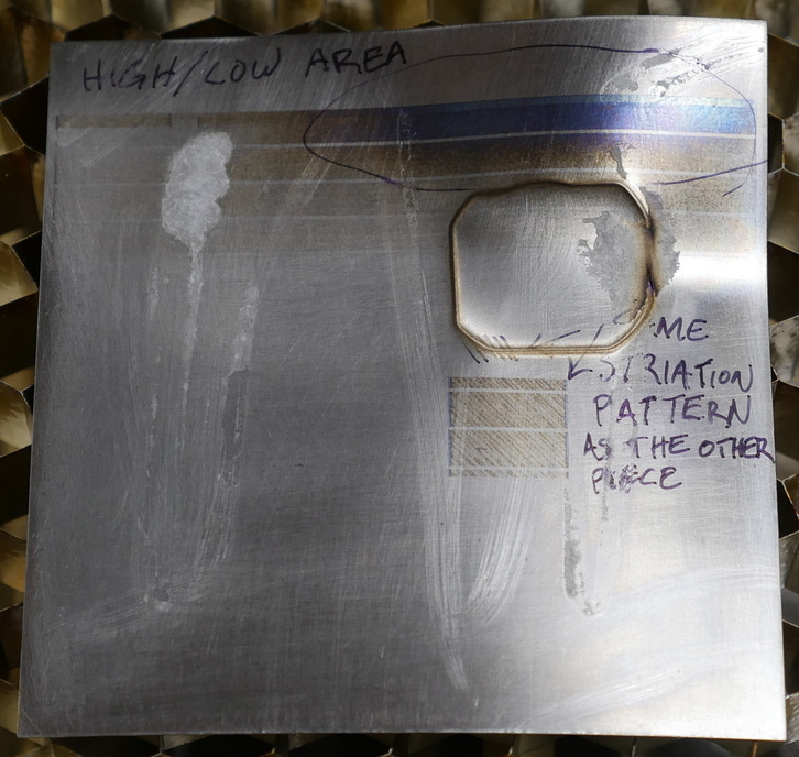

I took this same piece of titanium and flipped it over and super-glued it to a granite surface plate (with a piece of masking paper in-between). It was pretty flat and pretty perpendicular to the laser (± 0.2mm at every spot I measured with an indicator attached to the head). The first strip of engraving was fairly uniform, but it was brown. I canceled that engrave and restarted a couple of times after messing with settings, none of them seemed to be working very well so I basically gave up. When I pulled the piece of granite and foil off the bed I noticed that it had curled up a couple millimeters in the area that was marked. Argh.

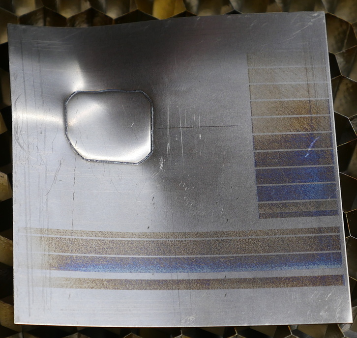

I decided to give cutting titanium one more try. Turns out that was my last try, at least for a while.
The foil started warping almost immediately. I decided to ignore it and just see what happens. After a while it started to look like it might be breaking through on the left side. The little explosion of light at the point where the laser connects with the metal started to sputter. It looked like there might have been a couple small pinholes where the laser was passing through the metal so the little ball of light/fire/plasma/whatever wasn’t being formed any more. As I let it continue, the area where the sputtering happened seemed to get longer and longer, as if the pinholes got stretched into short lines. Then a small area on the bottom right started sputtering! More evidence that it was breaking through, slowly but surely.
After a few more passes the ball of light disappeared almost completely. The odd thing was, I could see the red laser spot on the titanium. Hmmm… that’s odd. I was doing this to experiment though so I let it continue. Then, a couple seconds later, I noticed an anomaly on the lid. What is that? Oh crap, it’s melting! Oh no, it’s starting in a different spot! Quick, open the lid (an odd thing to do, but it’s as close to an “e-stop” as the machine seems to have.
Well darn, not only did it not cut through the “foil”, now I have two spots on the inside of my lid as a constant reminder of when “just seeing what happens” was a bad idea. :frowning:

But I still wonder about the titanium in this case: was it the titanium fire that was eating the lid, or was it a semi-focused reflection?
I would say column of heat most likely. I don’t know all of the combustion products generated by Ti burning, but I doubt they would be particularly reflective.

I suppose that’s possible. I did pick up the piece of titanium within seconds of opening the lid and carefully patted the entire surface. Not only was it not hot, it wasn’t even warm.
Again, there was no fire. (The photos I posted are the actual piece that was in the machine at the time. It clearly wasn’t in some kind of inextinguishable fire.)
This part makes it sound like your lid of the laser cutter was melting.
It was. Not from a fire.
