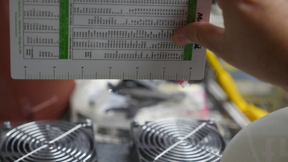

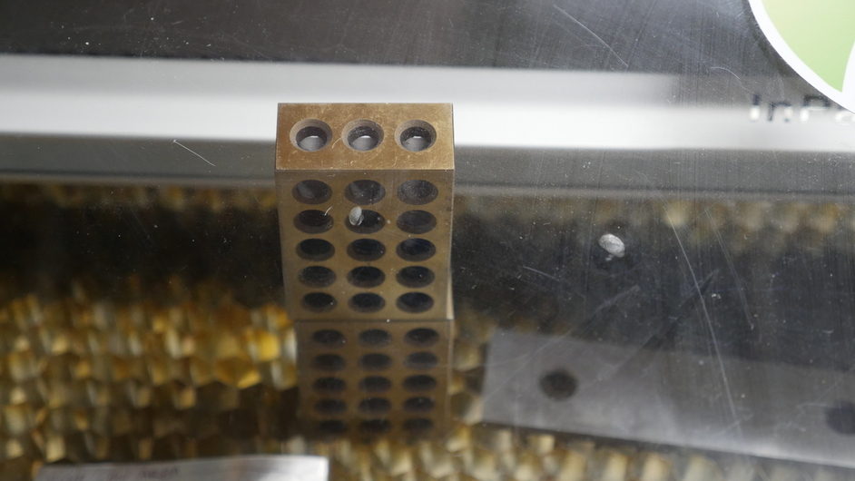

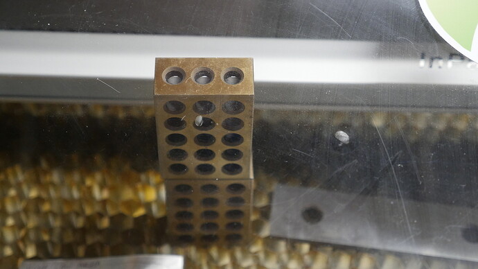

You can see the two spots here.
Here they are from the top. Note that the lid was nearly 6" away from the bed.
Sure looks like a burn/melt to me. (I’ve played around with diode lasers on plastic, and that looks not unlike some of my better results.)
Whoops!
Oh no - is your lid made out of acrylic?
I’m guessing that’s what it’s made from. Either that or polycarbonate I bet.
So for anyone planning on modifying pro or basic. Hirudin’s lid could have been your eye. a Class IV laser deserves a lot of respect and caution, so please think about these things.
Another minute and it could have been @Hirudin’s eye. :frowning:
I shouldn’t give advice about this, but - maybe consider epoxying a piece of glass on top of the lid to keep the photons in?
I believe this conversation has convinced me that I really don’t need to experiment with titanium. :confounded:
I’m think an investment in good laser safety glasses and developing the habit of wearing them is warranted before fiddling with titanium. That material definitely looks worth some play time and whatever safety measures it requires.
I wouldn’t be too worried about it, I was really horsing it.
Heheh! :wink:
I should clarity…
I wouldn’t worry about attempting to mark titanium in our Glowforges.
My lack of worry doesn’t mean it’s 100% safe or anything, proceed at your own risk, but the settings I used for marking and the settings that I was using when the spots on my lid melted were DRASTICALLY different.
My ill-fated cut attempt was going at a speed that was ~80 TIMES slower than when marking and even then the problem didn’t become apparent until at least 30 passes had been made on the same line. On top of that, the piece of titanium that I was recklessly trying to cut through was unreasonably warped. These three factors (very slow speed, many passes, and warped stock) are so far removed from a typical marking operation that I would discourage allowing my mishap to dissuade y’all from attempting to mark titanium. Just don’t go super-duper slow.
