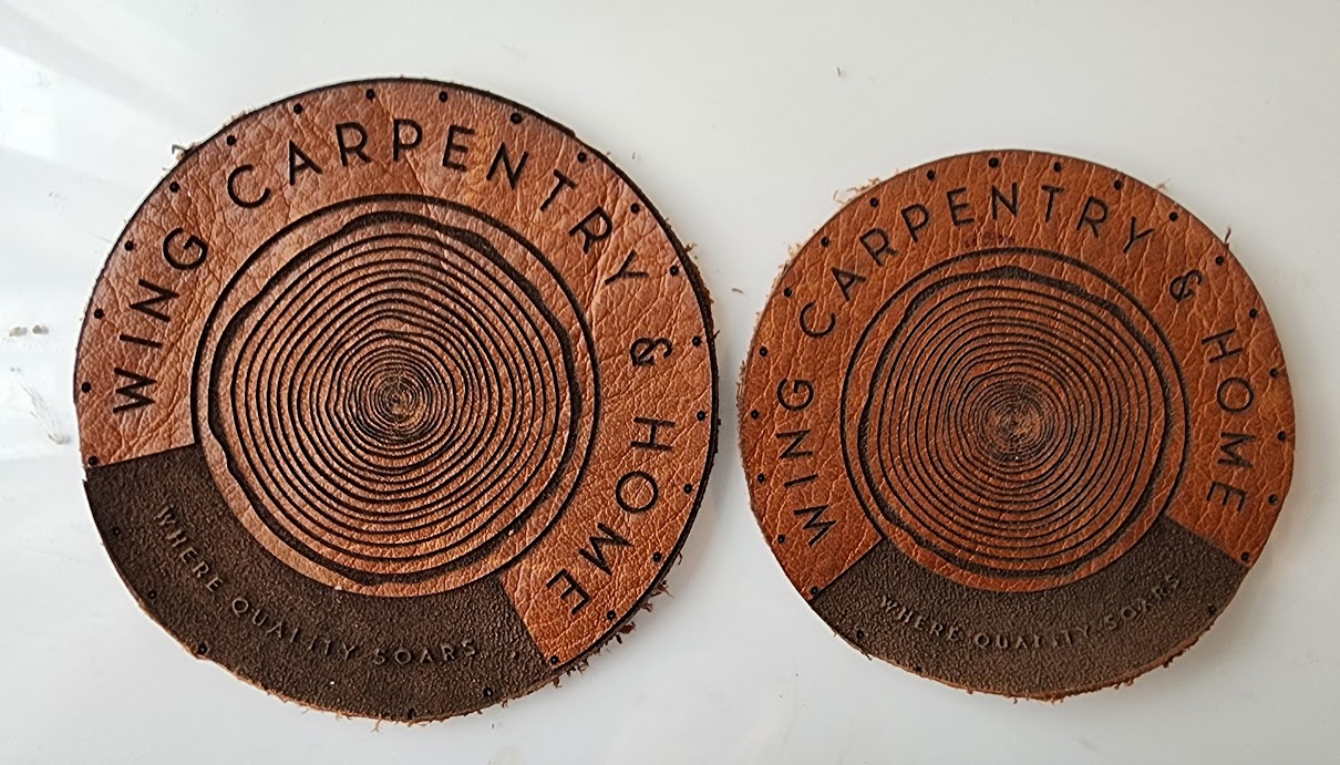

This is a project I did for a friend. He already had his logo designed, but he wanted it on leather patches he could put on his hats. Easy enough right?

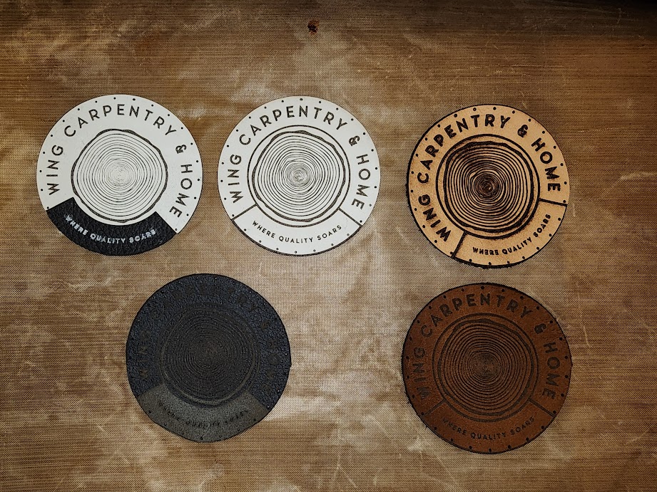

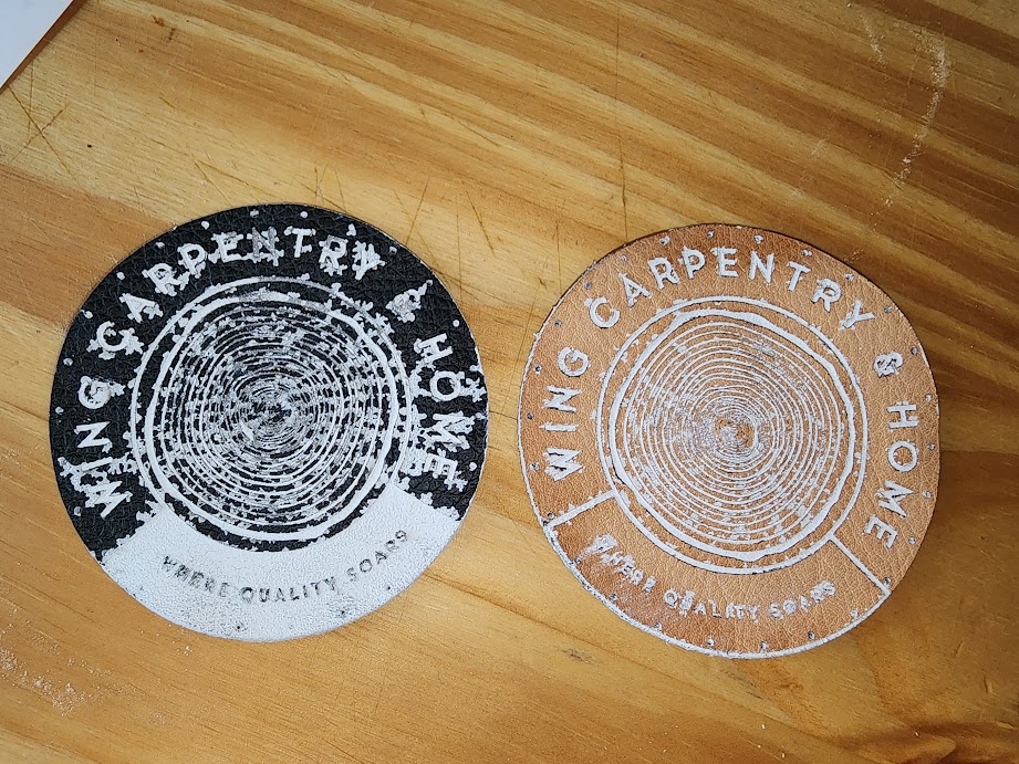

This are all the samples I made so he could make a decision.
Design Iteration
The original logo was black and white counterchanged (like the patch upper left). In leather, that required cutting it from two different pieces and layering them together. Not hard, but both time and material intensive. The rest were alternatives I came up with. The solid black is obvi a no-go. While you can read everything up close, from anything more than about 6" distance it just become a black blob. The light unfinished leather looks fine at first, but on a hat it’ll absorb sweat slowly - and that means the leather will turn darker brown starting at the bottom…hardly something you’d associate with quality! The engraved brown had the same unreadability problem at the bottom. Both painted ones were just eh.
He went with my favourites, the solid white and the pre-finished brown.

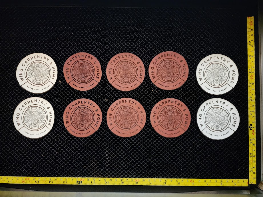

The finals
(of which two had to be run because it turns out there was an open node that failed on just two!)
