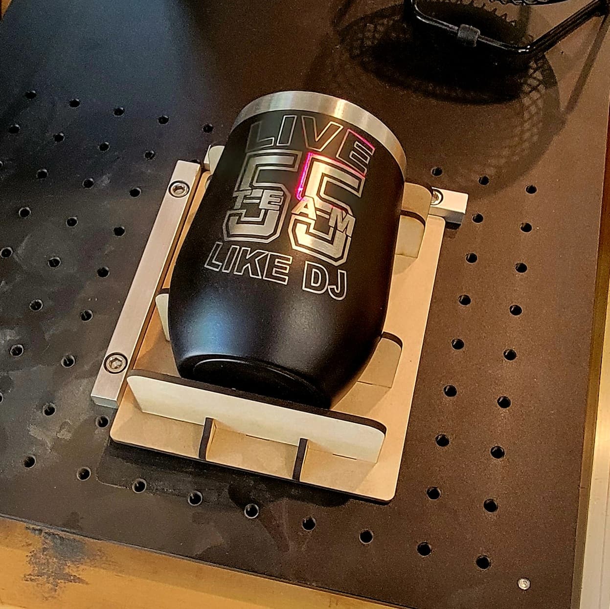

Although this jig was cut using :proofgrade: draftboard on the Glowforge, the tumblers were engraved on a 50W fiber laser, with the point of this post is to give information to anyone here who has or is thinking of getting a fiber laser to compliment your :glowforge:. Additionally, you’re all welcome to “Ooooh!” and “Aaaah!” over the jig too.

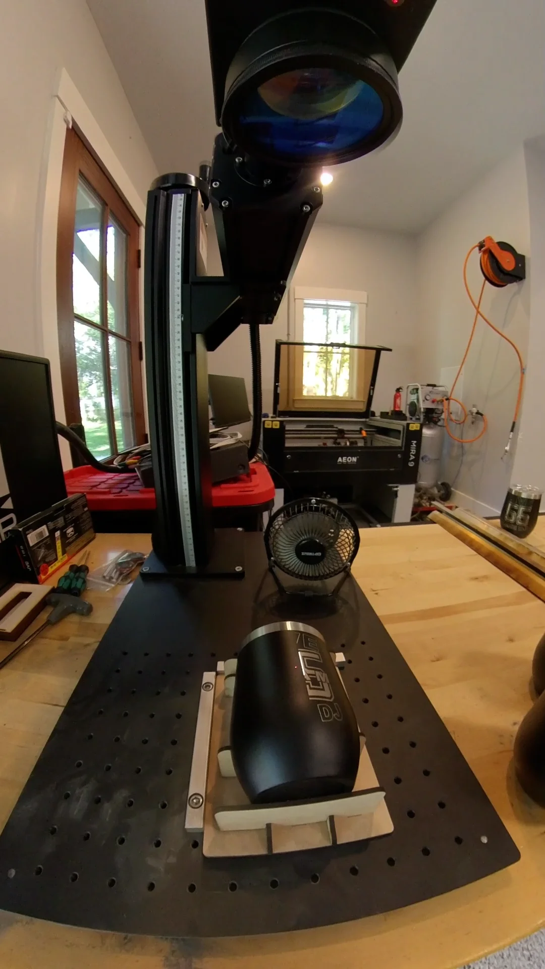

I got a request to laser engrave 140 Wine tumblers for a scholarship fundraiser and knew that engraving their logo on my 50W fiber laser would be the quickest when using a jig. The engrave time for each of these is 2 minutes, 38 seconds. To swap the tumbler for the next one takes ~7 seconds. Rotary compensation enabled in lightburn, I did these in 2 passes. I had help from my nephew knocking these out. Using a rotary tool on my other laser would have taken considerable more time, so for single sided designs, the fiber is best.

I like the jig also. Putting both a both a front and back bump stop seems like overkill though. Did you find it useful for both or just used the front to help stiffen up the jig?

Probably could have gotten away with just the back stop, but with a tapered tumbler I didn’t want to slide front to back. The mugs fit in perfectly every time, so I know that I’ll always have the logo placed perfectly. You’re right, probably overkill, but my design OCD kicked in and wanted something I could use repeatedly.

The mira 9 is definitely a workhorse. I do a lot of tumblers and water bottles on a piburn grip, which is amazing. But I wouldn’t have wanted to do 140 wine tumblers on the CO2 as it would have taken way longer. But for full wrap designs, it’s amazing.
