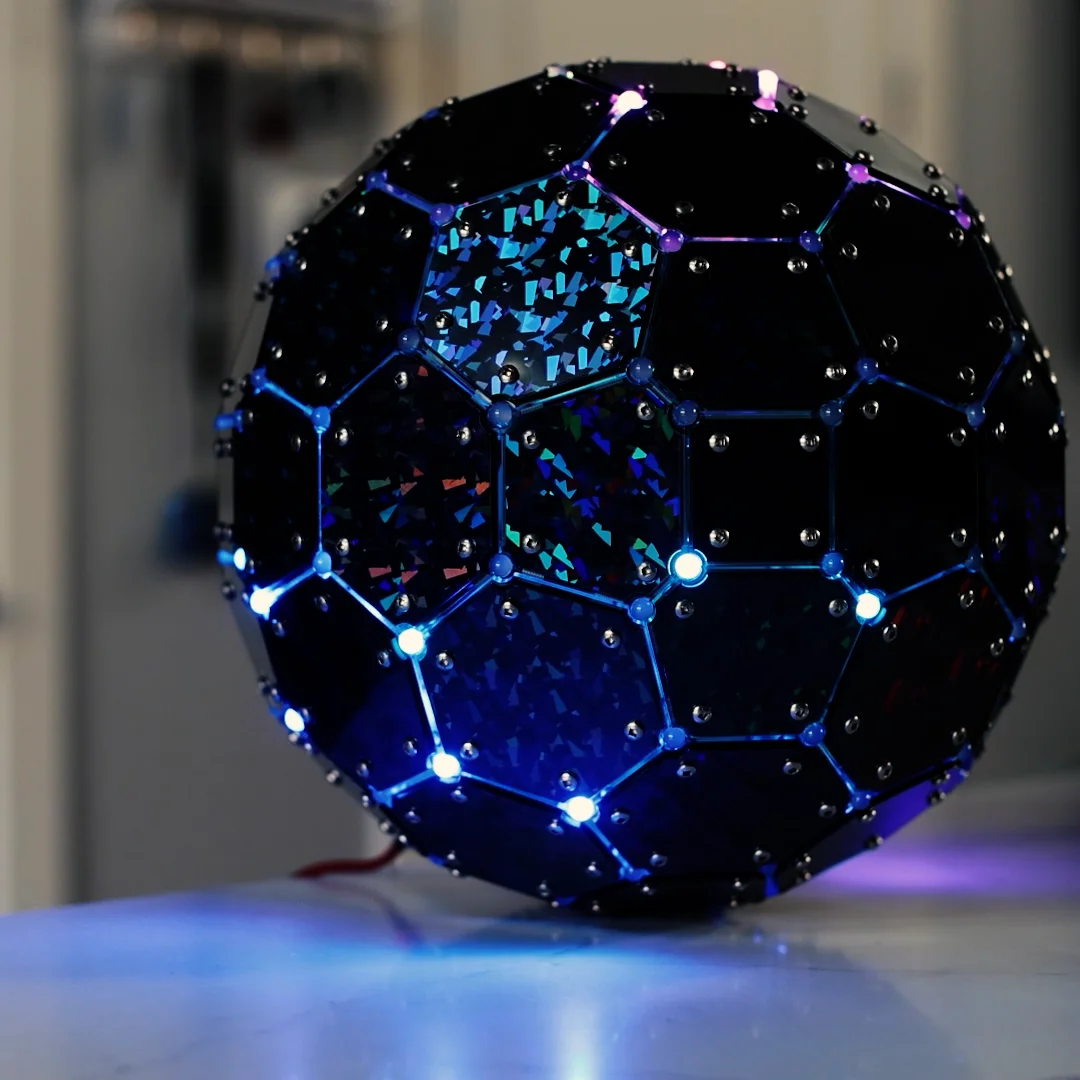

This latest polyhedral is a Dual of 4-Frequency Octahedral Geodesic Sphere, whiCh has 66 faces, 192 edges, and 128 vertices. A WLED pixel light is positioned at each vertices. The faces have two layers, :proofgrade: Green Glass Acrylic for the base and Holographic Nightmare Iridescent Acrylic on the top. The idea was that the LED bulbs would edge-lit the bottom green glass acrylic, which ended up working splendidly. The WLED lights are powered by a Dig2Go controller. WLED has amazing effects and this really looks amazing at night. Internal connectors were 3D printed on a Bambu X1-Carbon.

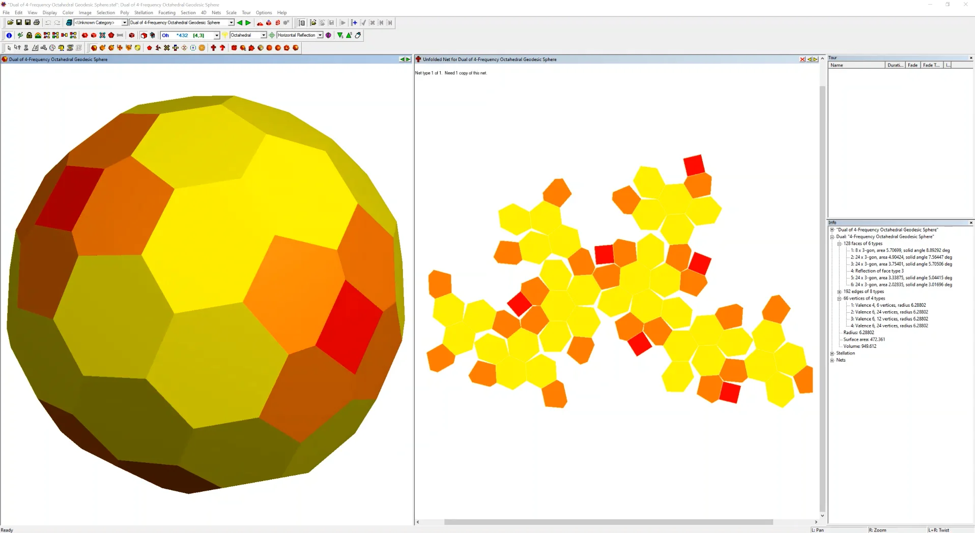

Creation of the Polyhedral using Stella 4D.

Final Results
WLED in action

The wires inside are also quite satisfying :grin:

This one must be mesmerizing in a dark room. Right out of a sci fi movie. Maybe you should computerize one and give it the ability to respond to voice commands.
The controller does have Sound Reactive WLED so it will react to your voice or music, but not like Alexa or Hal. Not yet…
