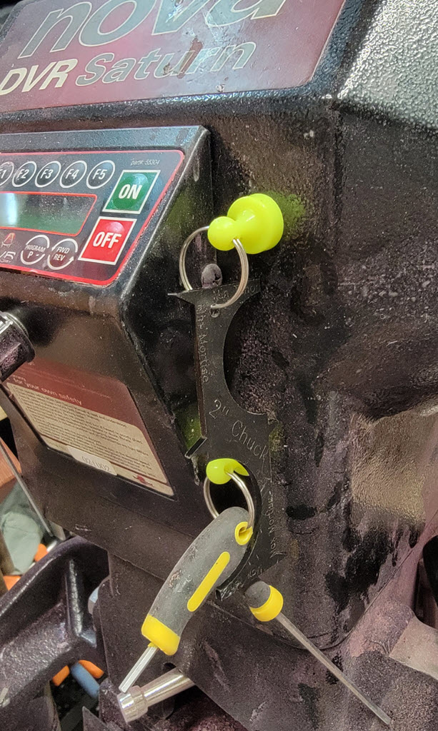

The template has a hole so it can be hung on the lathe. I buy net release magnets and toss out the lanyards. That leaves two magnets with split rings you can attach to templates, hex wrenches, etc. to stick 'em right to the lathe. As a rule I avoid lanyards, cords, wires, or anything like that around the lathe and the net release magnets without the lanyard are perfect for this.

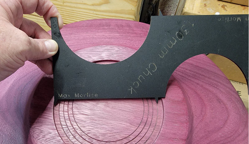

No but I might be able to illustrate. Here’s a platter I just finished. I used Nova Titan jaws which are larger than the template I’m showing in the photo, but I don’t have a template for those yet.
But you should be able to see in the photo how the mortise (the recessed hole in the center) sizes up to the template. If I were using the 130mm jaws I’d want those size guides to be a snug fit. The chuck jaws seat into the bottom of the recess then expand into it to hold the workpiece.

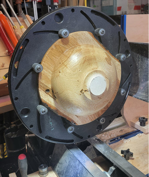

Sometimes you want a tenon which is the opposite of a of a mortise. The tenon sticks out and the jaws seat onto a shoulder around the tenon then contract onto it. After the piece is shaped and finished inside and out the tenon is removed. That’s whats happening in the photo below. I used a tenon because the wood was punky and soft and expanding into a recess would likely have split it.
When I made that bowl I used the concave part of the template to gauge the size of the tenon. That’s sized for the small jaws and I would have used the template posted at the top of this thread to measure it.
And in case anyone was wondering, here’s how I use the net release magnets. The two yellow magnets attached to the hex wrench and the template are the A and B sides of a single net release magnet set.

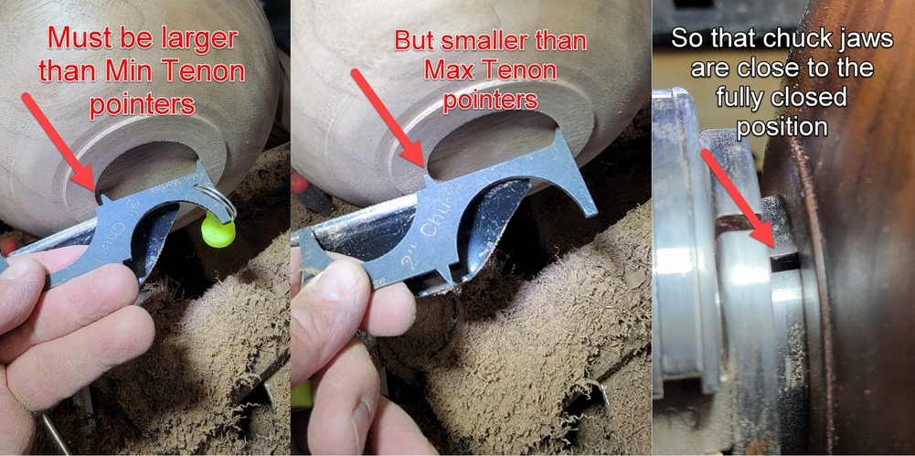

As of today, yes! I was making a bowl and when I grabbed the template I thought of you and took some new pics. The first two are when I’m making the mortise and the bowl is mounted with the foot out. The last one is after the bowl is turned around and mounted on the chuck using the mortise from the first two pix.
Also, the pic shows why I recommend painting the template before taking the masking paper off. I didn’t paint this one but the lettering started showing up better once it got sawdust in the grooves.
