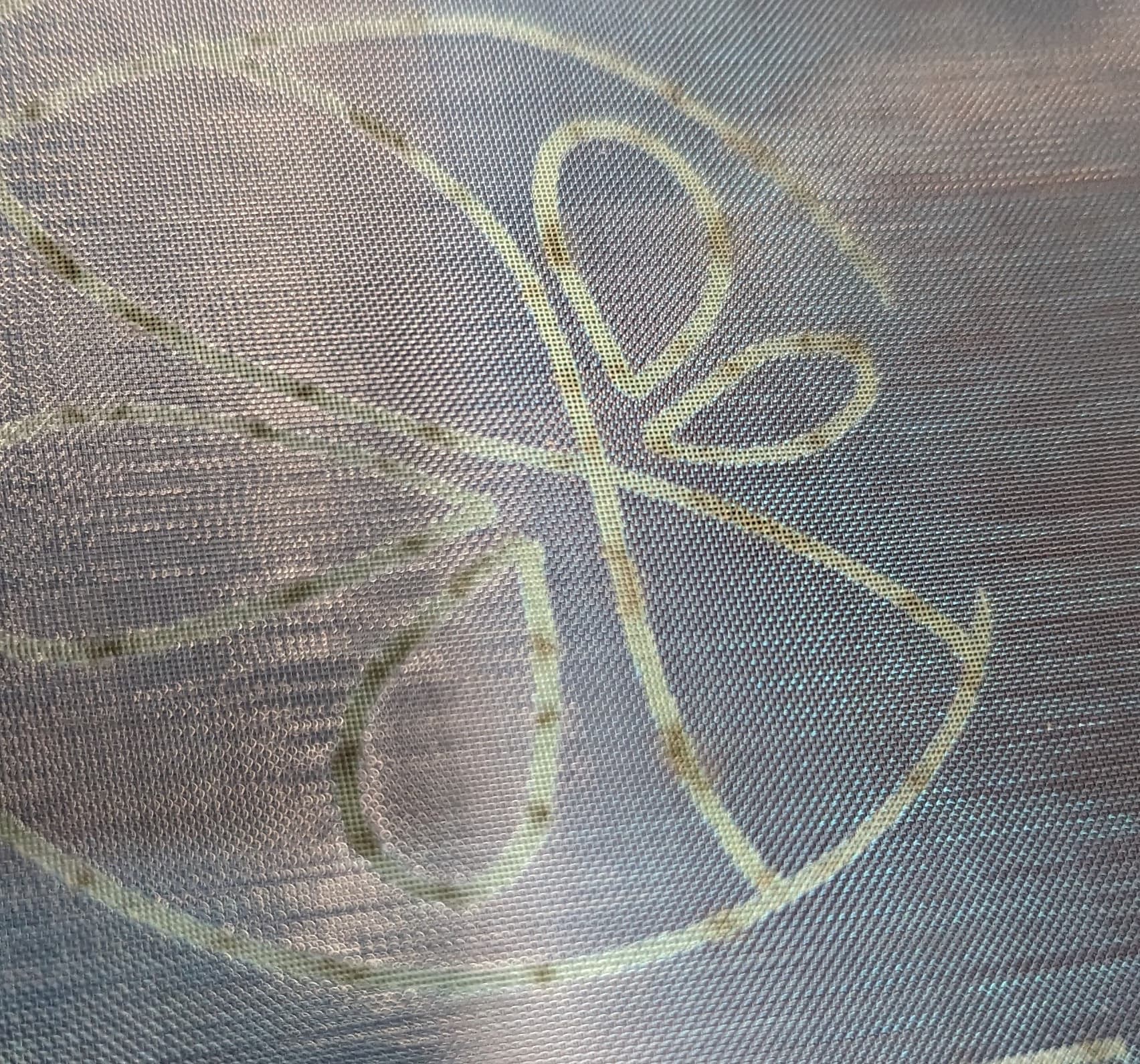

Thanks. Are the screens themselves metal mesh?
yes. it’s a very fine metal mesh. i’ll take some pics tomorrow with a coin for scale.
As promised, a closeup photo of the screen.

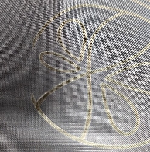

Thanks for all the testing and details. I’m in the middle of my first engrave on their screens now. Out of curiosity, how are you mounting the screen in the GF? I have mine pinned down to the crumb tray with magnets, but not for lack of trying several other ways first.
I had first mounted the screen in the XTool frame and found that it wouldn’t have clearance with the crumb tray in place. Then tried removing that, but it wasn’t tall enough for the GF to autofocus (or do any meaningful work).
i pulled the crumb tray out and put the full screen in there on top of a couple of blocks to get it in range of the lens. that’s what xtool shows in their videos. didn’t even think about just straight doing it on the crumb tray. is that working ok for you? it would actually be a little better because you can see more of the screen that way.
It worked out well enough. The print didn’t seem to suffer for it, but I did notice some back flash or smoke marks from where it was resting on the grid:
Front:
Back:
so to me, that doesn’t look completely burned thru. there’s a bit of halo around the edges and a few spots inside. there’s a tiny bit around my squares, but i think it’s a much smaller halo.
did you notice if that flashback affected printing?
