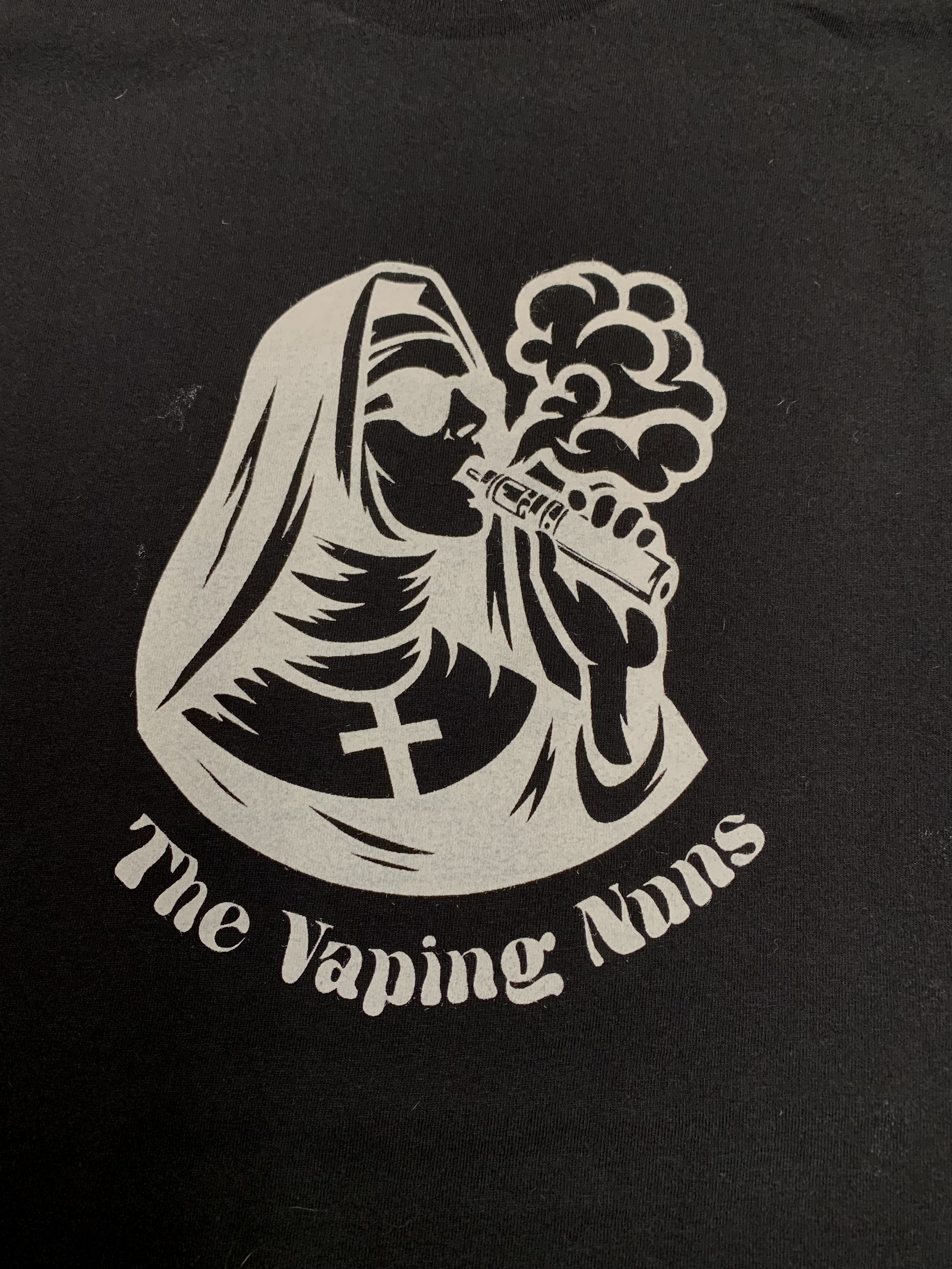

Ok, first tshirt. My squeegee technique needs a little work, but after running a sheet of card stock to load the screen, this was my first attempt. And if this is my baseline quality from my first shirt, I think I’ll be happy as I get better/more efficient.

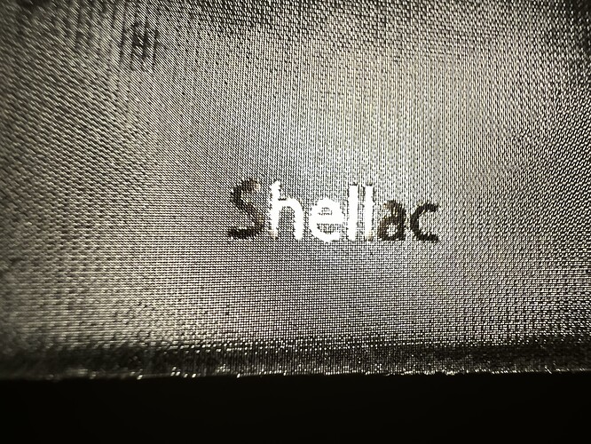

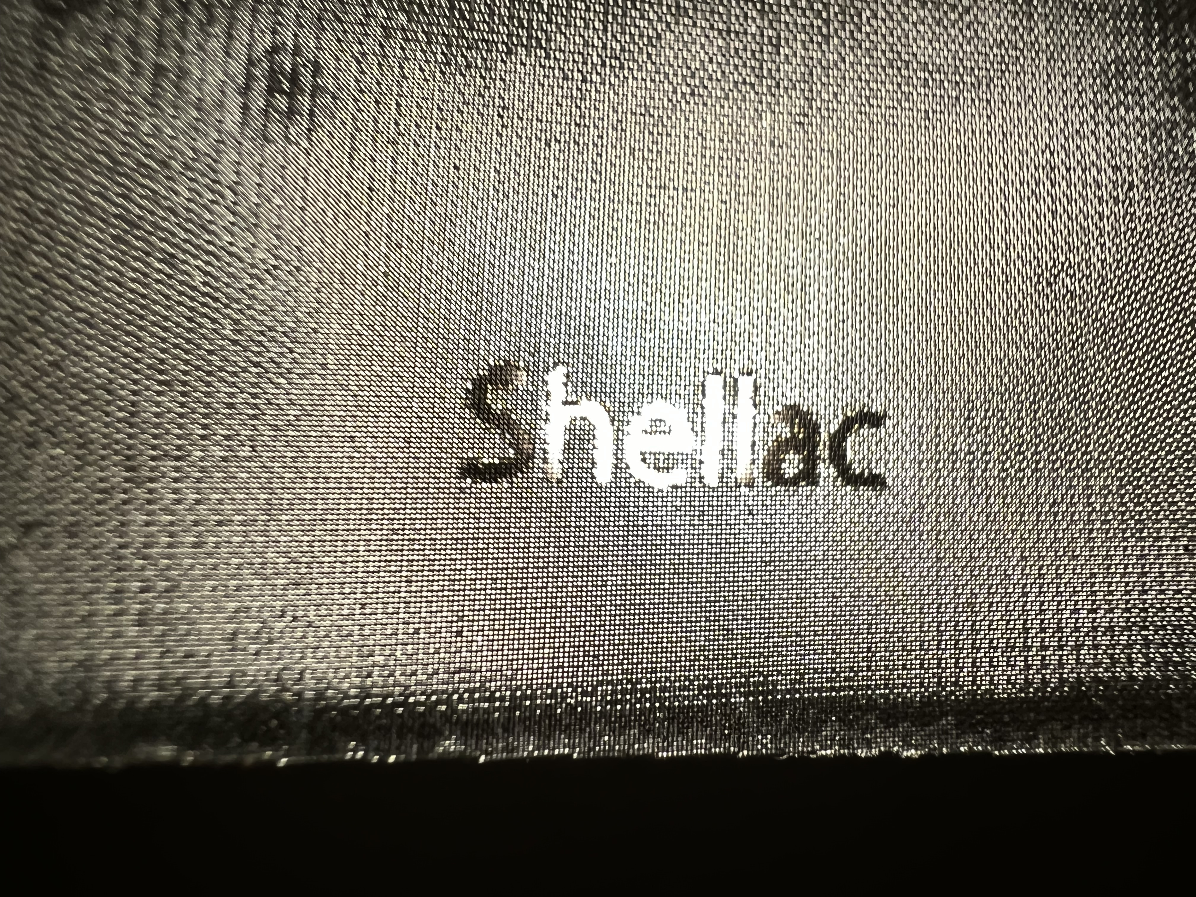

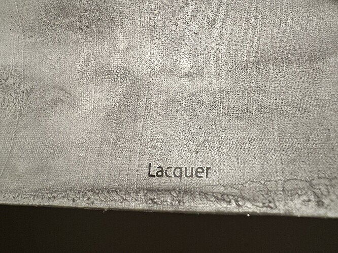

I was thinking of something like a can of shellac or lacquer just to fill the holes. they have a finer one:
https://www.amazon.com/gp/product/B081QB3BLF
might be fun to test.
i’d be curious to see how it went. you need something that will stand up to pressing the ink through the rest of the screen that’s engraved away. wonder if there’s a way to just put the photosensitive filler like they use in regular screens and use that. might have to “develop” the whole screen first, then engrave away the area you want to print. just not sure what is in that filler.

1000/70/270

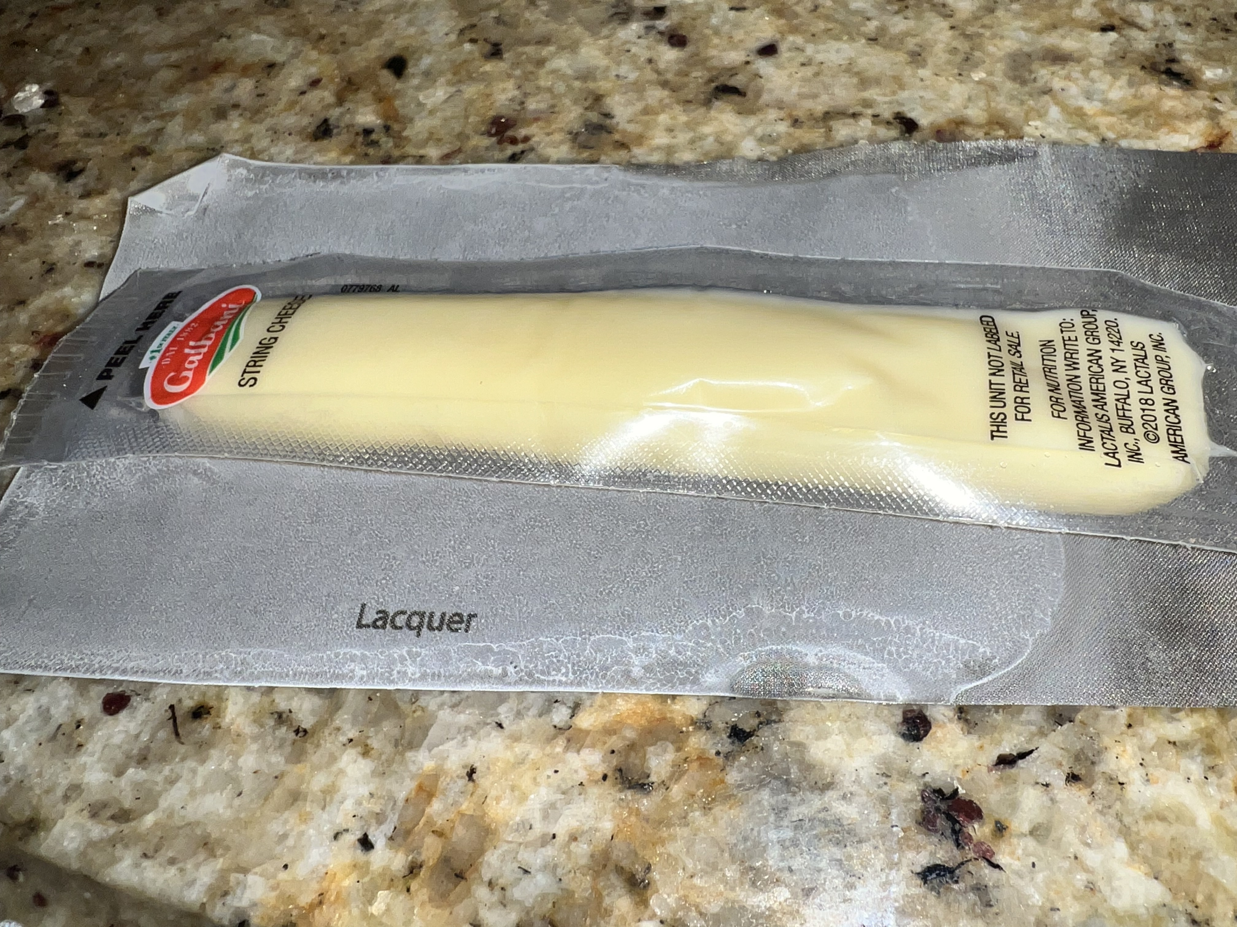

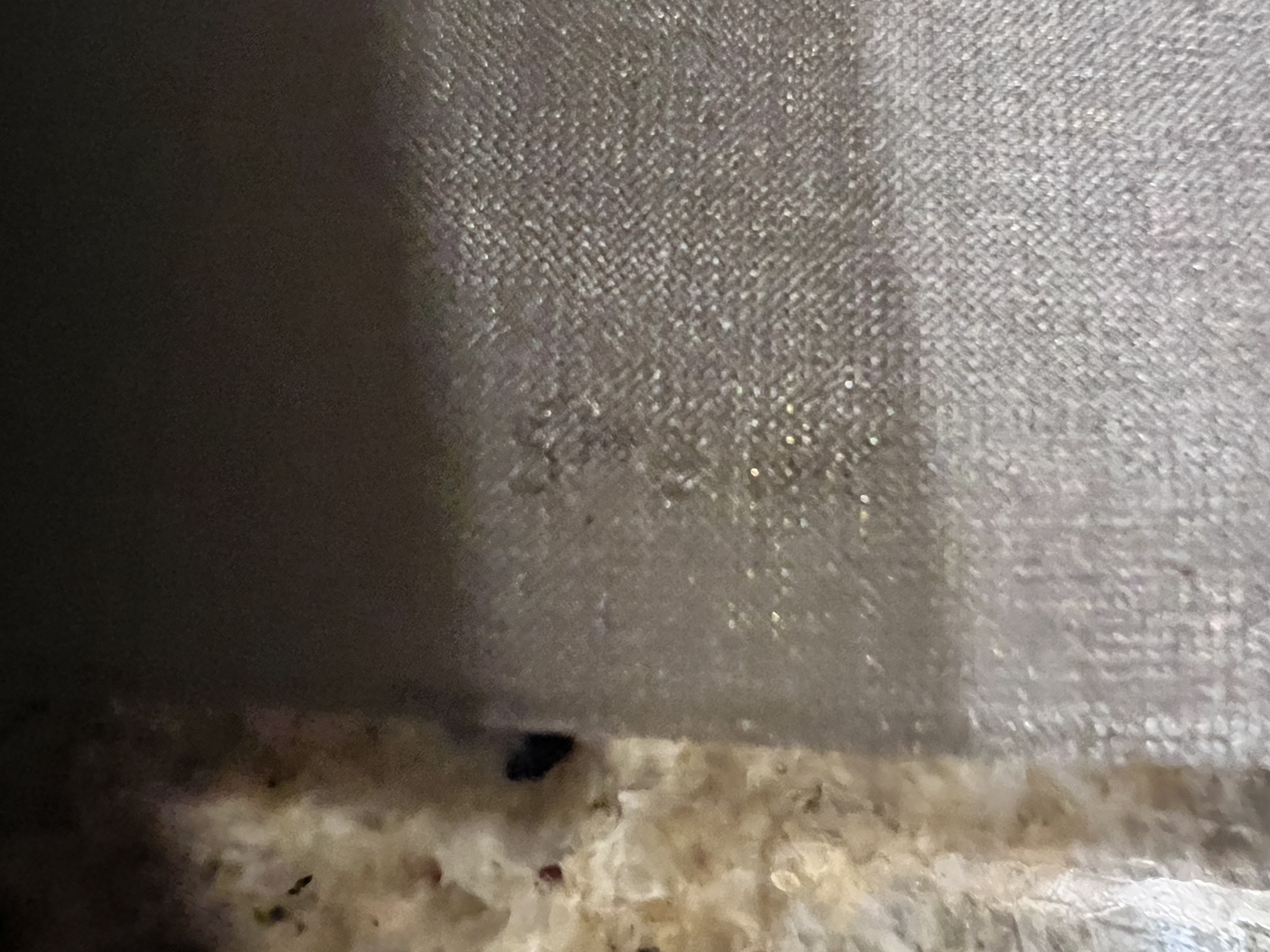

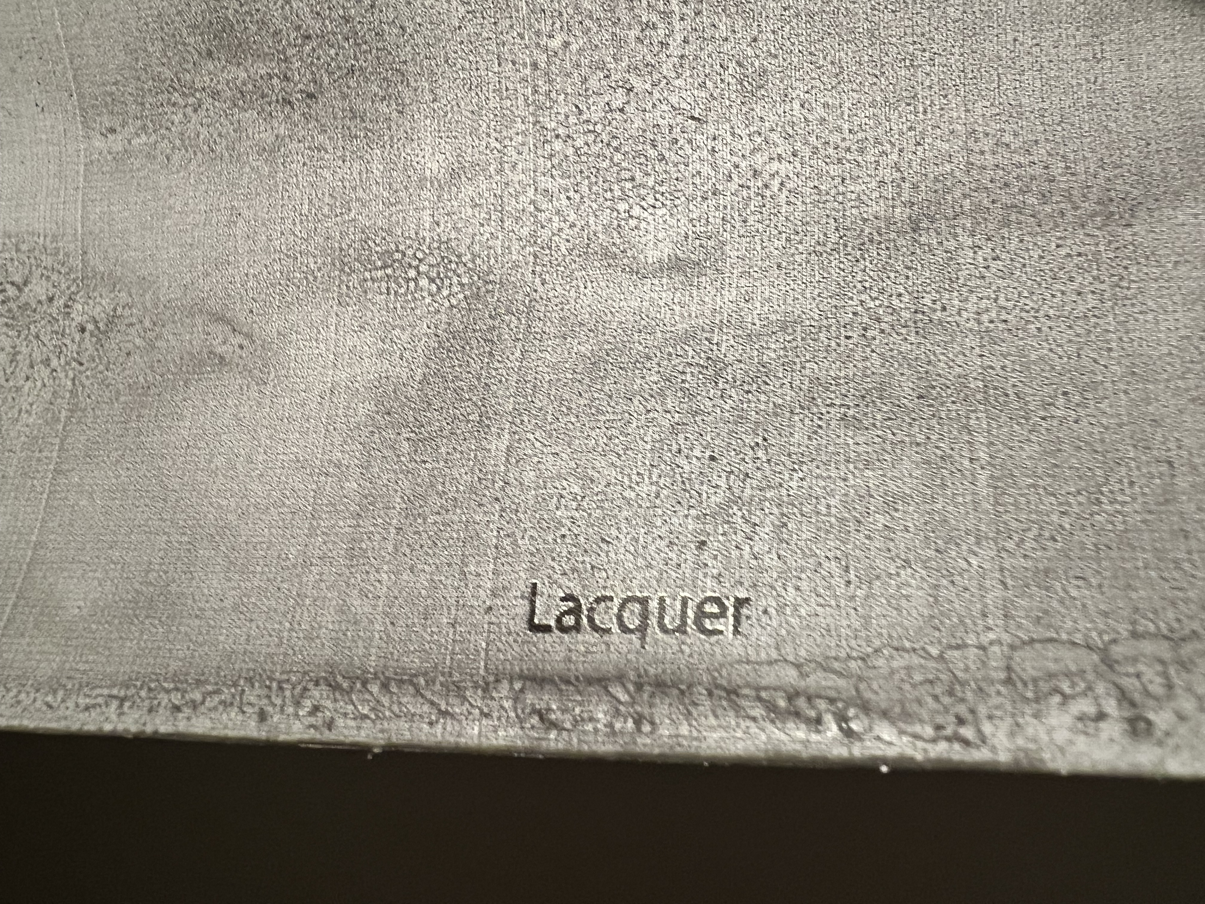

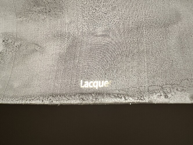

The lacquer had a more even spread without holes with 2 coats each. (though maybe that’s just me)
It burned off the screen with your settings pretty well. I think it will work. I will test a screen print at some point. :slight_smile:
