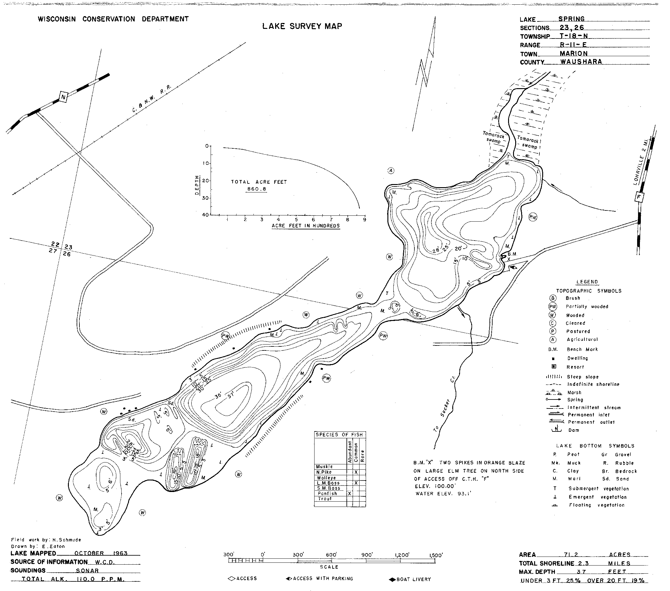

It says maximum depth is only 37 feet.
Yeah, the distortion in depth makes them more impactful.
Yeah depth is definitely not to scale. Otherwise that would be hundreds of feet deep. I believe the first layer is 3 ft deep, then 5-ft intervals up to the deepest I normally use 1/16 inch material, but I didn’t have enough stock and ended up using thicker 1/4-in material, so it does look more dramatic. I suppose it would look more normal on a bigger map cut on a bigger laser. Anybody who drives a boat on that lake will know where the deep spots are anyway.

Could you please share your source of bathymetric data? Is it a local State source, or perhaps NOAA?
(That’s another reason I didn’t post a pic of the one I made - the data is not available except in basic map form, as it is a private community. I had to trace it by hand. It’s actually why I bought a digital tablet to use with my laptop…)
Wisconsin DNR website has maps. I don’t know of any free services that have that data available, so I map the layers using Illustrator. I also use mapbox and google maps to get street level stuff.
Thanks for the info. I find local State resources are better quality and more abundant than national databases.
