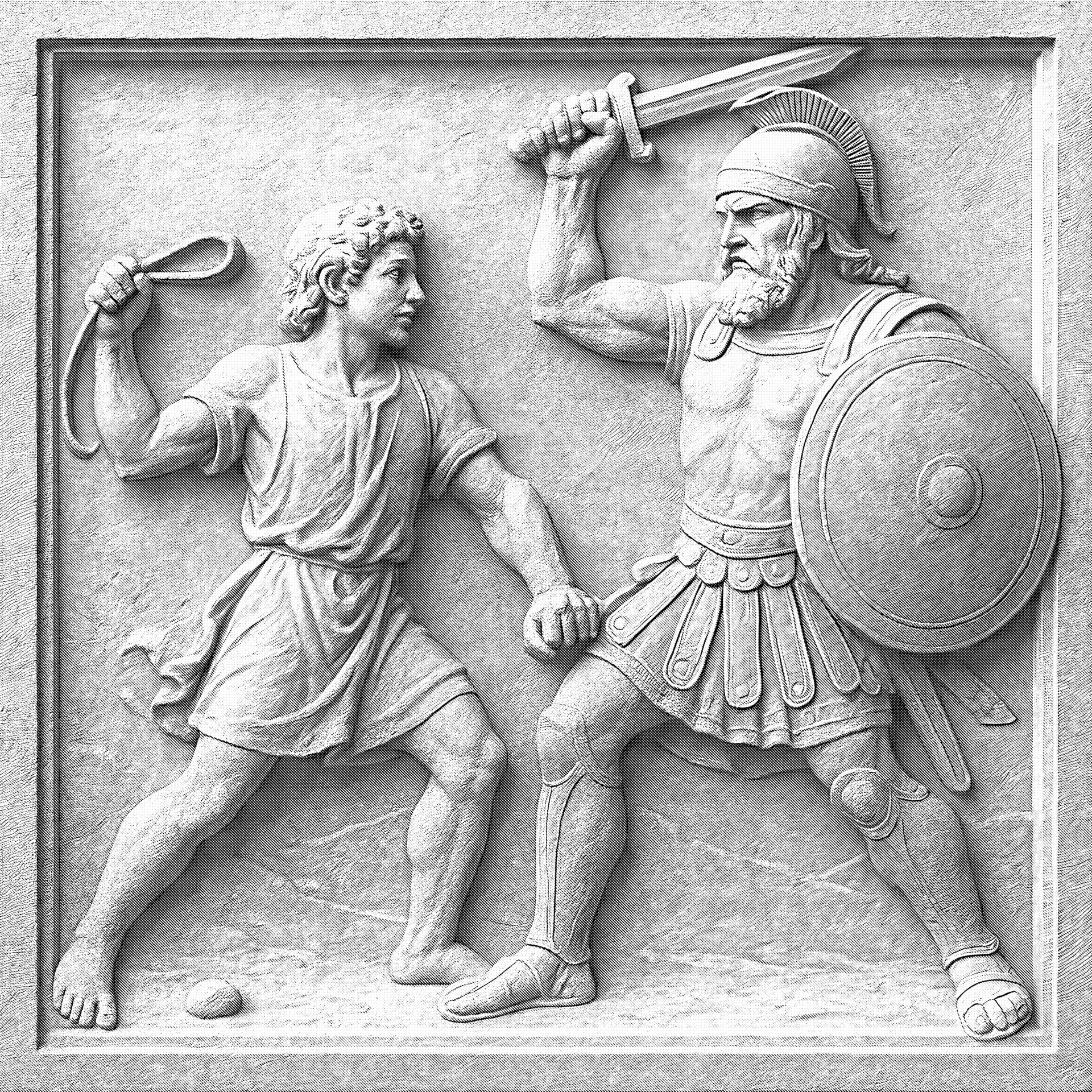

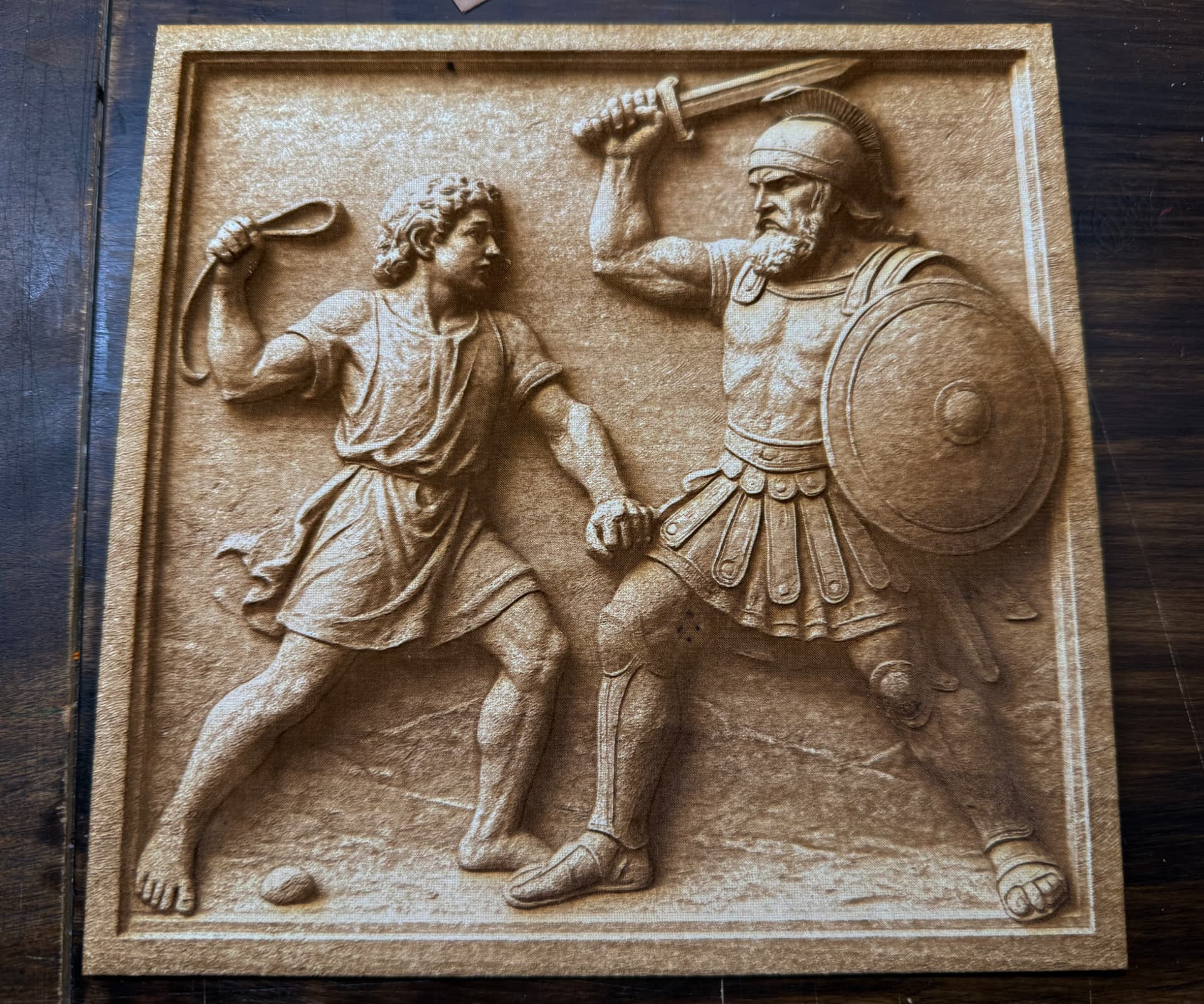

To get pictures like 805LaserSpot makes, simply converting to grayscale isn’t enough. You need to add the shading and shadows that mimic a real 3D engraving, even though you’re not actually doing a 3D engrave, you’re doing a light engrave that adds shading but leaves it flat
That’s hard to do with regular photo tools, but easy with ChatGPT. Just ask for a bas-relief style, like this:
“Visualize as bas-relief: David fights Goliath.”
You can also ask it to convert your own picture to bas-relief. It will do so approximately, not exactly.
“Make this into a photo of a bas-relief”

That is very interesting. A problem with that style is that things visually flat come out curved if deeply engraved. If you can get a grayscale depth map, that things farther away are darker. It would solve that issue. To experiment, there are a lot of such images on the web.
Those are great examples. Bing image creator also does great bas-reliefs and they are free, but you can’t start with an image (at least not right now), you have to describe completely the image. I’ve found that SculptOK converts those to depth maps really well, if 3D engraving is your ultimate goal.

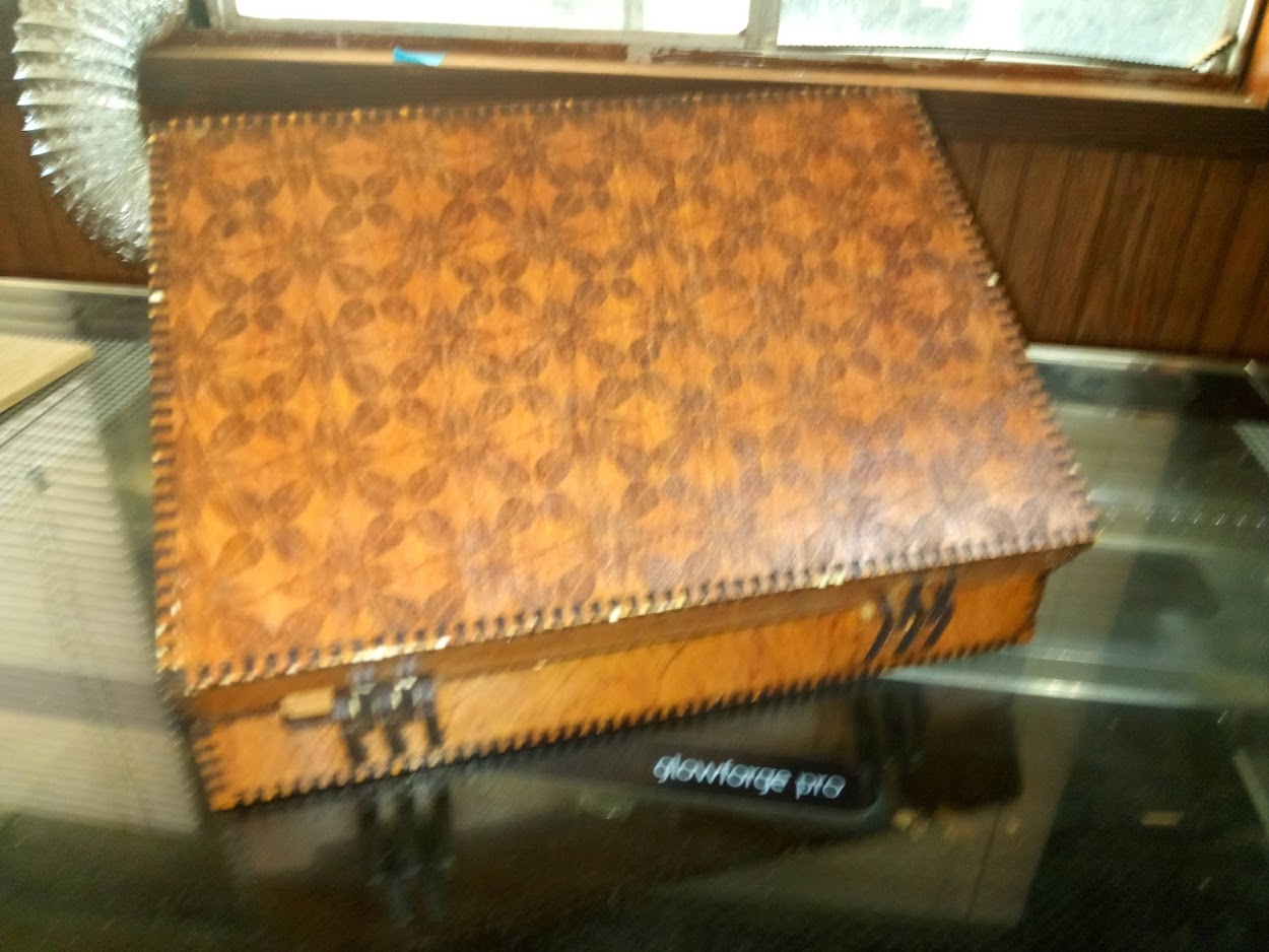

I realize they are not depth maps, but then a full range black and white image cannot be flalt like it was an inkjet print either. I have tried to do that on Luan plywood that the top layer is thin as paper but if thin enough not to go through, it goes to nothing fairly quickly. This is the box for my tablet after a year or so of use…

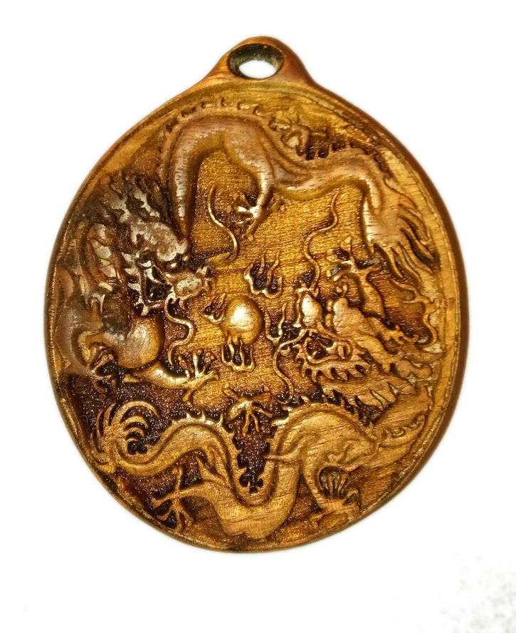

Case in point… lovely depth to this engrave:

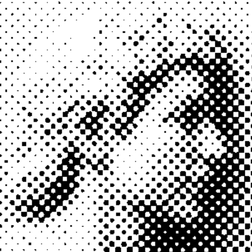

Lots of dithering options:
A. Glowforge’s dithering
B. Halftone filter

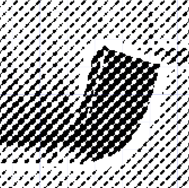

C. 805LaserSpot’s style of dithering I don’t know what tool they used. Notice the aggressive edge enhancement.
C2. My attempt to get something similar to C. (I had to write a script, see below.)
Result:
Glowforge’s dithering was worst. 805LaserSpot’s style (and my imitation) were best, showing detail much better than Halftone. (That might just be that the Halftone grid is a little larger.)
Here’s the best pipeline I’ve come up with in my tiny experiment:
  1. Get your 1024x1024 image from ChatGPT
  2. Use the AI upscaler of your choice to upscale it 4x
  3. Convert to grayscale
  4. Apply an unsharp mask, radius 20, to enhance edges.
  5. Make a “levels” or “curves” adjustment to widen its dynamic range so that it contains both full black and full white.
  6. Apply dithering with a 10px transform matrix designed to produce that linear pattern; maybe a 8px halftone would also work.
  7. Scale it at 540dpi. (For a 4000x4000 image, this makes it around 7.4 inches).
  8. Engrave with the above settings.

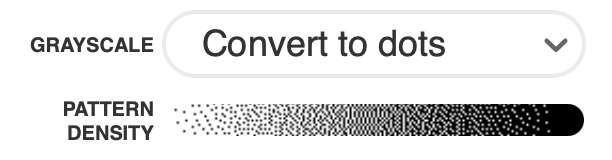

The dithering is interesting but I’m wondering why not just use vary power? I tend to prefer the results aesthetically.
In my own test, that was the worst outcome. So I wonder what factors influence that.
But note that with dithering, coarse dithering larger than the laser beam, you’re at least going to get a linear amount of darkening. (For most dithering patterns.)
That generally won’t be true for the vary power mode; darkening is not a linear function of power.
There are several things there.
  1. There are adjustments on that pattern density line. Initially at each end, you can grab it and move it inward. At the light end you increase the number of dots, getting at least some dots where you have large light areas. Likewise where dots overlap at the dark end one can lessen the effect by moving the dark end toward the middle.
  2. The dot levels commonly used in routine engraving and the impression of time taken tends to skew what is considered extreme. I find that 640 -1355, while taking longer the result is much smoother. This effect is much greater in the dot matrix. This can make it hard to even see the image at the dot level. While the math between DPI and LPI is straightfprward, the result is not. This can be most easily seen at low DPI made into a higher DPI what was a sharp dropoff is greyed so the dropoff is much smoother. I use this effect frequently when creating a vector from pixel image conversion.
Image prep can counter this if you’re using curves. Also I’m not sure you need a linear gradient.
Lasering is an analog process at the end, it’s more akin to photography and traditional development than to digital printing. Trying to be too precise with engraving (or cutting) will make you crazy.
