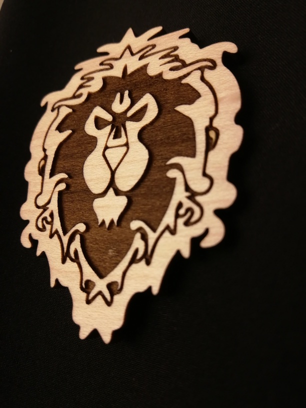

Second cut but first project I designed to make it work:
I was in awe… “I made this?”
