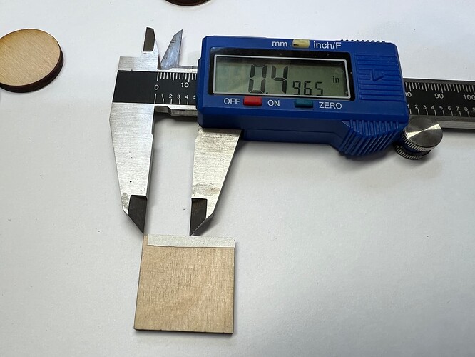

Since this is just a square object, the jig is easy. Carefully measure your object:
Then draw a corresponding square of the same size.

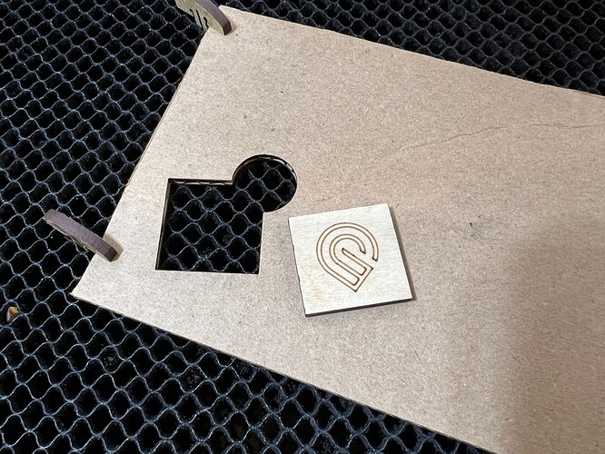

Now that you know how a score jig works, a pocket jig is essentially the same thing, except that we’re cutting a hole for the material to slot into.
Create your jig as described in the score jig section, but add a small cutout in a corner so that you can remove your material when the job is done. I chose a small circle:
And after joining the shapes:
Do the same procedure as before. Put your jig material in place, I used cardboard here. Be sure to secure it, the jig must not move after this point. I used 4 pins to hold my cardboard material in place:
Side note: why is the cardboard inserted off-angle?
With cardboard, the corrugated layer has a direction, and you’re better off cutting across the corrugation so you don’t get a “soft” edge in any one direction. Cutting diagonally like this ensures a strong jig. Other materials like plywoods or MDF don’t have this caveat.
Now, cut the jig shape out of your jig material.
Use a small piece of tape to carefully lift the cutout. Video of removing the cutout this way:
https://www.youtube.com/watch?v=5NjtkDl4Nco
YOINK!
Insert your material:
Complete your job and enjoy the alignment.

Now take your material and measure it carefully. I put a small piece of tape on the edge, so that I can mark it at its midpoint:
A quick pencil slash:
Now cut and score your jig, you’ll end up with something like this:
How well this works depends on how well you measure and place your material against your jig:
That’s pretty good! In practical terms, if you’re working on a large piece this will probably be more than accurate enough.

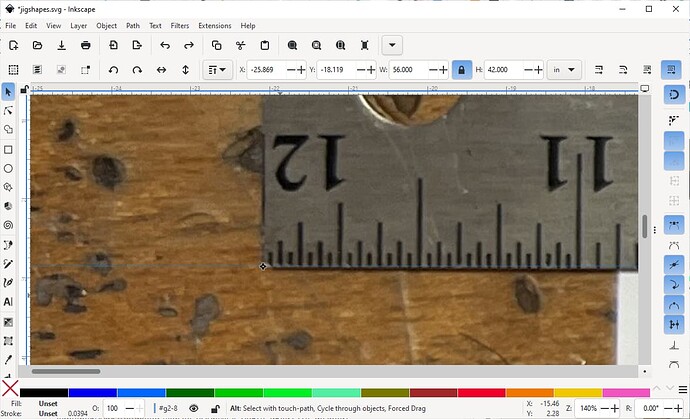

This is a relatively complex workflow, but will work with pretty much any shape. Pictures will help illustrate the idea:
Lay a ruler down next to your item. You’ll use that ruler to scale things in your vector editor. Take your photo with good lighting and as straight and level as you can get it.
This is pretty good, but we’re going for accuracy, so we’ll make sure it’s correct. First we make sure the photo is level.
Place a guide (in Inkscape guides are blue lines by default) on the corner of the ruler, and then move the photo’s rotation point to be on that corner too.
Now go to the other end of the ruler and see how it looks:
You can see that it’s not 100% level, the ruler extends below the light blue guide. Rotate the photo to place that corner of the ruler on the guide:
Now we make sure that the photo is scaled accurately. I make a guide at the left side of the ruler, and then make another 12" to the right. I scale the image until the ruler is as close to exactly 12" as I can get it:
Once I have that I can build a corner jig around my star. I start making guides around the edges of my shape:
