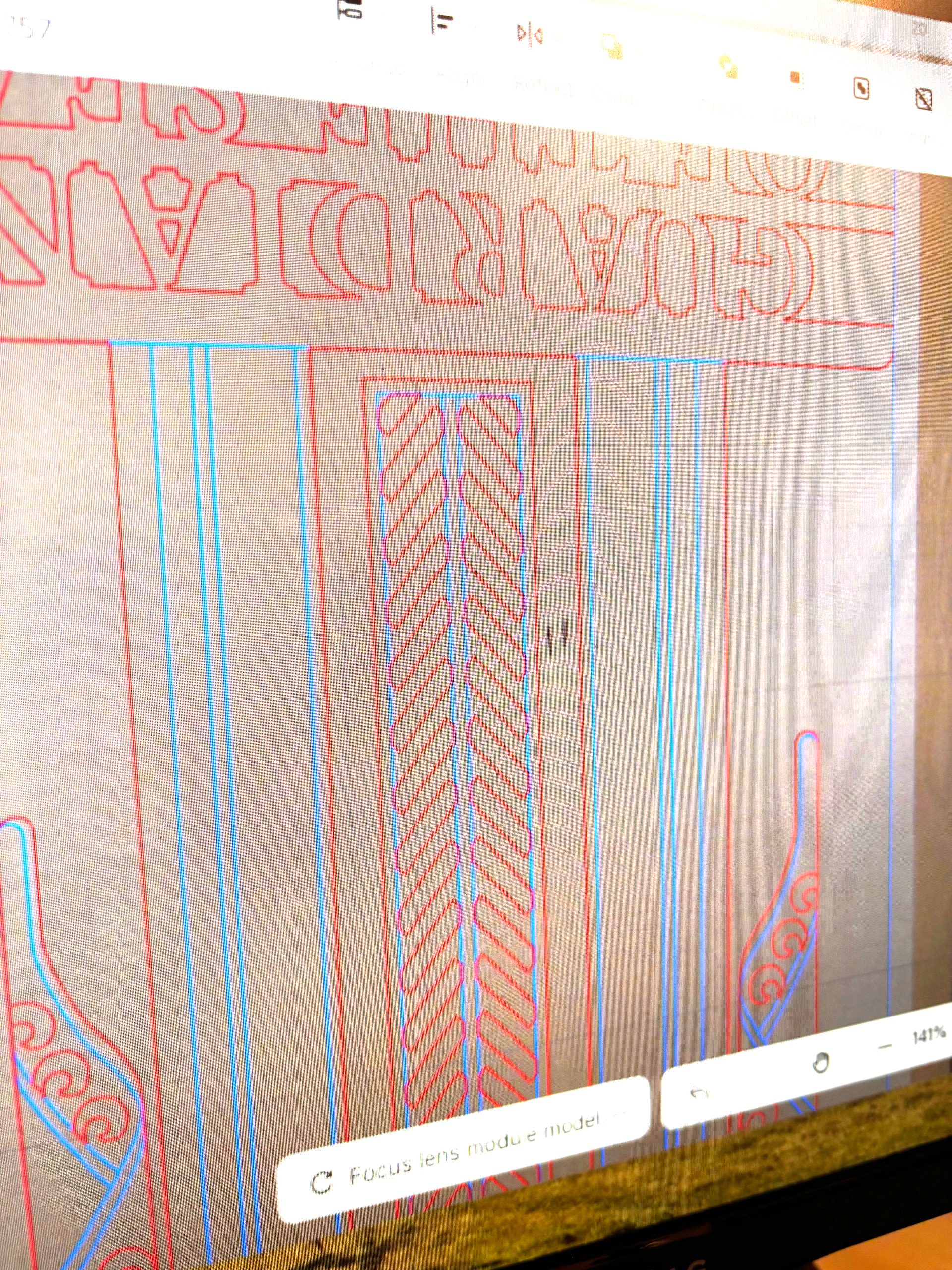

We’re in a sort of funny position; the reason we stay with Glowforge has everything to do with their software platform. We work exclusively with Hawaiian Koa wood sheets, which have a lot of wavy grain patterns and occlusions, so the ability to not only see the wood with the in bed camera, but also position and rotate individual svg files onto the image of the wood - rather than be limited to a single file at a time and only a simple perimeter outline to tell you where it’s going - is what keep us. If there were another laser machine that offered that specific feature, I’d be there in a heartbeat.

When you say they have lid cameras, do they give you the ability to move individual vector files onto the Camera image and rotate/manipulate them the same way the GF app does? That’s the specific feature I’m looking for.

So can you move/rotate/resize vector files on the real-time image of what’s in the bed? That’s the feature I’m most interested in, as we are cutting some very exotic wood sheets which often have small imperfections that have to be worked around.
Yes. If you go to the xtool website and just look at their feature video they clearly show it. It’ll take you five minutes to go look at the product page for the P3 and you will have all the answers you need.
Yes! Here’s an example of something I cut this morning. This is a masked piece of cherry, which always has spots I try to avoid. I marked where the spots were on top of the mask, just so I could see them better. What you see here is a photo of the wood taken by the P3 with my art (blue and red) overlaid. So, I can make sure those marks fall in an area that will be cut away.
