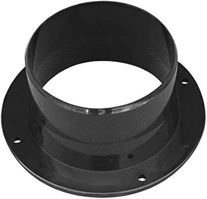

Whats the part number you are using for the attachment on the window/screen?
I have a piece of thick lexan in the window with a 4in hole. The flange is attached to that. The outer edges of the lexan have a rubber gasket to seal out the fumes. Here’s the part:
