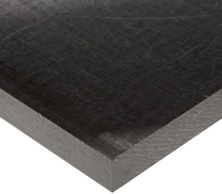

One material I want to vote for you to carry is Delrin sheets. Delrin is relatively hard to find in thin (eg 3mm to 5mm) thicknesses, at least if you want smallish pieces, but much better than acrylic for structural projects (eg robot mechanisms and frames).
Unlike acyrlic it’s feasible to do snap fits etc with it. It’s about equivalent to acrylic for cutting safely (unlike PVC or Polycarbonate…). Generic acetal sheets would be fine too, as long as of good quality.
@michael_mccool
This is where we get our delrin sheets for our CNC.
There are various thickness available. My husband uses 6~10mm thick sheets for 3D Printer parts.
McMaster-Carr also sells Delrin in a wide variety of thicknesses:
They are not always the cheapest, but they are fast, have almost everything in stock, and their shipping prices are pretty reasonable. They also sell a wide variety of other plastics.
