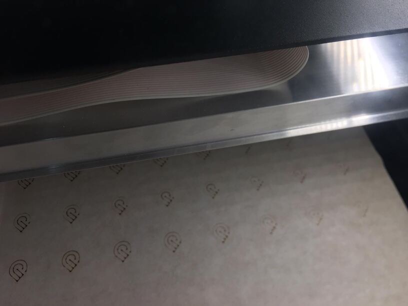

And when i launch the Camera Recalibrator,
It seems can not keep the same power from left to right side.
I use the same setting and power to cut some square on the medium draftboard, the square only can be cut normally on the left side.
What can i do to fix this problem?
Any help is appreciated.

I am sure the crumb tray is perfectly seated, the material is in the same level
The x and y axis can move unobstructed.
That is very strange about my GF, already email to support team but have not get any reply yet.:pensive:
If you go ahead and do a small cut or engrave on the lower right, just one square, does it do correctly?
Can you cut something out, just one small thing on the lower right by itself to establish that it might be a mechanical issue with alignment and co-planar surfaces?

I have use the same patten to cut on the right side, still can not cut thoroughly
So, as a general rule, the beam isn’t really going to lose energy over a distance like this. Either the energy gets eaten up/absorbed by something in the beam path, or the energy is delivered into a larger area, so it has less of an impact on the material (focus).
I would check all of the optics (two windows and the lens) and remove the top of the head (it’s magnetic) to make sure the mirror is seated properly and not damaged.
I would also take the crumbtray out and put it on a flat surface and see if you have some kind of deformity/manufacturing error.
And if I didn’t find anything there, I would put it back in, and using calipers, I would measure the distance from the bottom of the head down to the crumbtray surface and make sure it’s within a few thousandths of an inch at all corners.
