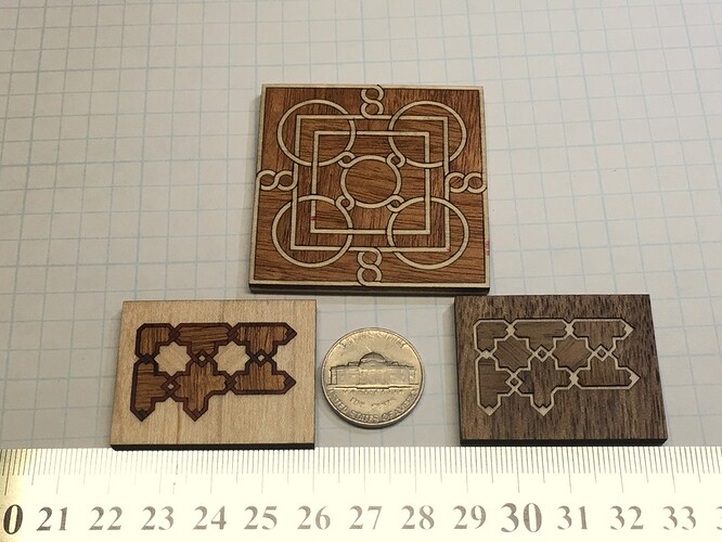

I posted this ages ago, about the limits of inlay in the glowforge. this was right around when clean corners was new, so some possibilities were opened up to us at that point. This is all through-hole inlay, as I’ve said I tend to prefer through-hole because engraving takes so long.
This will change the game on inlay.
So I finally got around to a solid inlay test.
I’ve always shied away from harsh corners and too-fine inlay designs because of overburn. The clean corners did indeed change the game and I got excellent results with 1/8” through-cut inlay. These sorts of results were possible before only with pocket engraving for veneer and then it was dicey.
Anyway, here are the pics:
These are small tests of two quick and dirty designs. The bottom two are all 90 degree corners, designed as a border that can tile to make a rectangular outline to anything.
(Various materials)
You can see the sharpness of the corners is very well preserved with almost no pitting. There are some defects, but that’s because the material has an open grain. (Padauk). The maple surround is far more representative of a tight-grained material and has almost no pitting.
(Maple, Mahogany, Padauk)
When you have two wood samples with different thicknesses, you can make this cool effect where the maple is “sunken”. It’s really interesting in person.
(Maple, walnut)
The red bits are where magic marker bled through my masking. I wish someone made colored masking so that it’s easy to tell the difference between front and back on pieces like this. I should have sanded it more aggressively to get the smoke residue fully off the maple, but this is just a test so I didn’t go too far in the finishing process. The maple itself has a fairly strong grain (same stuff as I used in my grateful dead box), so the lines were never going to be featureless white anyway.
(Mahogany, maple)
You can really see the context of the scale I’m working at here. The traces are about a mm in the deco-inspired top piece, and a bit less in the islamic-inspired border.
(Various materials)
So, yes, with inlay and clean corners, things that were off limits before are now feasible.
