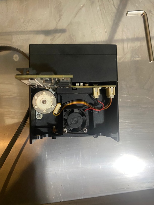

I keep getting the air assist fan error stating it isn’t running at the proper speed - though it is cleaned & the fan rotates smoothly when turned.
I see no damage/melting or build up either.
I do not use magnets, though I have in the past with no issues.
I’m at a loss as to what to do next.

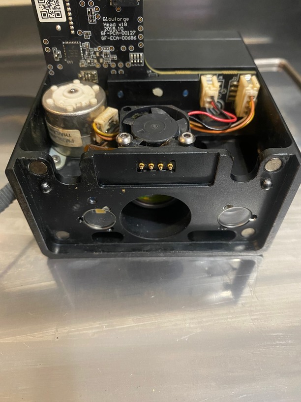

Looks like the contacts might need to be cleaned. Use a pencil eraser to clean the four square contacts
I think my thumb smudged it before this photo - but it still gave me the error after cleaning those little squares
The pictures are helpful! I have had the exact same thing. Here is your issue:
Your trace right to the left is lifted. It will cause the fan speed issue. It is the trace that is carrying the signal from the carriage plate pads :frowning: I opted for a replacement print head. There are some options to fix it your self but its a bit of a task.
Oh no! I didn’t even catch this! good eye! What is the cost of a replacement print head?
It use to be 650 but they took off 200 if you sent back your print head. I have heard lately it is 650 and you have to send back your print head :frowning:
