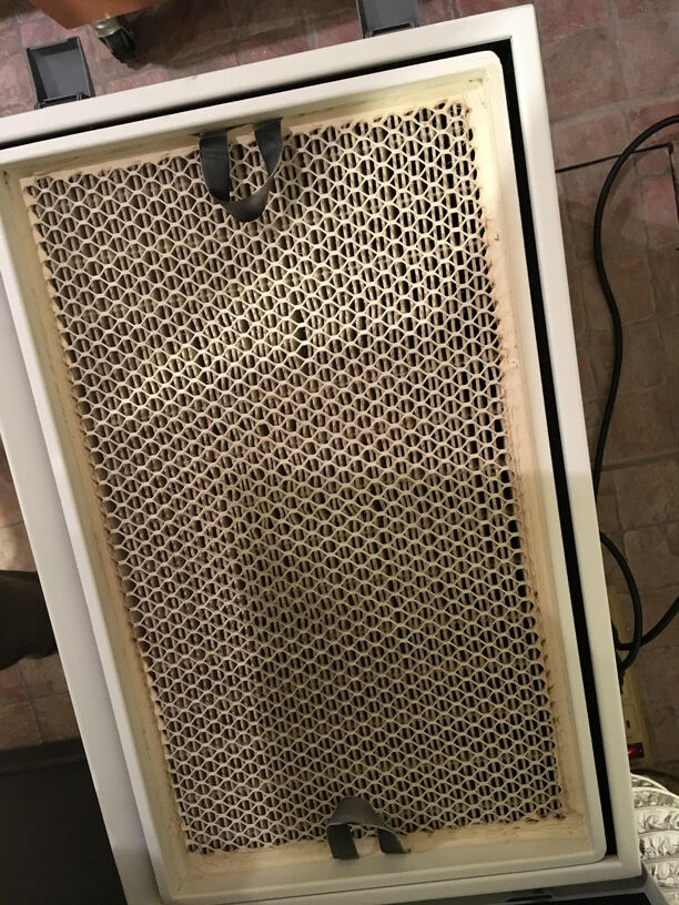

I think mine is up for replacement, right?
. I guess it helped but I didn’t expect it fill up that fast.
It will need to be replaced when dialing the speed all the way up still allows wisps of smoke to seep out from the lid and it fails to draw the smoke out of the machine.
Don’t cut draftboard using the filter. It clogs it quickly and you’ll need to replace the cartridge.
