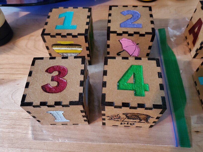

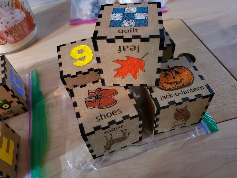

As a gift for a friend’s first grandchild, I made her alphabet blocks. I had so much fun making these and painting them!
Assembled and treated with a coat of food-grade butcher block conditioner, I had them sitting on plastic bags while the conditioner absorbed.

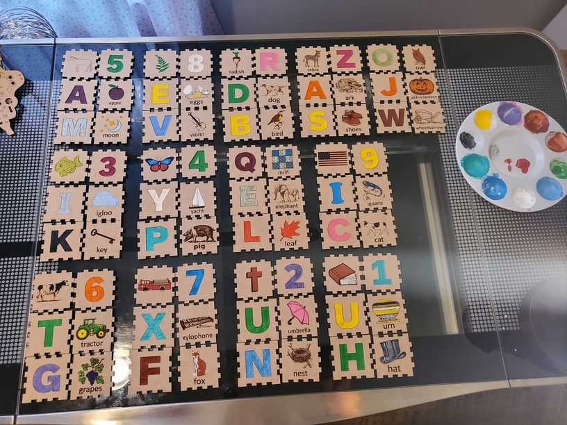

Nice work. Did you paint them while they were still masked? If not you have a very steady hand.
Yes, for the most part. Some things had to be painted after removing the masking, and yes, those did require a steady hand. Plus a level of tolerance to embrace the imperfections. Kept reminding myself these are toys to be played with, not showpieces. I left a few graphics entirely unpainted. My goal was to leave one or two per block unpainted, but the painting was so much fun that I kept going! And thank you.
Pretty cool! urn is better than undertaker for the letter U. :slight_smile:
This is a beautiful gift. Did you decide on all of the images for all of the letters, or did you look at other sets?
Agreed! And I desperately wanted an X that wasn’t x-ray or xylophone, but alas, it wasn’t to be…
Thank you. I chose the images. Most of them are freebies from open source (non-copyrighted) sites. I don’t think I purchased any of them. And sometimes I found out that the way they had been created was a pain to edit and achieve the print I was looking for. So a few graphics were scrapped and replaced with less high-maintenance files.

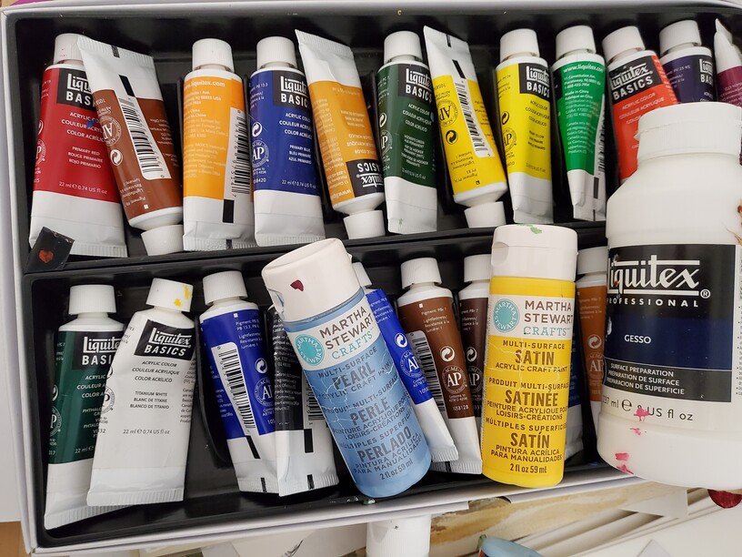

Nice! What did you use for paint/coloring? So glossy!
Liquitex acrylics with a couple of Martha Stewart craft paints thrown in. The pearly blue MS paint was great to mix in and create shimmery colors. It made a really nice silver to use on the moon.

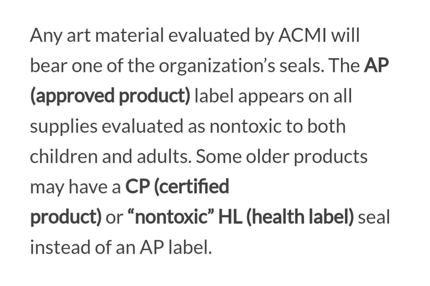

Thanks. The colors look great. Are they child/nontoxic?
Yes, they are non-toxic. It took me bit to find the actual language I was looking for. When evaluating paints, look for the “AP” label and the statement that the product conforms to “ASTM D 4236.” The 4236 regulation just indicates that the packaging has properly identified all hazardous materials. The “AP” is the indication that it is an “approved product” and therefore non-toxic.
The AP is visible on a few of the tubes of paint in my photo. Thanks for asking the question…it’s an important consideration.

Where would I find the pattern for the basic blank blocks. I would like to do my own letters and words.
I used boxes.py to create a simple 2x2 closed box. Would enjoy seeing photos of your creations. Have fun with it!
