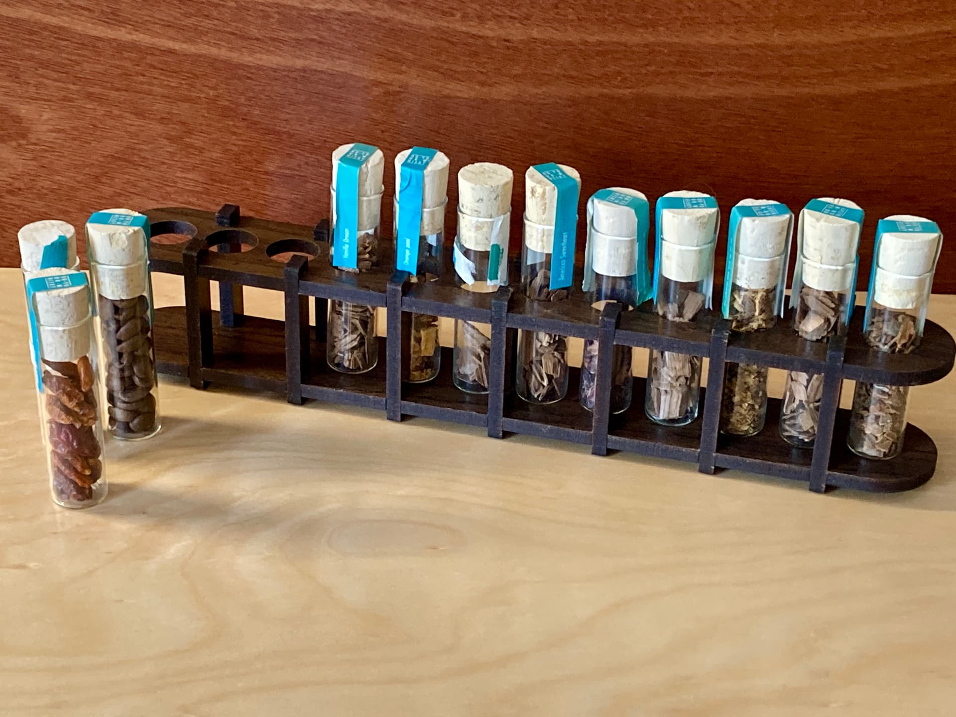

I made a customizable propagation rack on Cuttle (requires a subscription) that you could adapt.
I used it to make a holder for my additives for diy bourbon.
I designed the piece for the specific case, and then put it up as my first design to go into the catalog. The first thing I did was array the vertical pieces at one inch plus a thickness, modify the two end pieces, then did the back bottom and front. I also modified the middle for a central support for multiple layers, but never actually built one.
If you wanted to change the width it would not be difficult to recreate the design at the new width.
