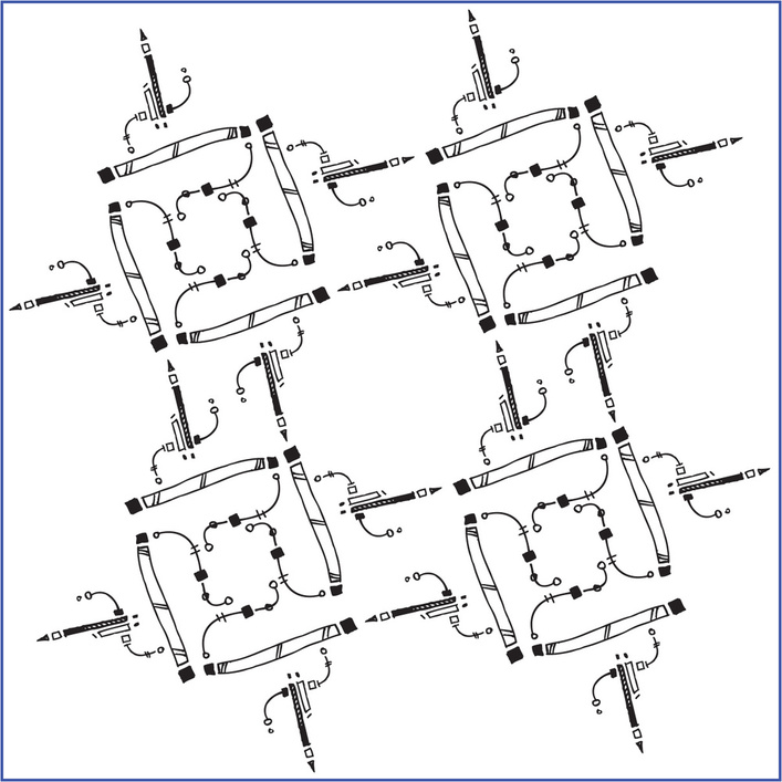

I am trying to run the attached SVG.
When I click print it scans and then goes to the white screen with preparing your design.
After a wait of a about 5 minutes (I did not time it exactly) it simply returns to the artwork screen. No message, no indication of a problem.

I am able to upload them to the app. The problem seems to be that if I use too high of a LPI setting the print fails silently.
Upload the PNG file to the app.
Use manual engrave settings of speed 100/full power/1350 LPI (or anything higher then 125)
Click print
The print dialog comes up and then sits there for a very long time. At some point the print dialog just goes away. No message. No error. No feedback as to why.
I’m so sorry I misunderstood. Thank you for clarifying.
As you suspected, the print is failing because the high LPI is making the print time too long.
We are looking into why you didn’t get an error message. I’m going to close this topic, but please feel free to post a new topic if you see this again or have any other questions.
