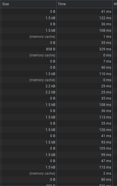

Most of the app performance is not likely to be affected by how “big” the servers are. You can do the experiment: load up a design in the app and disconnect your Internet. You can still move elements around, flip things, resize, etc. Almost all of the work is happening on your computer, and when it goes back to the server it’s generally making small requests in the background (notice how even if you try to do something you can’t do offline, like add a new object, everything else keeps working).
I think we’ve seen a few people run into local app performance issues that got better after clearing their browser cache. If it suddenly started getting slow for me, that’s probably the first thing I’d try. If you’re a little more nerdy, you can observe the network requests in your browser’s web inspector as you tootle around in the app and see if anything looks to be taking an unreasonable amount of time. But again, I’m making some assumptions about what type of slowness you’re experiencing.
The app does not depend on an internet connection once a design is loaded, until you go to print. Nothing to do with servers unfortunately.
One of my most complex files showing UI performance with internet connection disabled:
