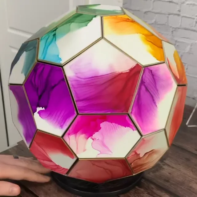

Crystal’s Rainbow Polyhedral
12 Pentagons and 30 Hexagons
58% in between a icosidodecahedron and a Rhombic Triacontahedron.

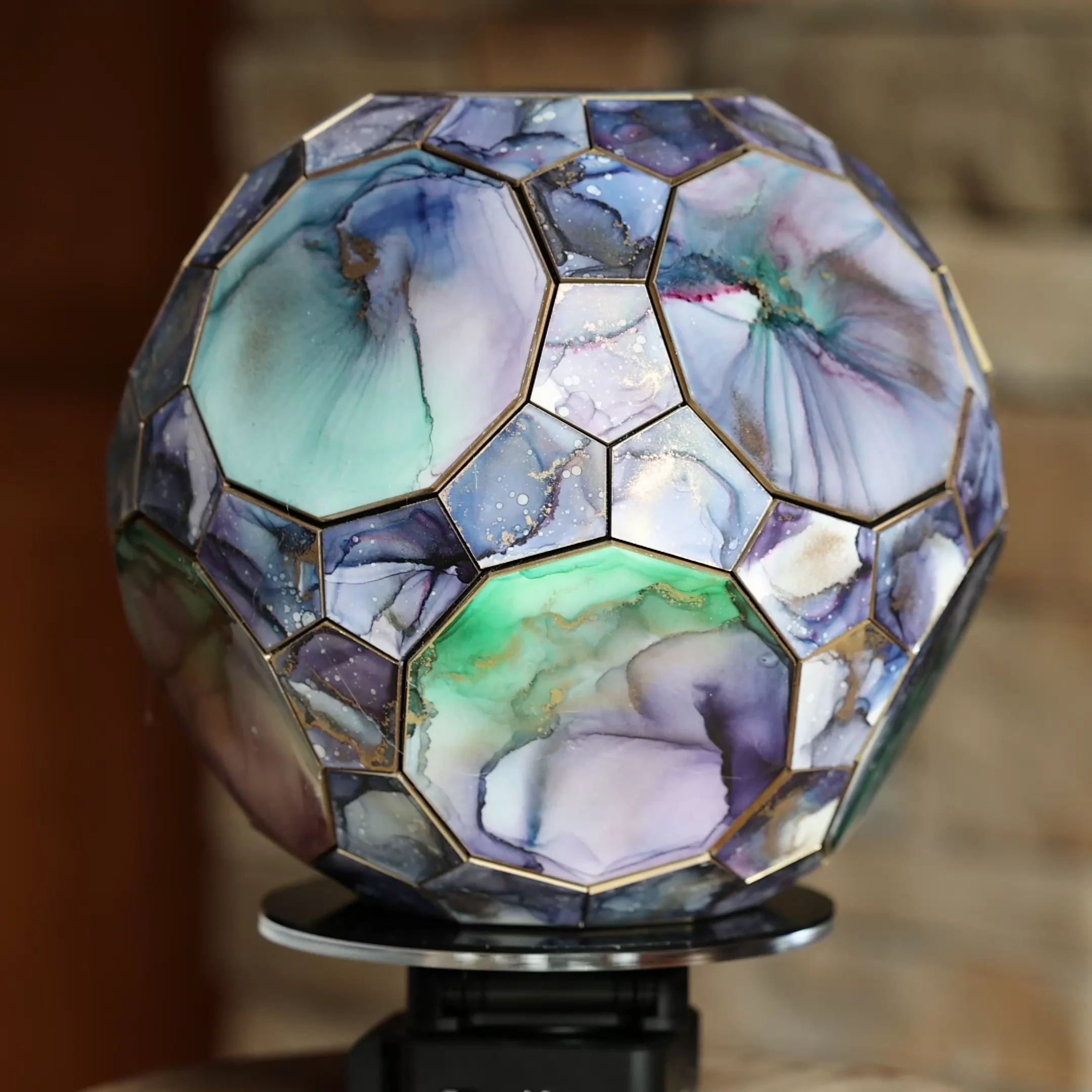

Mike’s Galaxy Polyhedral
12 Decagons and 60 Pentagons
57.4% in between a Truncated Dodecahedron and a Triakisicosahedron.

When I saw the rainbows I initially thought you’d done the slow-flowing sand…and now I want to see something with slow-flowing sand, but it would have to be in constant motion or everything would just settle toward the bottom :stuck_out_tongue:

The Galaxy rotating vid made it look like a gem-quality fancy cut/polished agate. The large plates looked like portals to a mysterious place. That’s some seriously impressive work by both artists.

These are actually all just white acrylic pieces on top that I cut with my Glowforge, painted and sealed, then did a resin top coat on the larger faces to create some visual interest (and make the gold pop). It was a really fun collab! :slight_smile:
