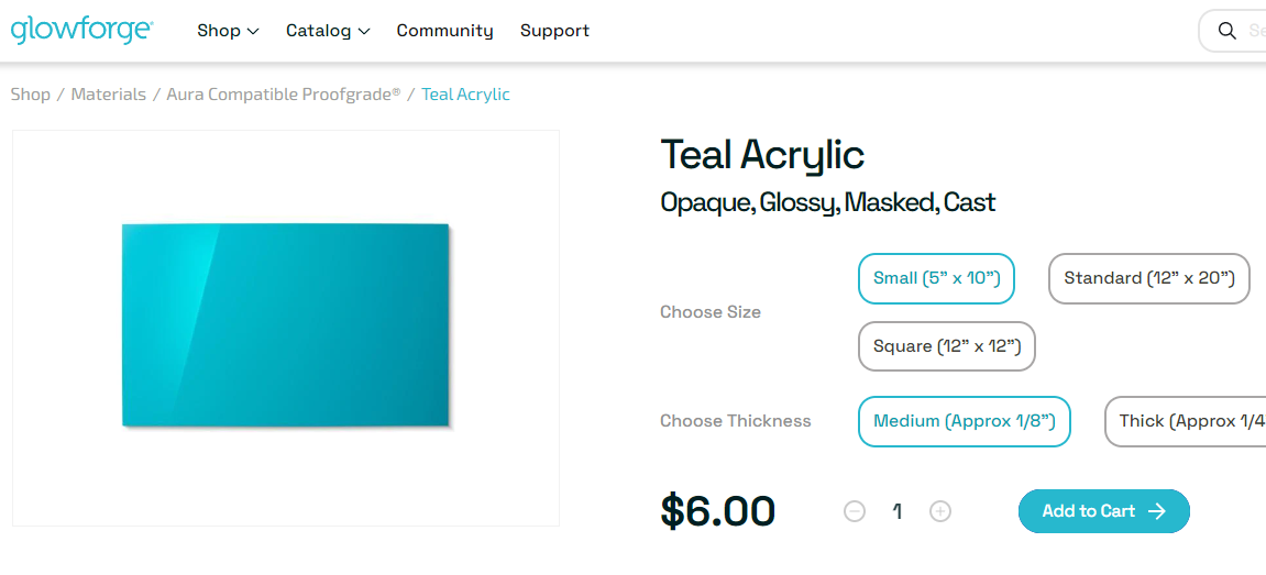

Thats a shame because their own site shows this
