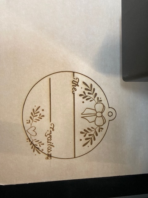

I just received my replacement "refurbished Glowforge Pro. There is a bubbling sound in the reservoir and very low fluid. The laser tube has small bubbles (after initial start up). Picture one shows a already cut ornament in the upper left, and where i attempted to burn the second in the same place. The machine burned it on the opposite side of the board. The second picture shows how the print came out. Any suggestions?

If you search “unicorn tears” you will find someone who may be able to help you round some fluid up (unless it’s still under warrantee?). As for the artwork switching sides that is odd behavior. I don’t have any idea what may have caused that.

Regarding the placement of your design, I don’t doubt what you’re saying, but if it happened to me, my first thought would be user error… somehow. :face_with_raised_eyebrow:
