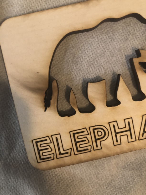

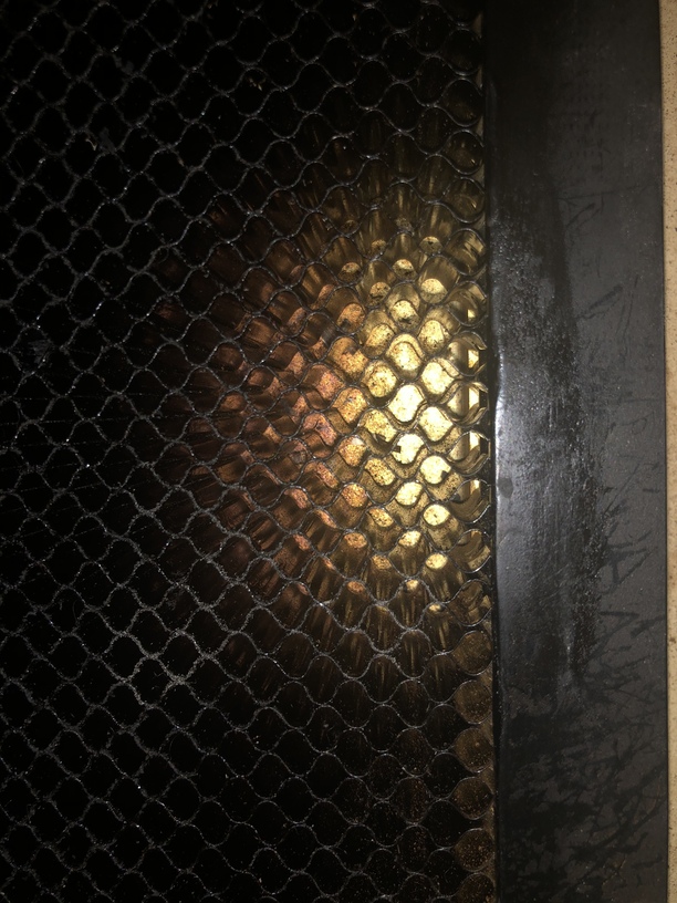

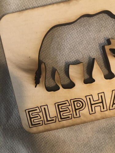

I changed the belt and pulley on my GF but something is happening when I try to cut. It looks like the bed is burning and bending on the sides and there’s a ton of soot both on the projects and the bed. Nothing is catching, I’ve been watching and it’s not getting the orange light. I’ve cleaned the fans. Any ideas? Did I put the belt on wrong?
Possibly - can you post pictures of the belt and the head?

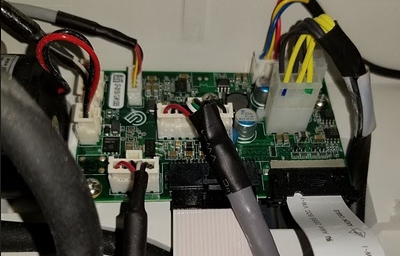

  8. Reach over the laser arm, and to the left of the inside of the unit and you’ll see this circuit board:
  9. Take a photo of this board.
  10. Turn your Glowforge back on.
  11. Post the photos you took in step 4 and step 9 here, or email them to us at support@glowforge.com.
