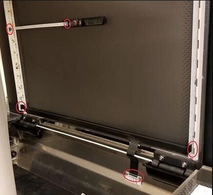

Opened and closed clips. Cable is totally glued down till it reaches the clips (2018 version, laser tube still fine). So I cannot completely take the ends out of the clips without further damaging the cable (shoudn’t matter anymore anyways). The ends look perfectly in place by the way.
Now I want to order a new cable, but GF only ships to Canada and US. I am living in Europe, Netherlands.

You may have already visited the Help and Learning Center page for this issue: Lid Camera Didn't Take a Picture but I’m mentioning it here just in case.
Support may ask for close up photos of the 5 connections for the black and white lid cables highlighted in the reference image attached to this message:
