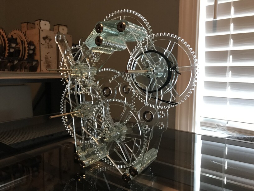

After hours of frustration and reprinting pieces, I finally go this clock together. I am amazed at the lack of friction compared to the wooden version. I knew it would have less friction, but this is incredible.
I am trying to simplify the assembly, but still keep the frame reliable. I doubt this will be the final version, because I already see room for improvements and the clock isn’t fully assembled yet.
What is still left:
Trimming the brass rods (And figure out how to hold them in the frame – currently just held with tape.)
New pendulum design (Which already needs to be adjusted, because I realized it was not balanced. At least I noticed before I cut it out.)
The weight (Currently a 2 lb. bottle of water… yeah, still no inspiration there… but something out of this acrylic would be really nice!)
The reduction in friction will likely allow for a smaller weight (or a pulley system to all for longer run time).

I did early on, before I knew as much as I do now… I was originally using a more “saw tooth” profile, but switched to my current profile for a couple reasons. The first reason was purely cosmetic; I simply preferred the aesthetics this profile, but then I continued with it because I realized that it gave me a wider range variance with the distance between the gears.
This variance is still quite small, but it can be used to account for minor axle shifting.
I should probably look at different tooth profiles again, now that I know and have experienced so much more.
