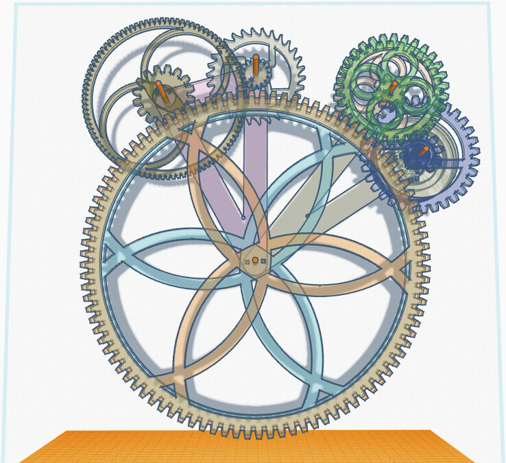

My plan is to make it out of clear acrylic again, and have the face and hands opaque.
If I move the smaller outer gears together, I think the frame could be much smaller too. :thinking: I might center the pendulum in the back and go a little more traditional with this one? (But if I did that I would want the pendulum arm transparent too…)
I like where this one is going, but I hope the theory works in practice.
That would set back the enjoyment of all those inner supports that would be hidden by the opaque face. I was seeing them interacting with each other in the different colors (and trying to figure how to employ LEDs without fancy elec-tricks)
I have been looking for a location to place the drive gear and gear down from the minute hand. The I noticed that I already have a gear-down for the hour-gear. Would I be crazy to attach the drive into that gear chain? It is already accessible and reducing rotations, and then I wouldn’t have to introduce another compound-gear-assembly to the chain.
But I still need an easy way to set the time on the clock and that could complicate that…
I might try it anyway.
With the drive attached here the drum should rotate 9.6 times in 12 hours. I am not sure if that would generate enough torque to keep the pendulum swinging?
But it would also be all acrylic wheels and all axles would be brass, so I hope to have very little friction (lost power).
I am also playing with an idea of a modular frame. So that I might be able to tweak parts of the frame instead of the whole frame.
I have been looking at using the brass rods to hold the frame together also. Does anyone think it would cause an issue if I fixed the rod into the frame? The wheels are already designed to spin on the rods (not fixed to the rods).
I am looking at using a die and cast set to thread the rods and possible set them directly into the frames.

The minute gear actually makes a full rotation once an hour, so it would only be 12 times the length, not 60. But yes, that is exactly what I am talking about. I checked the gear ratios and if I attached it inside the existing gear-down, I would only go from 12 rotations in 12 hours to 9.8 rotations in 12 hours.
I think I just need to see how much friction is reduced by removing the last non-brass axles. Until then I really don’t know how much I can reduce the torque to gain run-time.
Also, to allow for a shorter pendulum, I am planning a 72 tick per minute ratio instead of the 60 tick per minute expectation from the last design.

I may also tweak my existing design to use the 72 tpm (ticks-per-minute) as I have been running some tests and seems to stay running when set at that faster speed. That does not say it would still work with the gear adjusted or not, but I might still try?
I was reviewing my gear ratios on the clock (in preparation for adjusting them) and I noticed they are off! My clock is running 14% faster than it should be! That is probably my biggest issue with it, so if I can resolve it, I may be able to salvage my design.
(Two of my gears have 60 teeth when they should really have 64 teeth.)

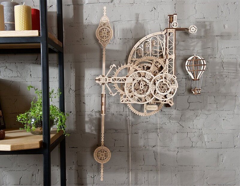

I know there are many kits. But, I did not want a kit; I wanted to make my own and share it with the community.
I like how they used a compound-pendulum off to the side like I do though!
I have seen many kits, but that was not one of them. Thanks for sharing!
Well, I tried designing a gear with 64 teeth and made it the size of the existing 60 tooth gear. I was hoping they would be close enough that it would work, and it did, at first. But now the clock is not working well at all.
I am afraid I need to fix this with a redesign of the gear-train that will result in a shifting of the frame also.
