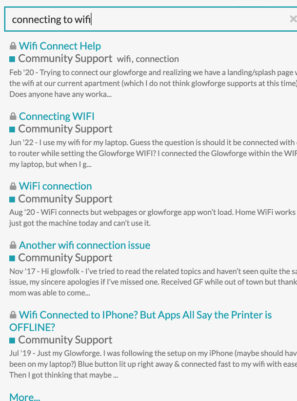

Welcome to the community. Wifi on the Glowforge is picky. My best suggestion would be to do a search…lots of posts…lots of suggestions.

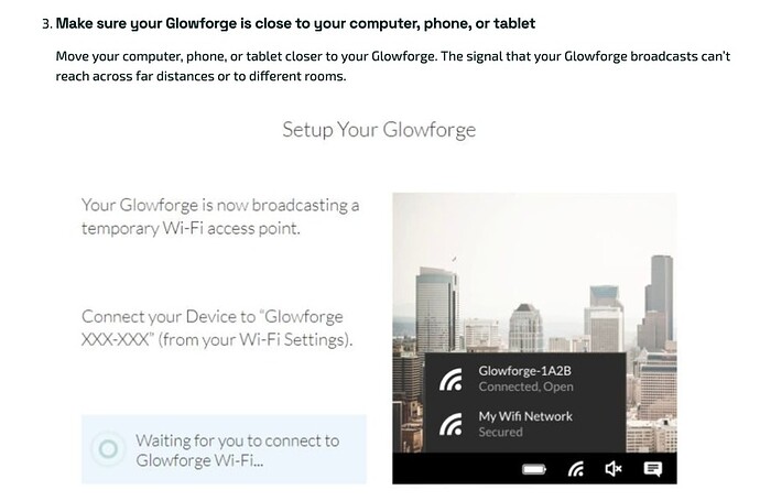

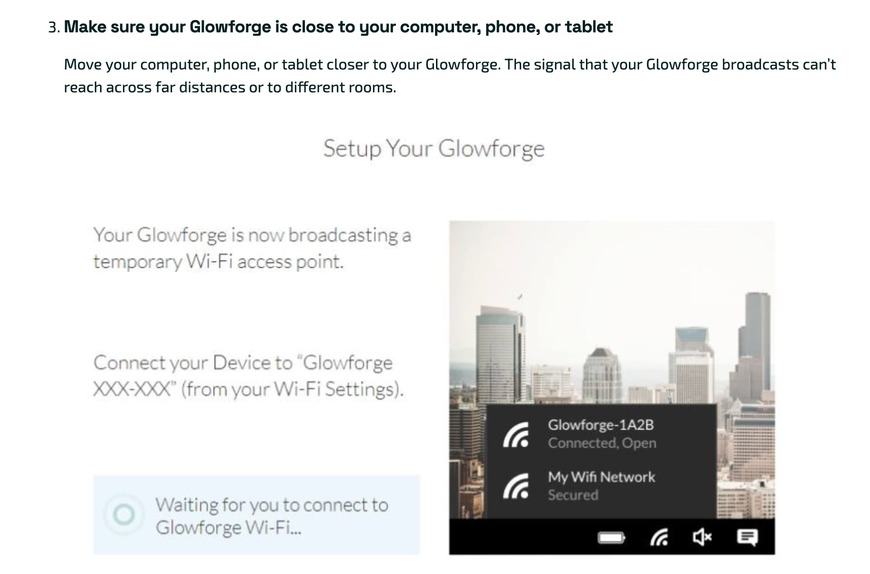

it will get to the point of asking to connect to wifi and i switch to the glowforge temp. one and it stall out there. my computer shows it as open and no internet connection
Are you at this step when things stop?
Yes
Have you tried all of the steps here? https://support.glowforge.com/hc/en-us/articles/360033633634#cant-get-to-app.glowforge.com/setup
Yes
