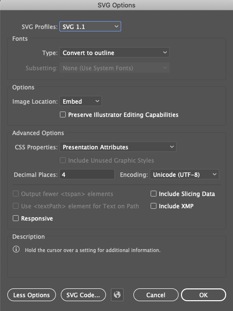

I dont know if it is a GF software problem, but I have SVG files that are correctly sized, then when I import them into GF to cut, they have shrunk an inch each side. Cant figure out why it does this or if something I need to do in AI or what
When you export to an SVG look at the box that says “responsive”. I believe it should not be check marked. I may have it backwards, but it is probably that.
These are the trouble-free output settings I use with “Save As”
Might want to start saving as PDF as well. I haven’t heard of any issues with PDF files. Though I personally have never had issues with SVGs as well and the settings mentioned by others should work just fine.

Thanks a bunch! I was having the same problem and this solved it for me.
oh good, glad I could help
