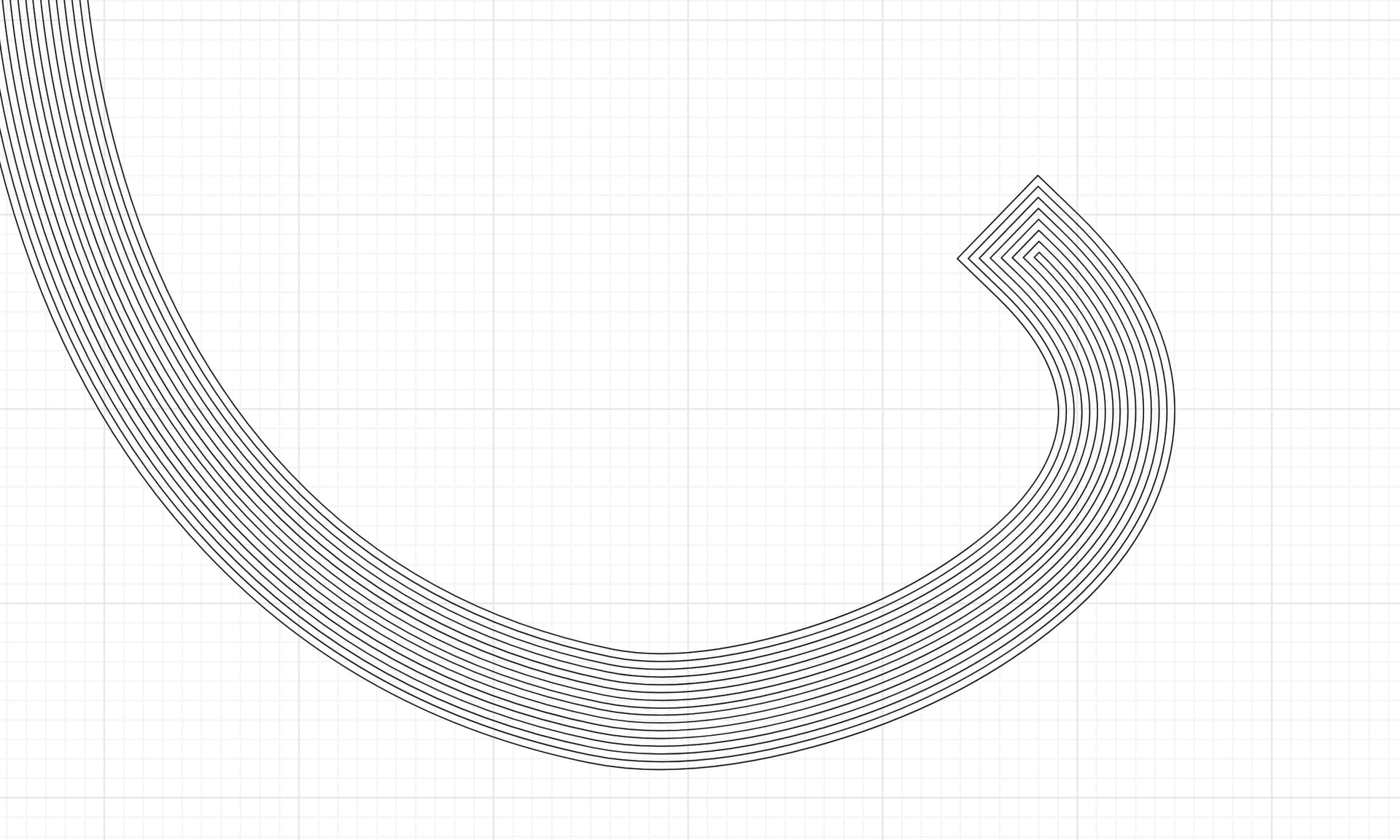

I was able to get the spiral to work in Cuttle.
Slick but not apples to apples. Your end cap style is more akin to “square” in Inkscape where the end expands with the stroke. Also you expand the original stroke, I do not. Original path is unchanged in my version and it’s expanded outward.
Your version does seem to handle the tight corners better, which is nice.
OK new version of the plugin is out now. I’ll update the original post to include it.
At this time I don’t see a good way around the “additional data” message. It can be safely ignored in windows. Thanks to @deirdrebeth for the testing, I updated the stroke width to change with the LPI, should be more consistently visible now.

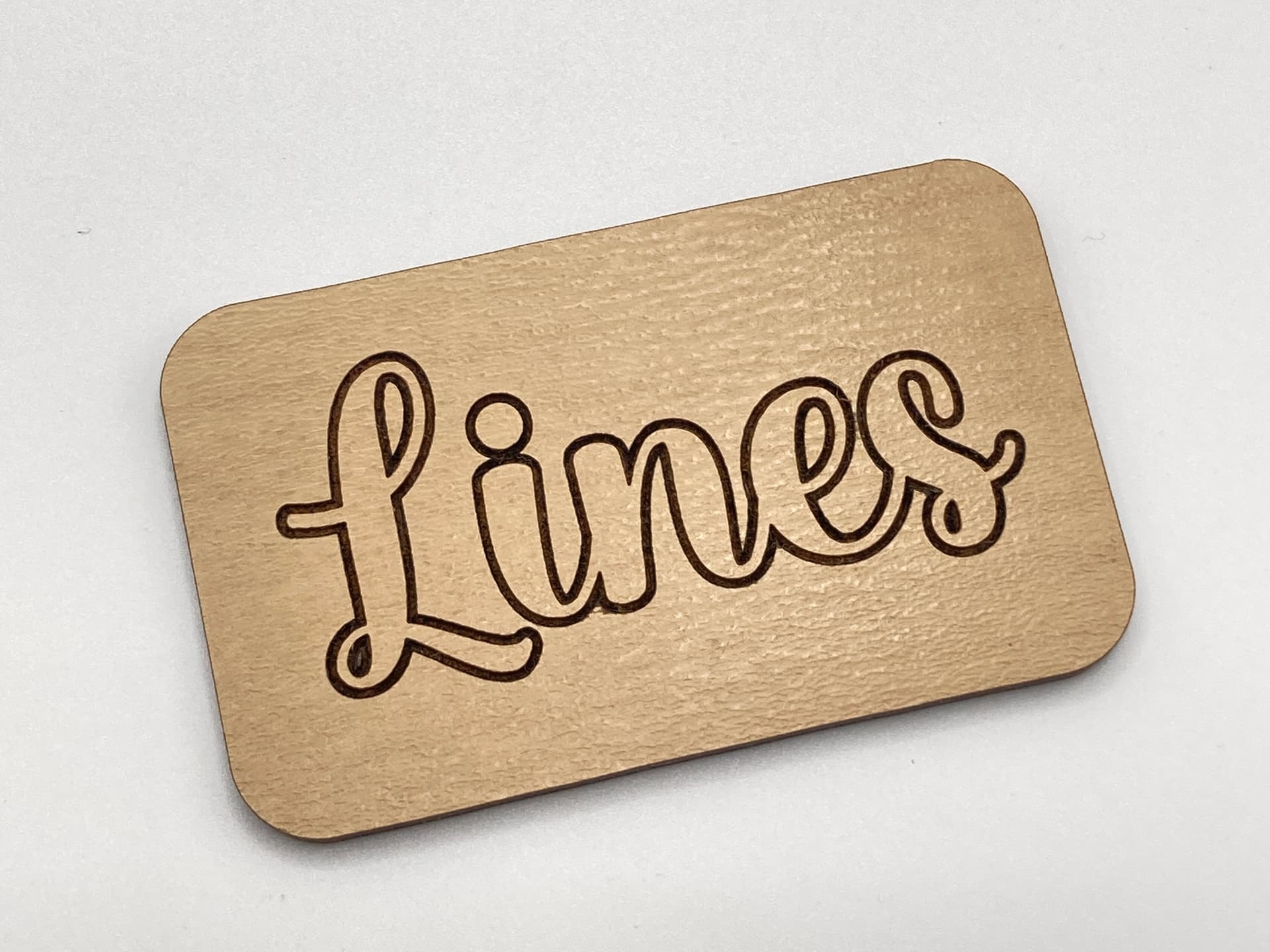

Aah, from the close up of the “LINES” pic I could not tell. Nice technique.
The material I used looks like it got overheated in the tight spots.
I think you guys are on to something here. This is way better than the current engrave, in my opinion!

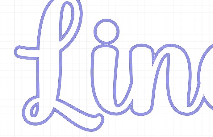

Yeah in the other thread I talked about some of the trade offs:
It may be an lpi/settings issue to an extent but there’s definitely more to it with corners and tight bends. Some hot spots happen, line density and thermodynamics combine for some complicated effects.
I think hot spot are already prone in tight bends when scoring. Just stacking them exacerbates the issue.
Yes. Clean corners is a good algorithm but not perfect.

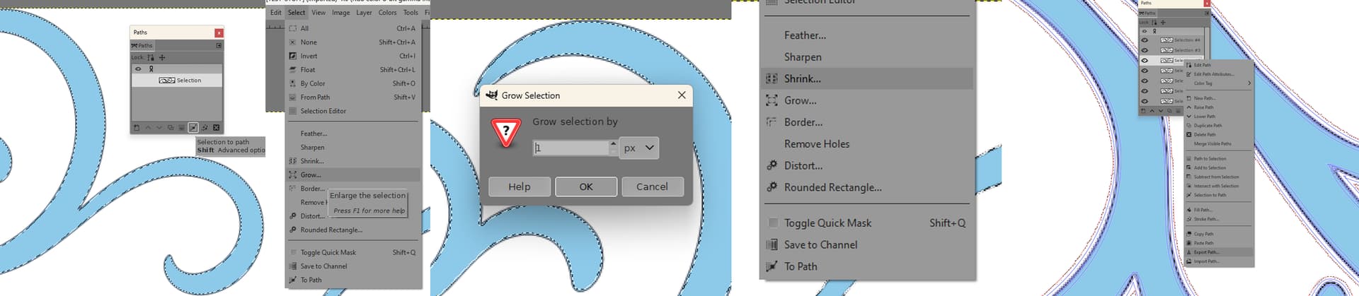

Yes I understood your process, I just didn’t know the point you were trying to make.
Your process and this extension are pretty much apples and oranges. Or at least an pile of apples versus a nice well packed crate o’ apples.
This is about automating the grunt work and math and having some control over the spacing. Your method is akin to the problem I was trying to solve: it was a bunch of repetitive annoying steps.
If you have a way to automate that that isn’t some sort of keyboard macro that you hit 15 times I’d be curious to see it. Also you’re doing 1px offset, that’s about a 100 lpi spacing. Just fyi if you never did the math.
It was a lot more work making the images than just doing it. I would not be doing it for a polished result. The spacing however would be dependent on the scale of the image. At 6000x2000 the lines would be a lot closer and then you could scale it back to 1000x400.
If I learned the R1 better I could just ask and it could do 50 at a word.
A px is a px, so the lines would be the same spacing. Once they’re paths you could scale them — even in the Glowforge ui — and change their effective lpi regardless of which app is making them.
The benefit of the extension is that you can set your stroke width to be exactly what you want the final product to be, and dictate the LPI that you want. Again, it’s a nicely packed crate of apples — no math, no rescaling, precise, and one easy step.
