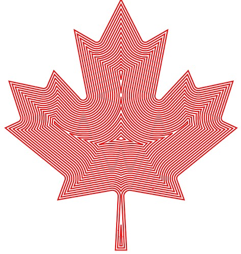

By combining @evansd2’s two Inkscape plugins,
  1. Concentric engraving inkscape plugin, followed by
  2. Improved cut path Inkscape plugin
you can get a space-filling curve effect for a more interesting engraving pattern.

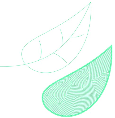

You can also add segments inside the shape to modify the output:
Note, you will need Inkscape version 1.4.

Hilariously enough I was about to do this very thing.
Two notes from early tests:
Be careful of closed paths in the center, it’s easy to overburn in early testing.
Did you tackle the problem of paths with internal exclusions, aka islands?
I’m planning on making a single plugin that does this in a single operation but the island issue is tricky from a performance standpoint.

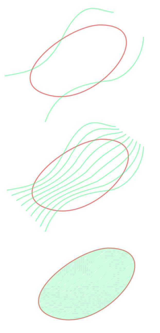

I wonder if you could get a smoother transition by assuming that the two curves are following a vector field, and extrapolating the rest of the vector field by diffusion or relaxation. Of course, the hard part is handling the divergence of the resulting parallel curves. This just diffuses the problem, it doesn’t solve it.

Using vectors is how Inset and outset work and they lead to inaccuracy.
You can see this for yourself by using the inset outset halo function. It does roughly what it sounds like but it struggles on complex shapes since it uses vector expansion.
In fairness so does stroke to path; it’s sometimes not perfect either but I find it far more consistent as long as your path is well constructed.

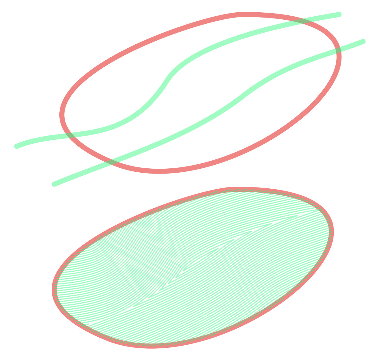

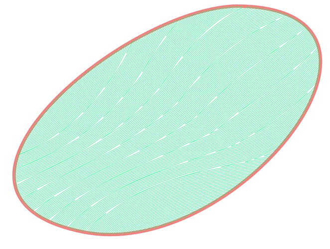

You can sort of do it by starting with the built-in ‘interpolate between paths’ path effect:
