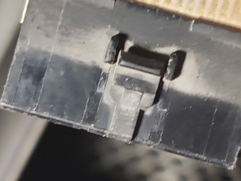

I think the air assists in my machine are having issues despite being cleaned.
Let me repeat that for the people who will comment assuming I didn’t clean my fans or lens.
I cleaned all 3 air assist fans, lens, mirror, etc before I started my 1 hr job
All of my pieces engraved perfectly. Half of them cut just fine, the other half didn’t cut at all.
Another issue I noticed, while cutting or attempting to cut, my machine is having to cooldown after just cutting 3 or 4 pieces that are only 2.6" in size. The ambient temp is 65 degrees. Normally at this temp or sometimes even warmer, I can cut several pieces without a cooldown. I only see a cooldown period when the temps rise to above 80 degrees.
Since I had just cleaned all my fans, lens, mirror, etc, what else could be causing these issues?

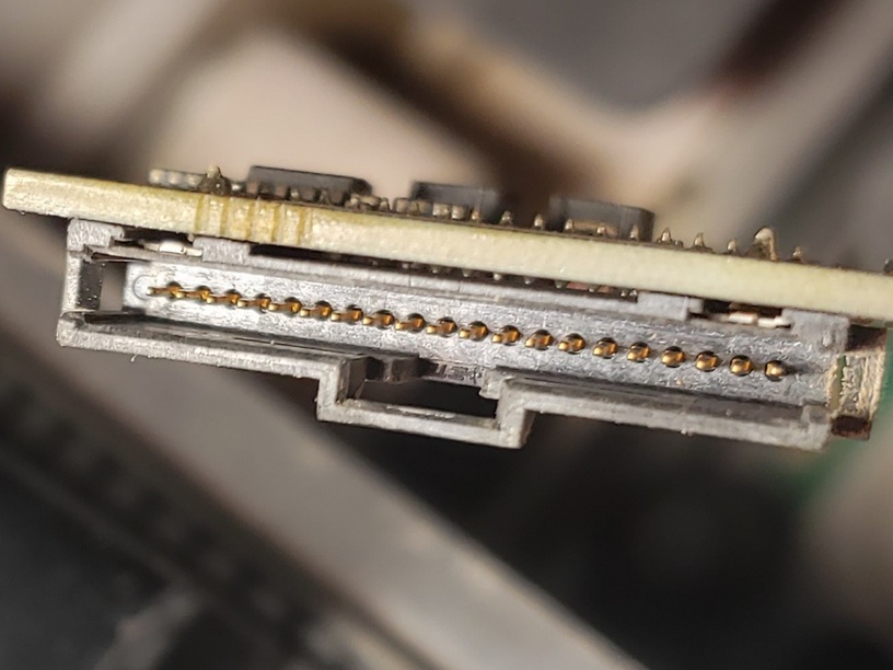

Also, one more thing since I’m on here… the cable that connects to my laser head is occasionally unclipping while running long jobs. I have blown it out with air and I always check to make sure it’s connected properly, but it will still come undone at times.
Could a bad connection with the cable also be the problem behind all of the other issues at the moment?
Glowforge has a sensor that measures fan speed and another that measures temperature, both running through that white cable. Even an intermittent or high resistance point through that connection would give the results you are seeing, and might even create a real fan speed problem.
If that can happen it is not connecting properly. I would look carefully and post close-up photos to see if the clips that are supposed to hold it in place are not worn or otherwise not working properly. I almost never unclip mine for that reason as it lowers the chance of such a problem. Though I do have to be more careful cleaning lenses,
I started to unclip mine to clean it because my magnetic lens remover broke. Each one I have ordered from GF has arrived broken as well, so it’s easier to clean it by taking the head off.
Please I cut mainly acrylic and have to clean the fan below the carriage quite often, which means removing the laser head.
